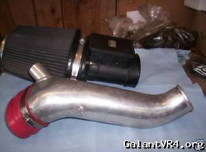

Edit:You'lll have to make or buy a 2g style intake pipe.
Yes, you will need to remove the aircan and install a 2G/3000GT air filter assembly. Or, Dejon makes a nice cheap adapter to let you use your 1G K&N filter.

Could I add an Evo 2 K&N basically in the same position as stock, or do you think it would be wise to get an intake pipe also?
Would I then need to move the battery, or will the intake pipe just move the filter closer to the front of the car?
