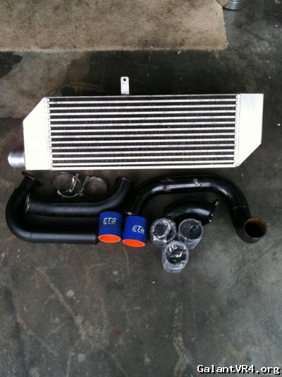

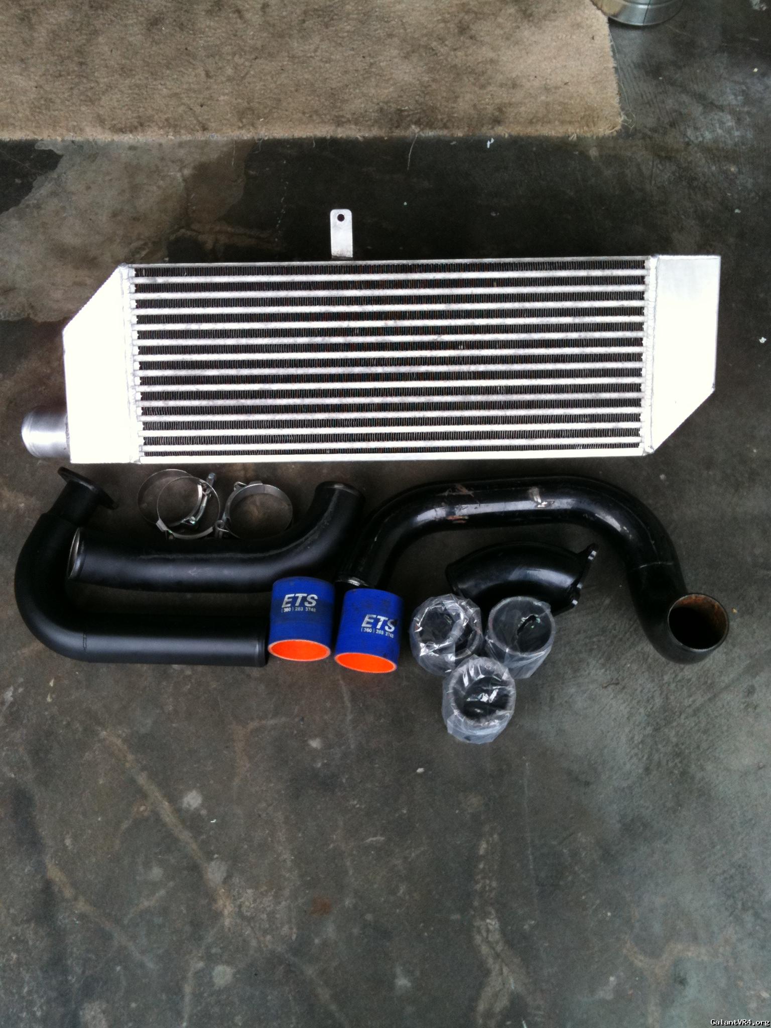

just thought id share.... well i got a deal from a local guy that upgraded his FMIC kit.... he sold me his ETS kit for 325 /ubbthreads/images/graemlins/smile.gif with everything i need to bolt it up.... claps couplers and also with an hks ssqv bov....
the upper pipe is not in the pic but here is wat i got /ubbthreads/images/graemlins/smile.gif

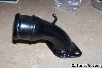

got a question about the ets kit j pipe it doesnt have the little nipple for the vaccum line boost source.... for those that have the ets kit how did you guys connect the line to keep the turbo from over boosting?
Tre3zy
Nov 25, 2008
602
South San Francisco, CA

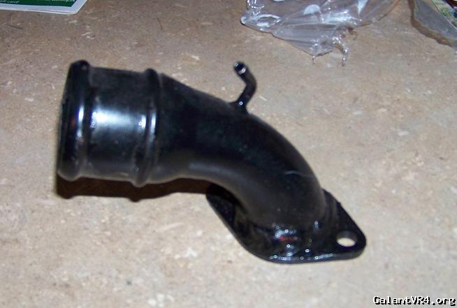

to make it more clear.... this one see how it has that little nipple for a vaccum hose? isnt that the one going to the boost controller? the j pipe that the ets kit did not have this....

On the nipple I just drilled and tapped the pipe for either 1/8 or 1/16 npt and screwed the fitting in with some thread sealant. Your other option is to pull the compressor housing off the turbo and tap that for a fitting.
BluFalcon
Jan 20, 2002
1,312
Wichita, KS
On my first ETS kit, I drilled and tapped a hole into the pipe coming off the compressor outlet of the turbo. There was enough material for the fitting to grab and tighten down with. Used a bit of JB Weld around the base of the fitting to ensure it wouldn't back out. If the pipe hadn't been powdercoated, I would have had a bung welded in the proper locatiion, then drilled and tapped it.
For the kit currently in my car, I just drilled and tapped the compressor cover for a 1/8 NPT fitting. Seemed like the easiest solution at the time.
