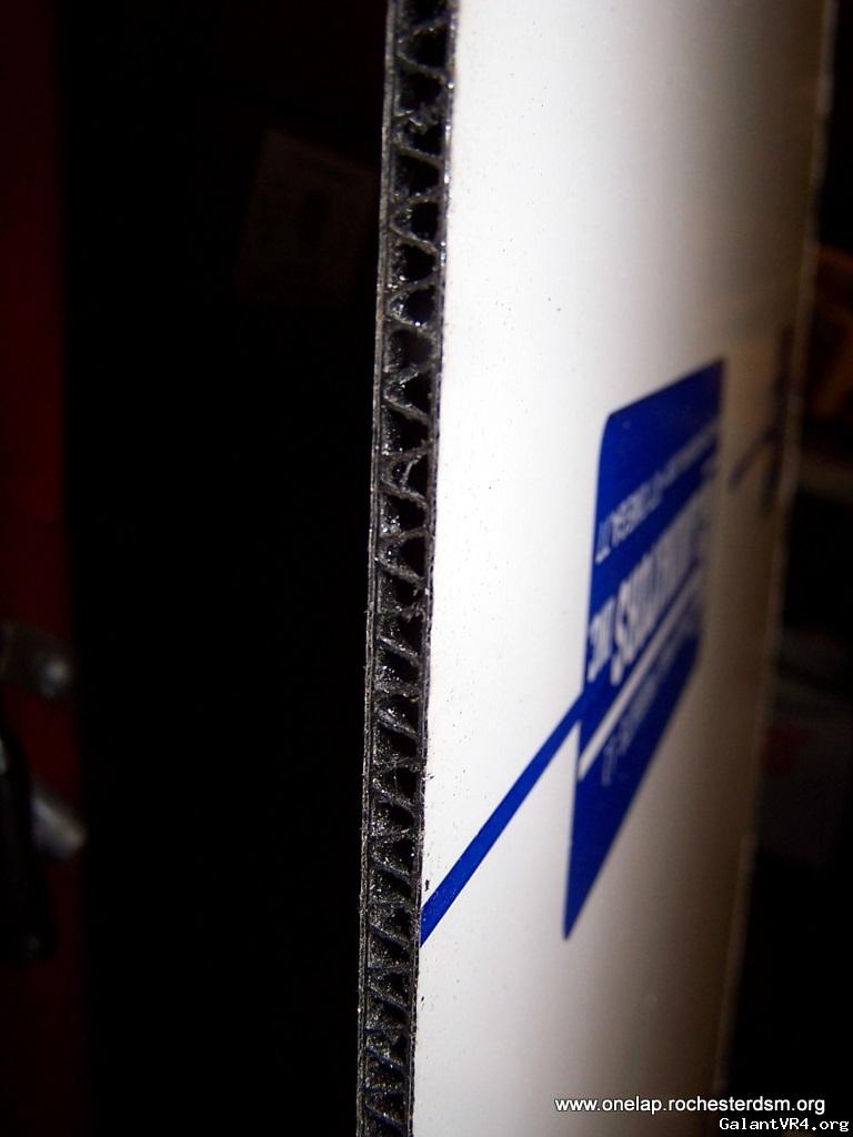

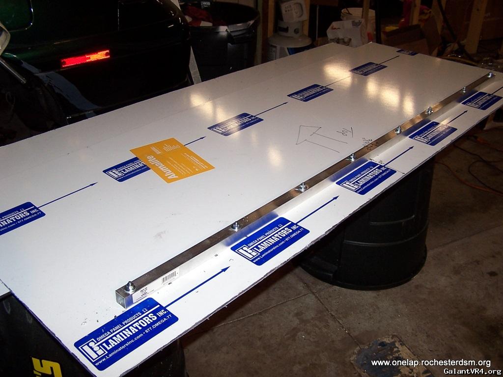

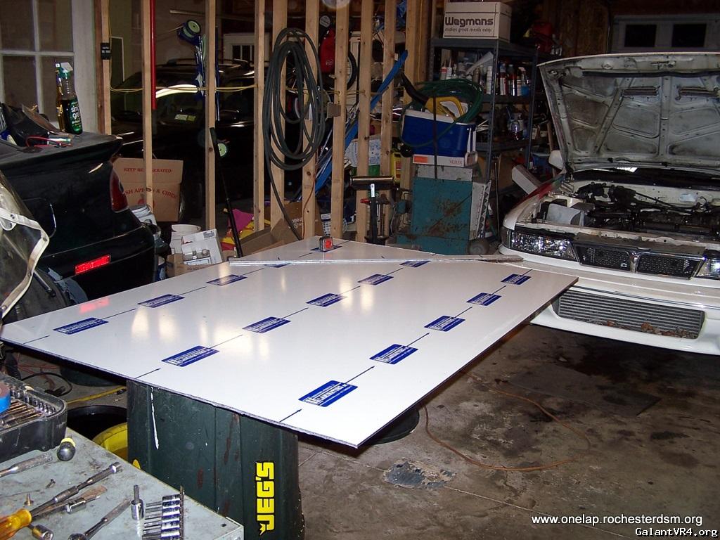

I picked up a full sheet of alumalite this afternoon. It was $90 for a 4' x 8' and they cut 2' feet off so it would fit in my truck. Its only 1/4" thick but man is it strong. With the right bracing this is going to make a tuff and light splitter.

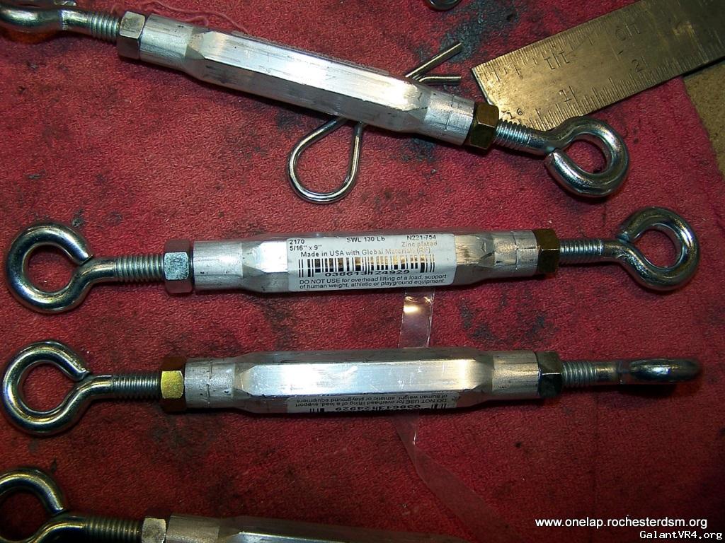

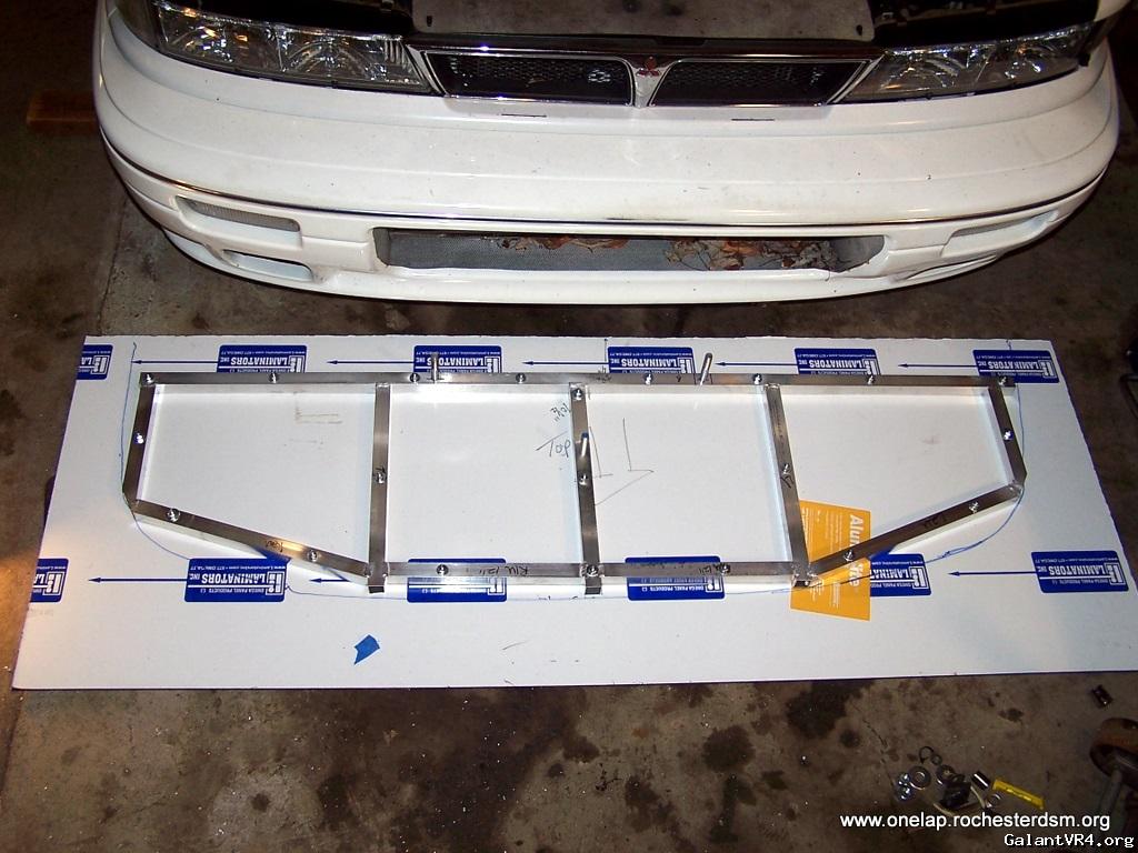

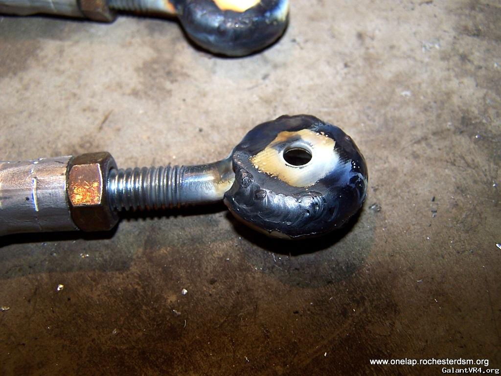

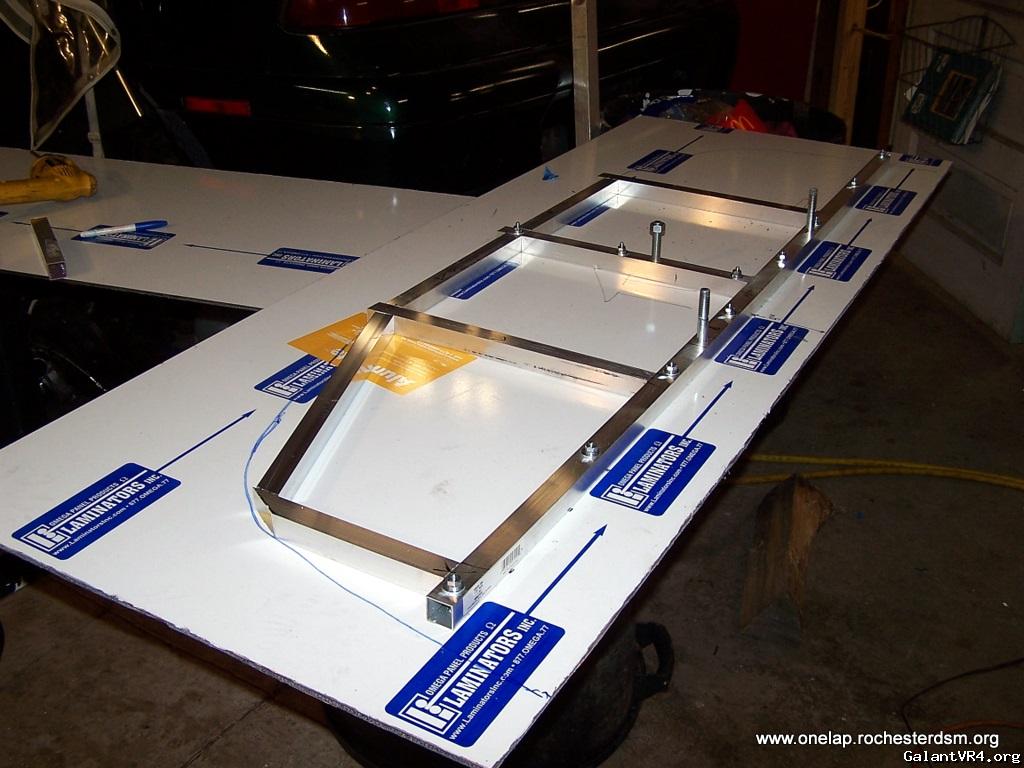

I started the splitter last night. I found some cheap turnbuckles at the local hardware store that look promising. They were less then $3 each. The left hand thread jamb nut was 43 cents on top of that so I hope they work. The plan is to weld a washer on each side of the eye bolt and drill it for clevis pin. I am also going to build a frame for it out of 1" aluminum tubing with 4 little legs through which I will run a 1/2' bolt to screw into a nut that I will weld onto the front cross member and radiator support. Then 4 turnbuckles to hold the front where I want it and to provide some adjustment to the pitch. The splitter is going to be at the same level as the two braces that run under the engine/transmission which will put it a couple of inches lower then the bottom of the fascia. That means I am going to have to come up with some sort of filler strip to cover the gap. I was thinking a cut section of the plastic lawn edging?

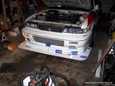

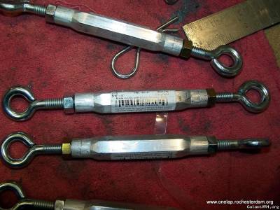

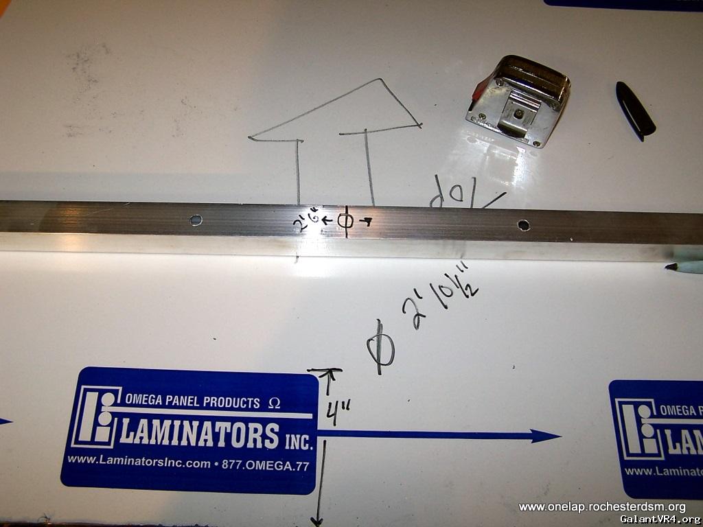

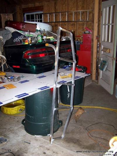

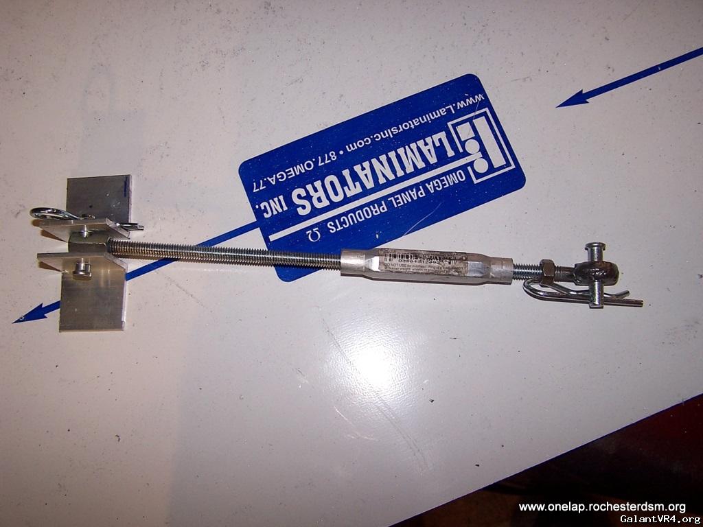

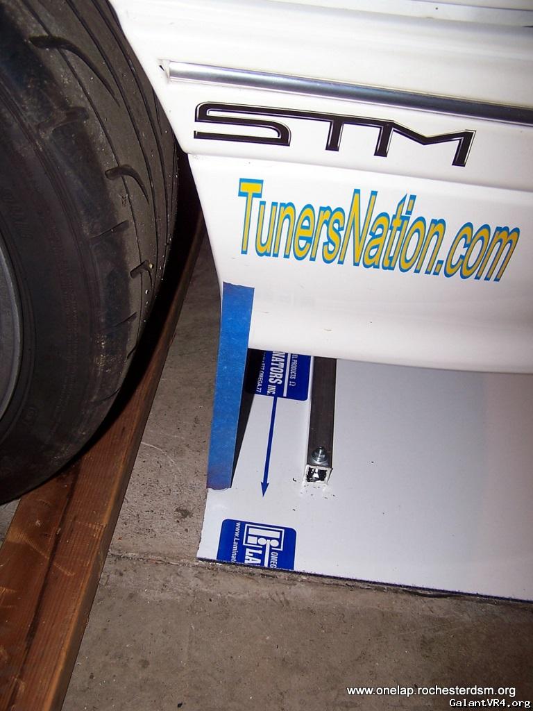

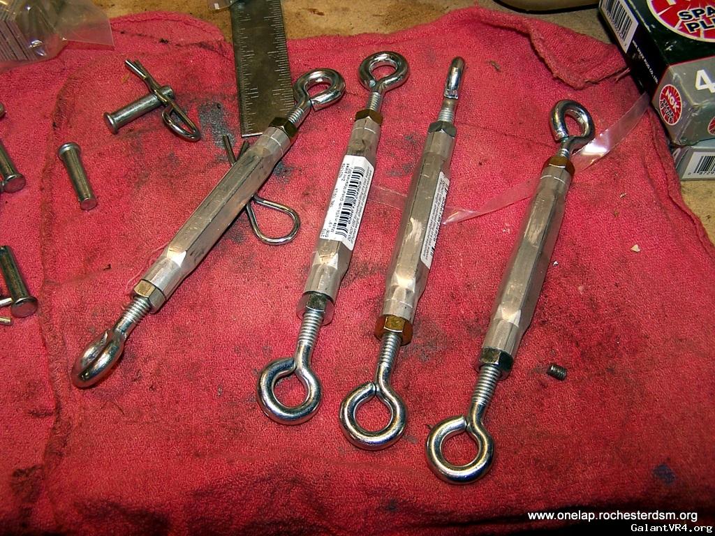

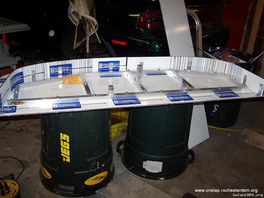

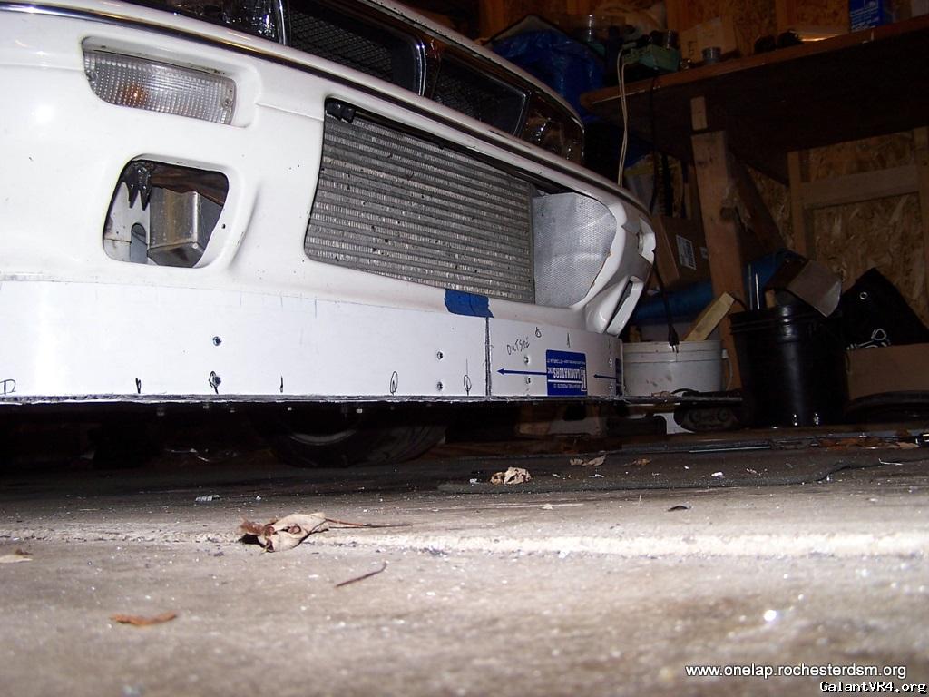

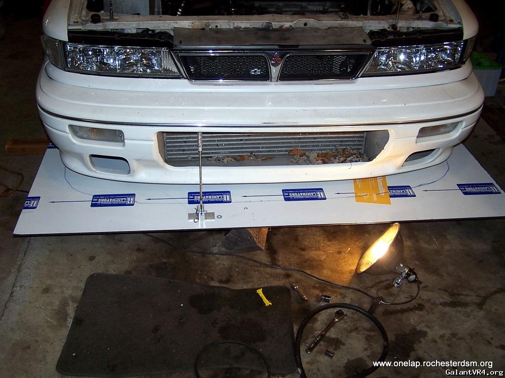

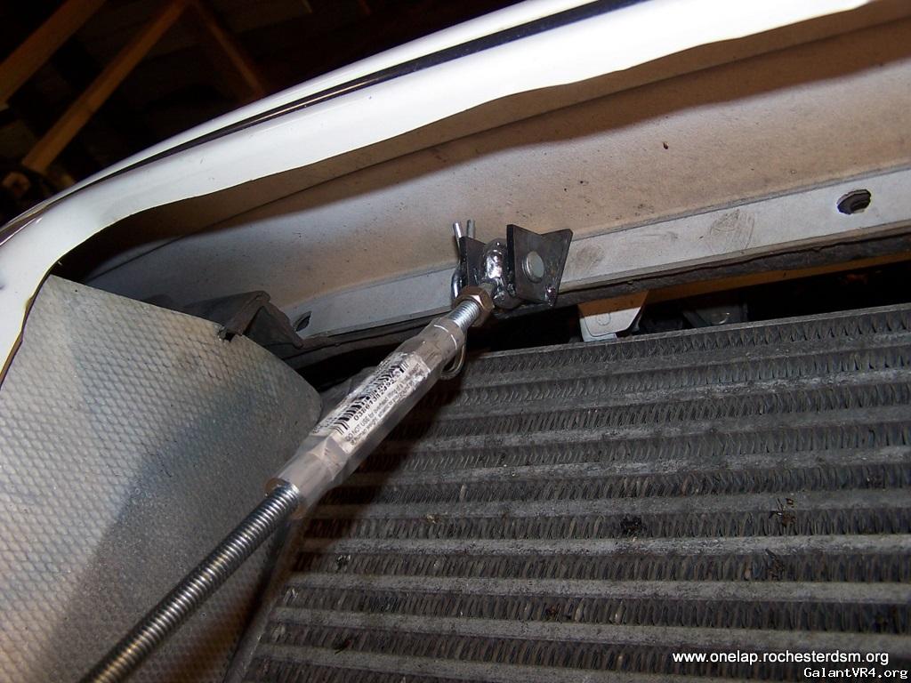

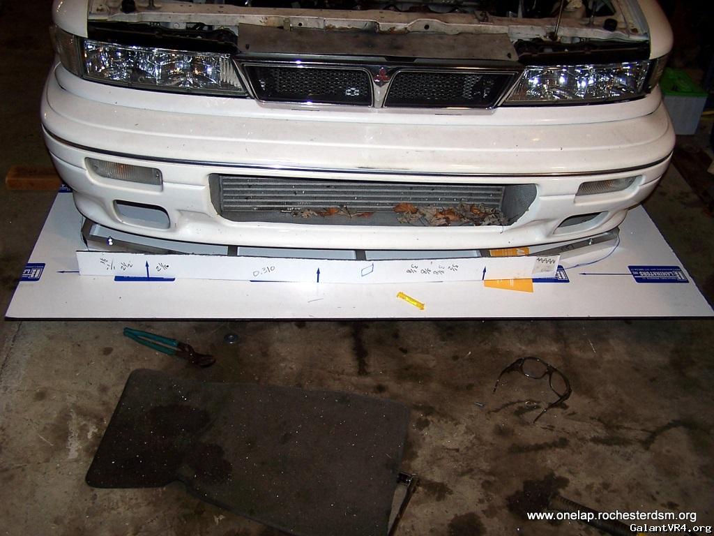

I worked on getting the splitter mocked up a bit so I could get an eye on the ground clearence. My first try was 4" at the lip but that just didn't seem to be enough. Under hard braking I could see this thing torn off on a rumble strip. So I moved it up to about 5.5" which put it just a hint higher then my down pipe. I also worked on the turnbuckles and the mounts which turned out to be kind of a pain. I am still not happy with the mounts but what I have will work. Now I just have to work on making them look less Home Depot.
Tomorrow I will try to finish up the aluminum frame that holds the splitter. Here are some pictures.

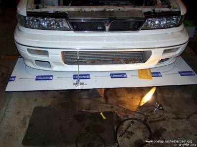

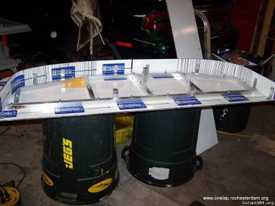

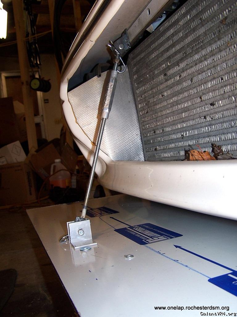

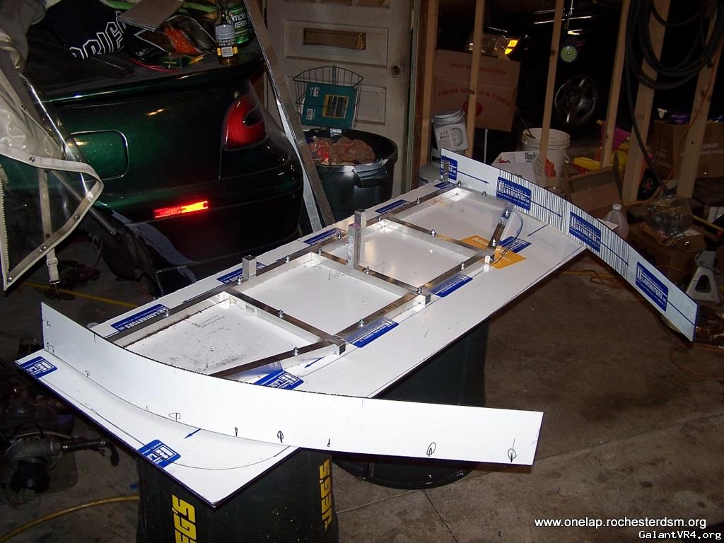

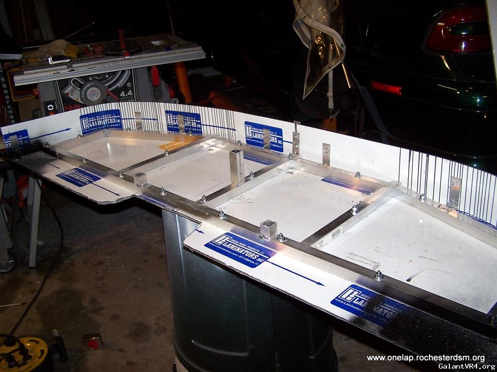

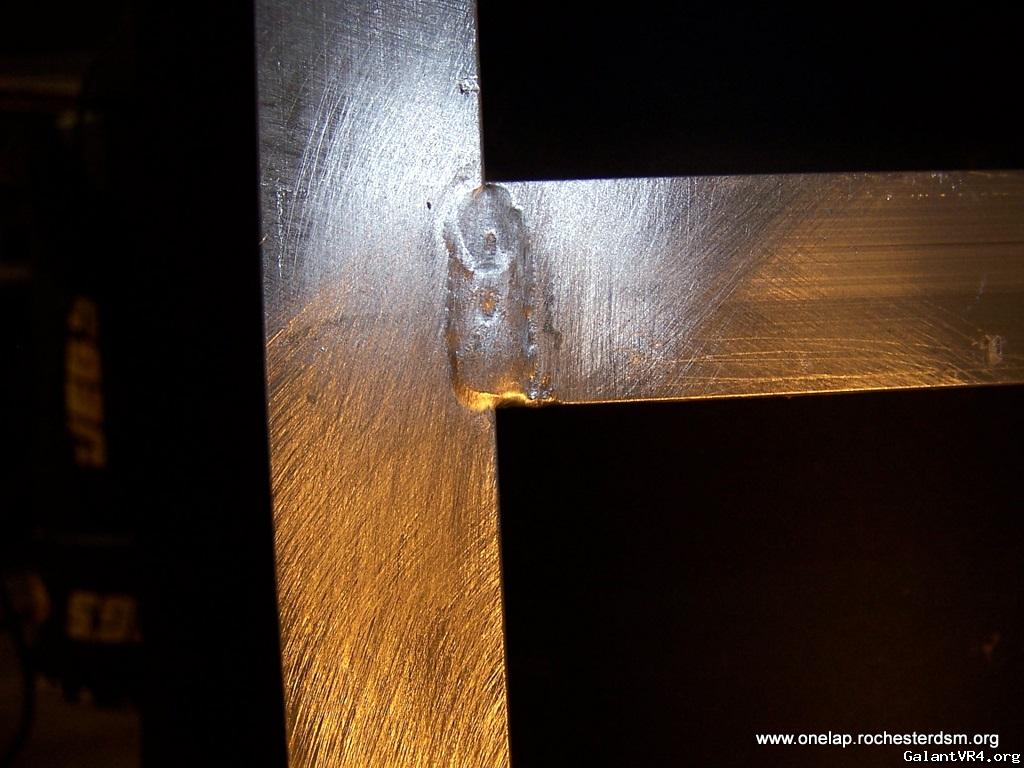

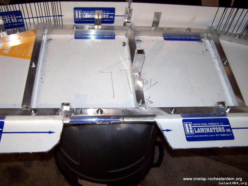

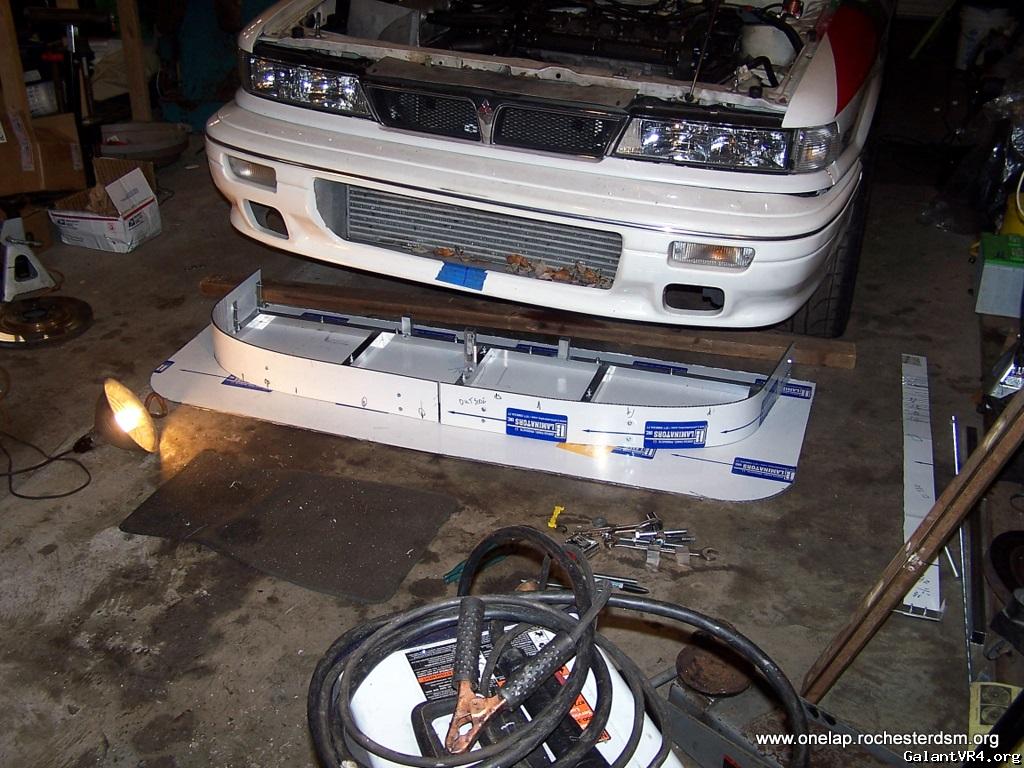

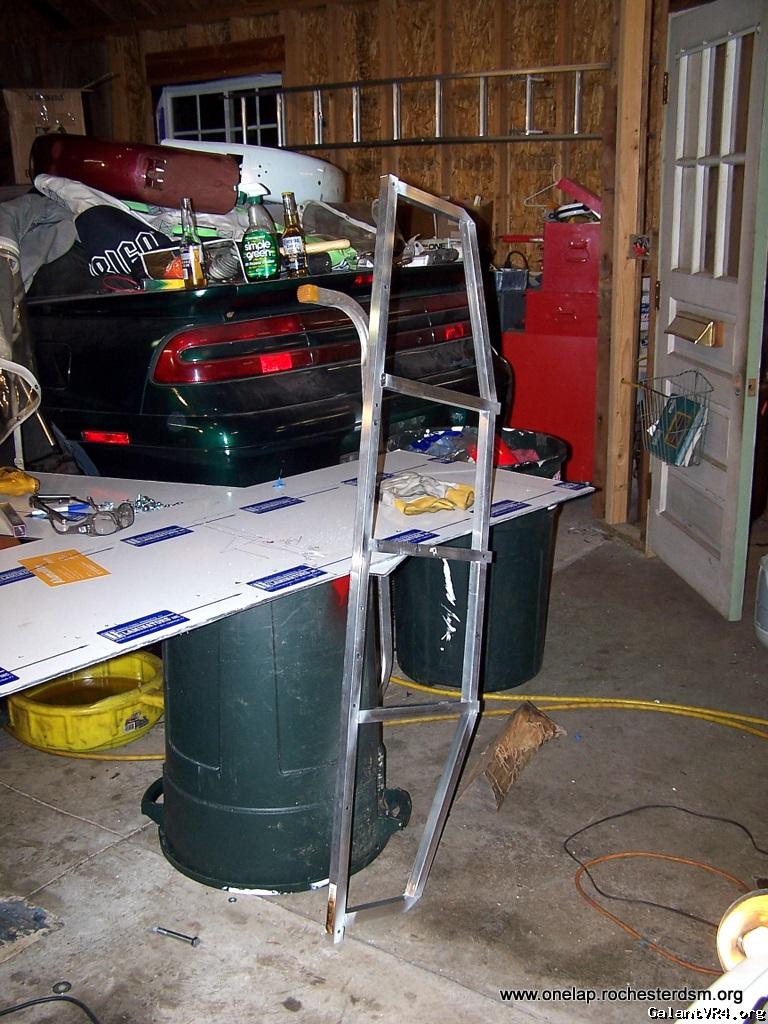

I finished up the frame/skeleton and let me tell you welding that thin ass 1" square aluminum tubing is a pain. I am still trying to figure out what I'm going to use to fill the gap between the splitter and the fascia. I took a look at some lawn edging and it just seemed to flimsy? Maybe they sell thicker stuff?
Anyway, its late here are some more pictures.

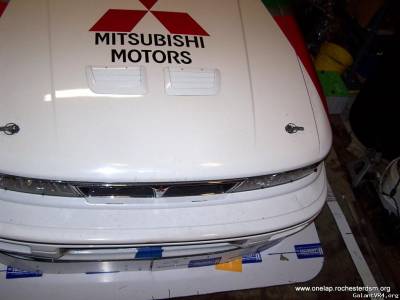

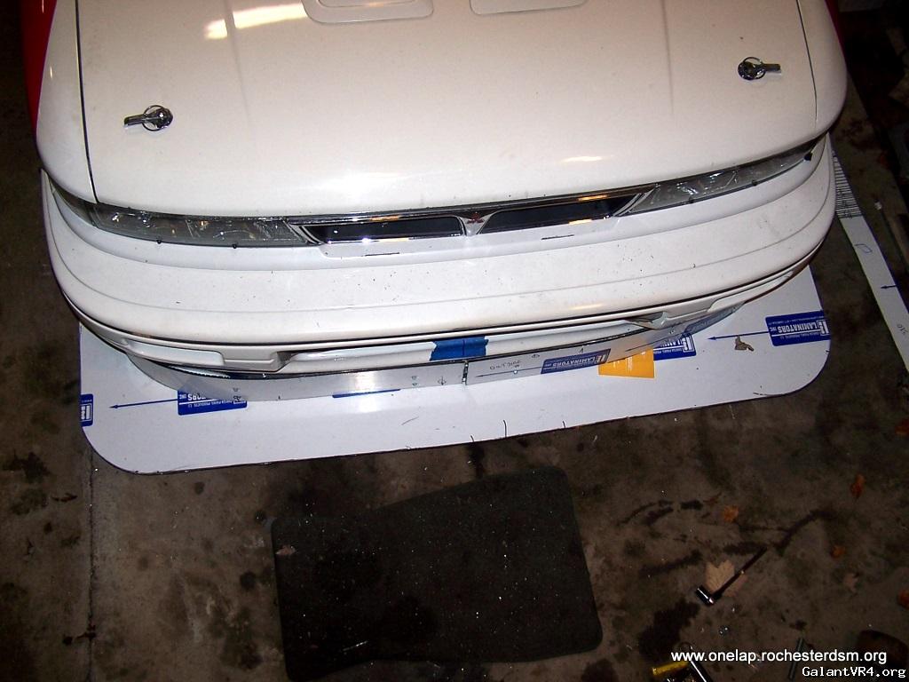

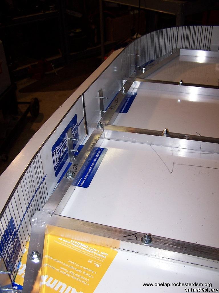

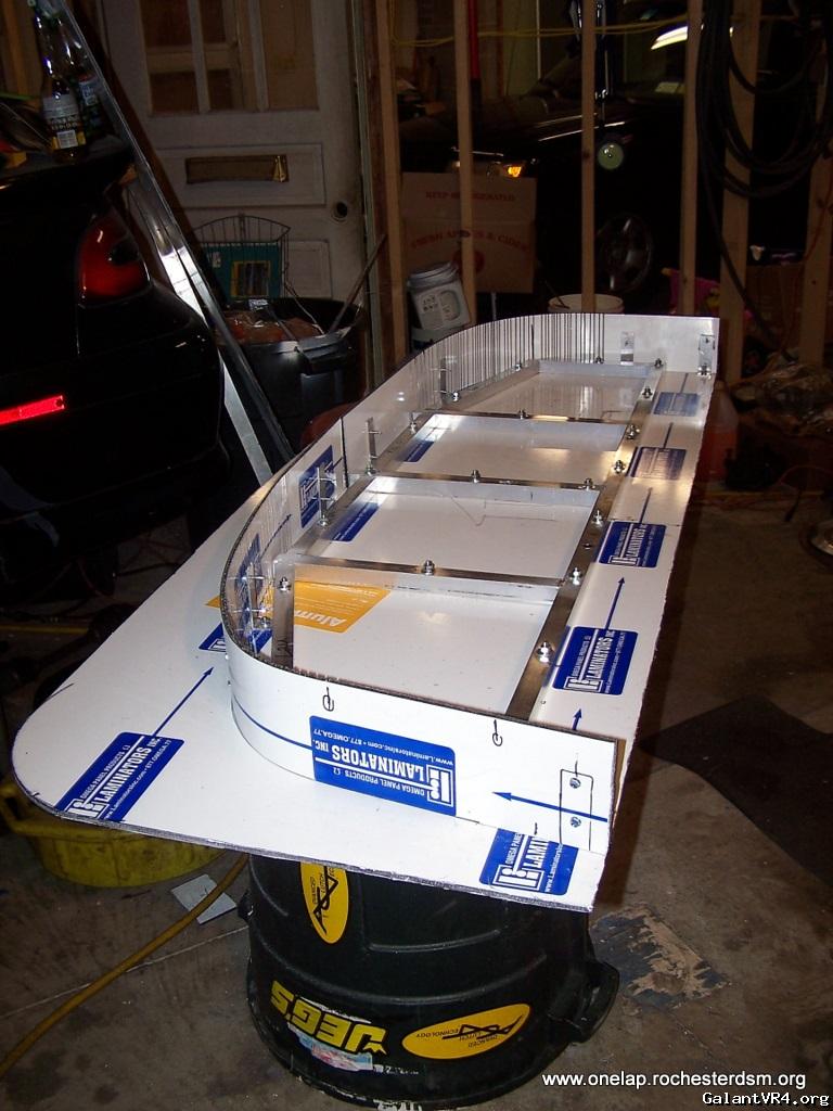

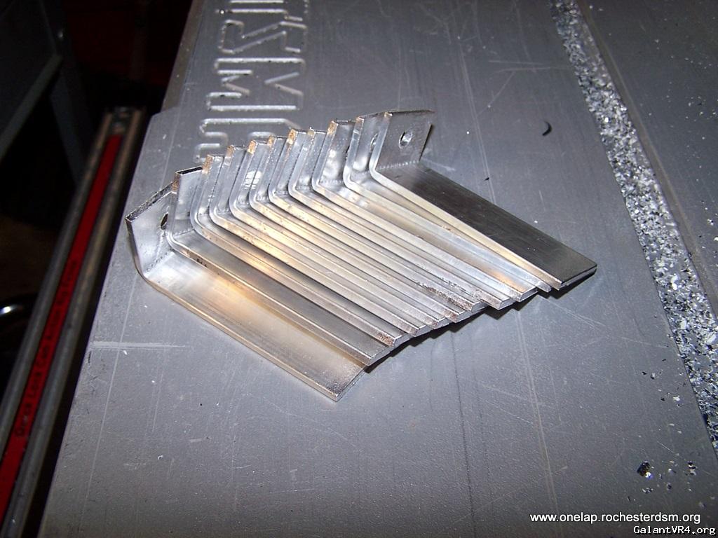

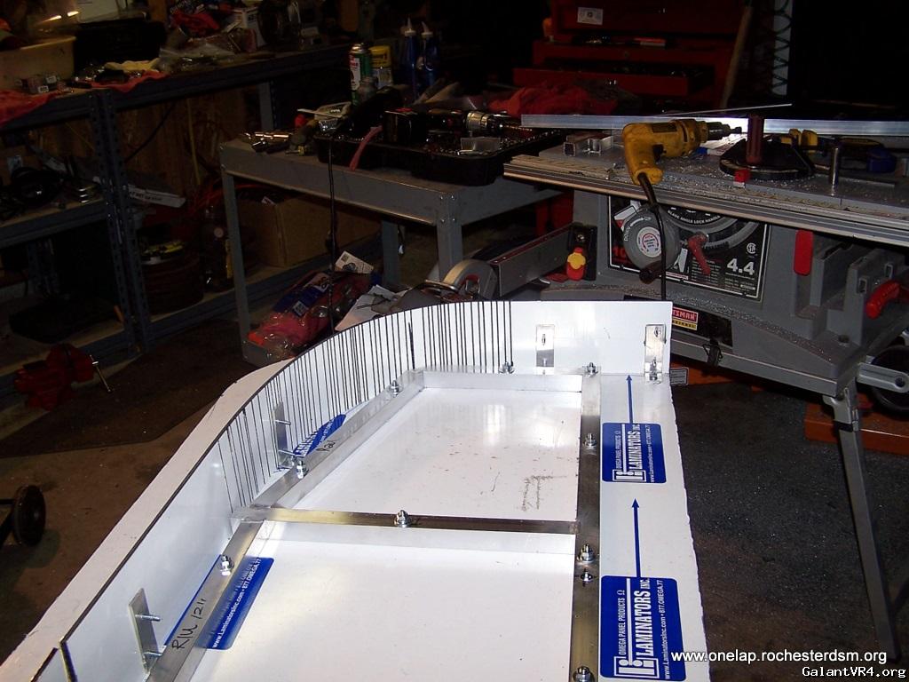

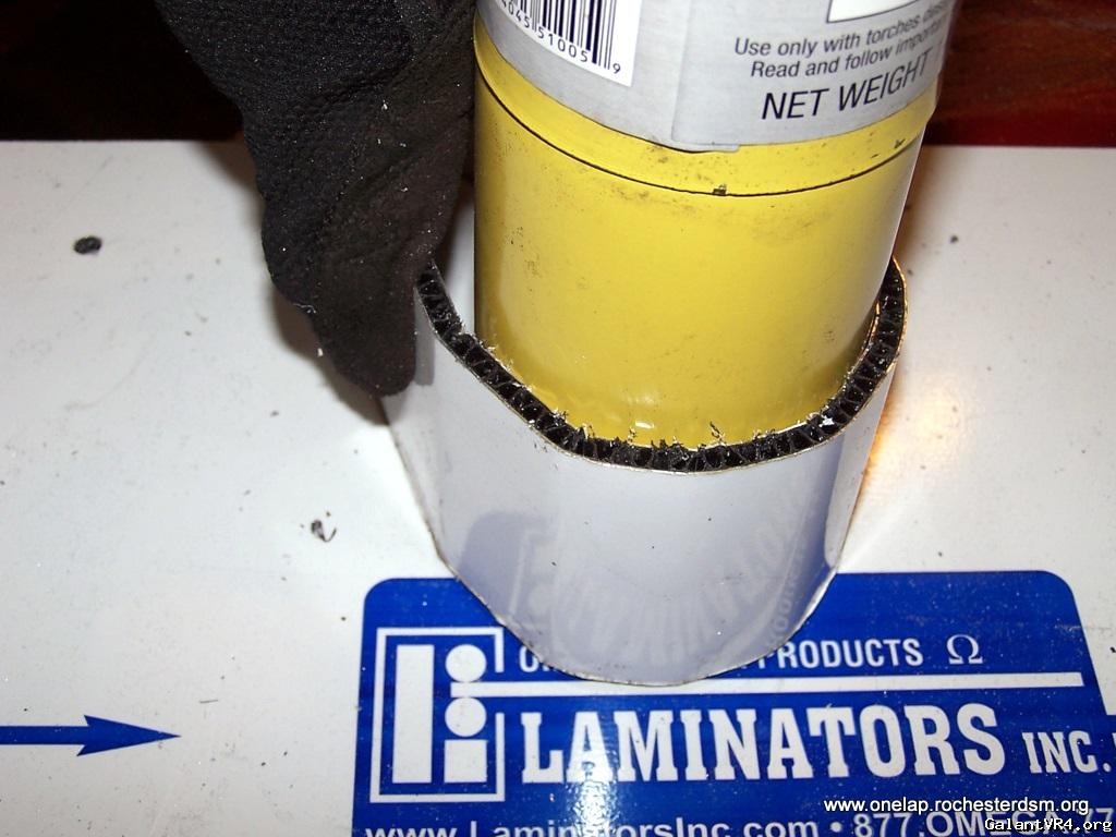

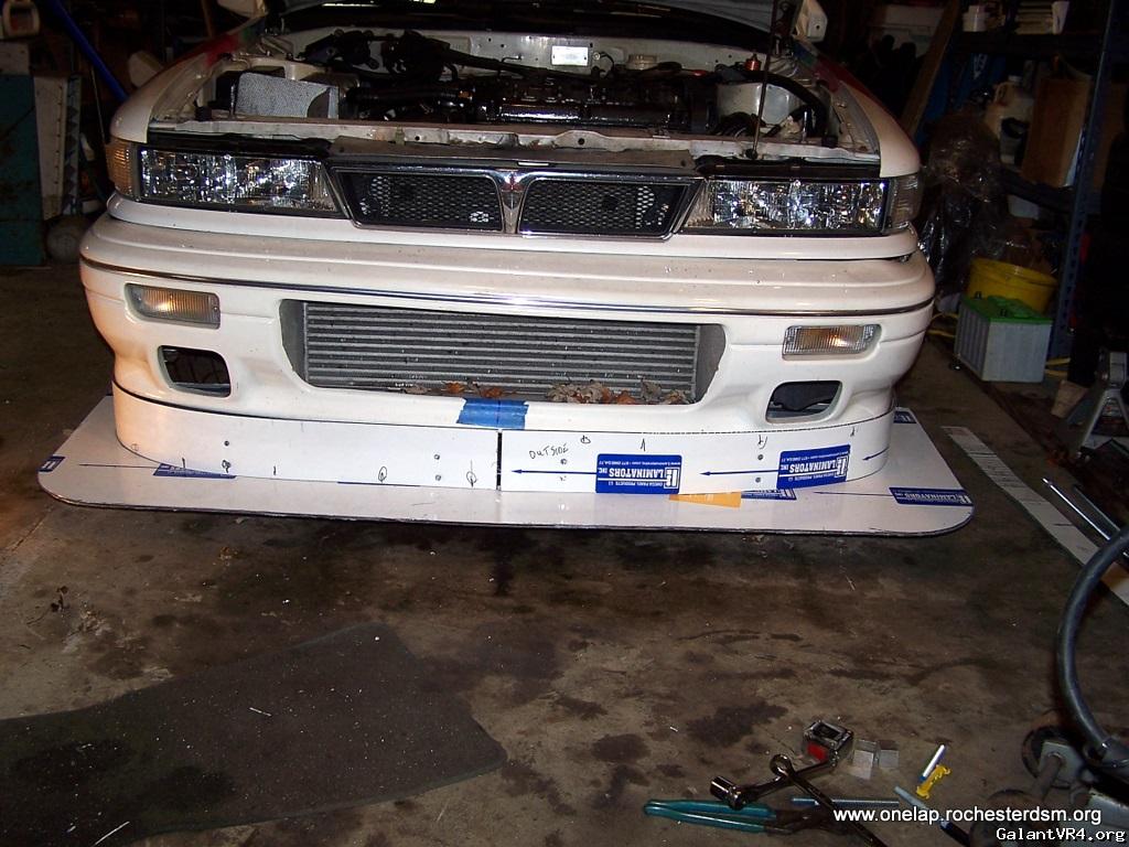

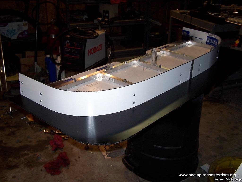

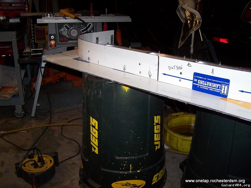

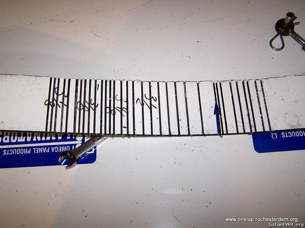

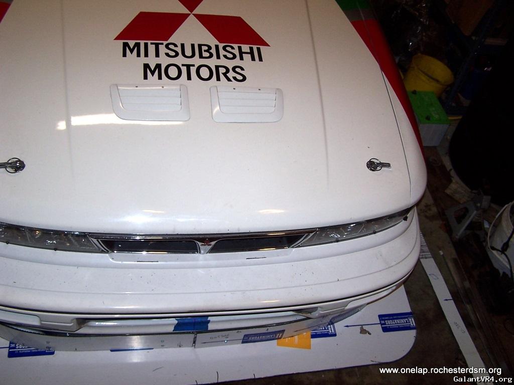

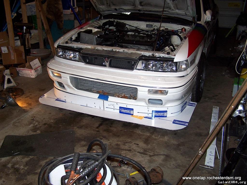

It turns out I had the filler material already in the garage. I just cut down a couple of strips of alumalite and then made relief cuts so it would bend. Worked out pretty well and it should be plenty strong.

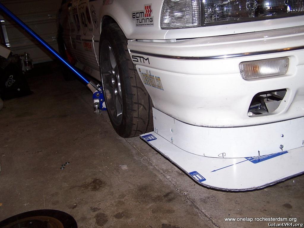

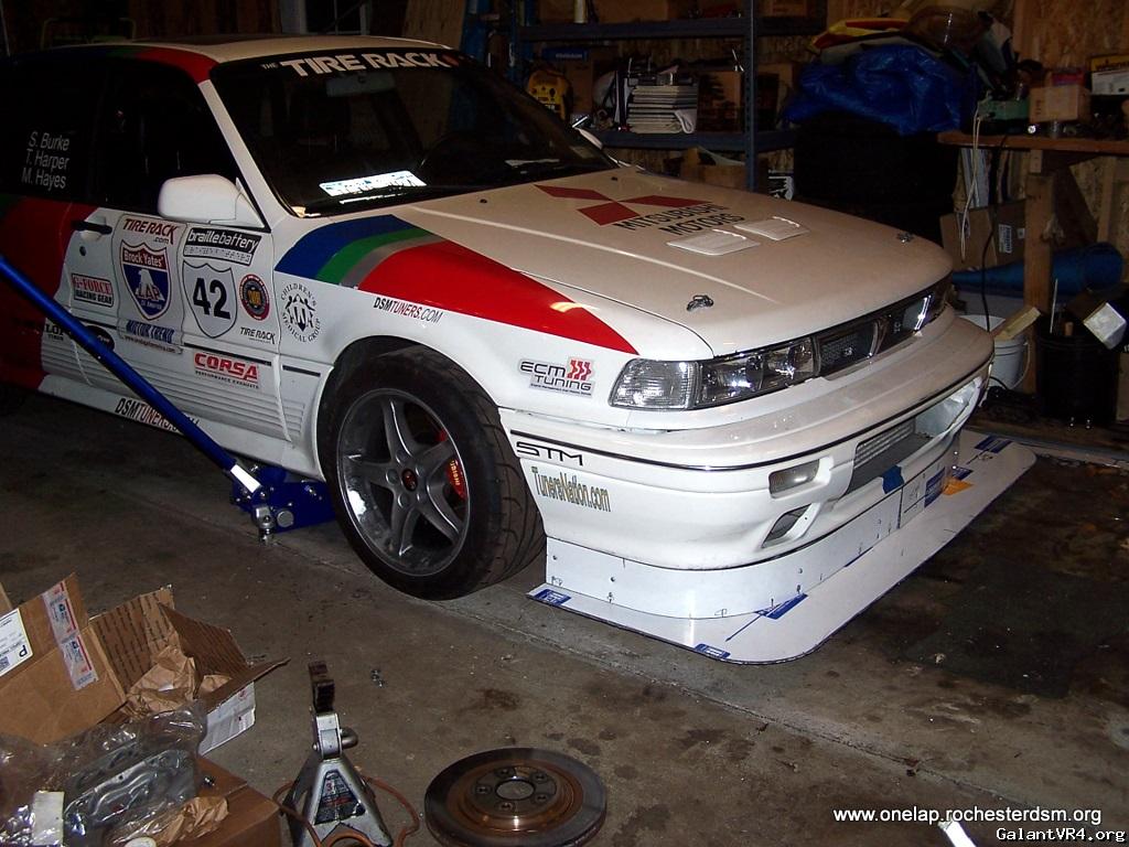

Its late and its been a long day out in the garage. I'm happy with it so far but seeing any sort of aero on a VR-4 going to take some getting used to. I made the splitter big because if I need it to be smaller that's easy. Right now it has 4" of ground clearance and the lip sticks out about 5" from the bottom of the air dam. I am not sure if it's going scrape under really hard braking or a hard turn in over a rumble strip. The height is set by the three 1" towers so if I want to raise the whole splitter up for more ground clearance all I have to do is cut down the towers and adjust the bolt lengths.

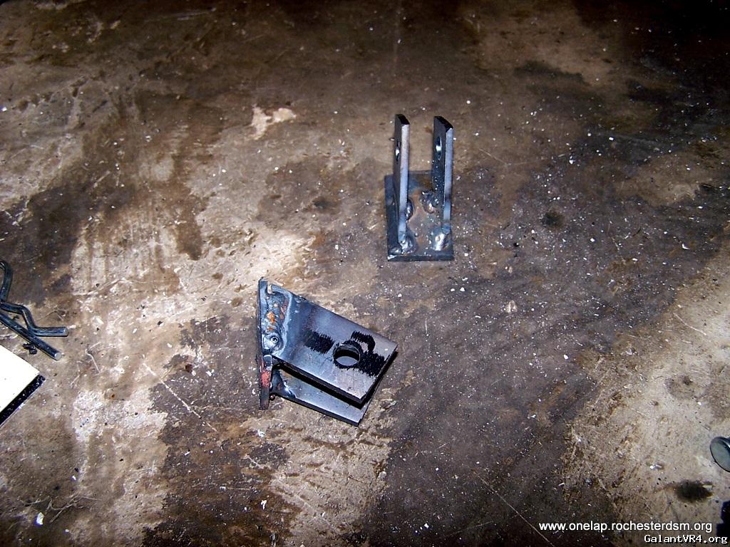

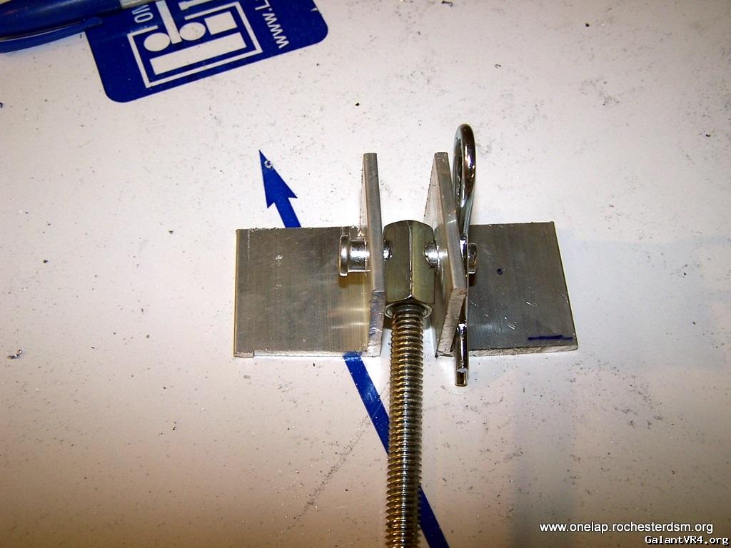

I also decided to just drill a threaded rod union to attach the turnbuckles to the splitter and I welded the upper turnbuckle mounts to the bottom of the bumper brace.

Damn brother you had a long day. Looks really good I didn't realize it was that low from the cover so nix my idea. It's super strong for sure and shouldn't flex at speed. Only thing I see on it I don't like is that its isn't contoured to the same shape as the front cover but I'm sure the design probably needs to be that way for function over looks. Like you said take some getting use, plus with the blue branding stamps everywhere makes it hard to see clearly after some paint will look alot better. So what color matte black or white.

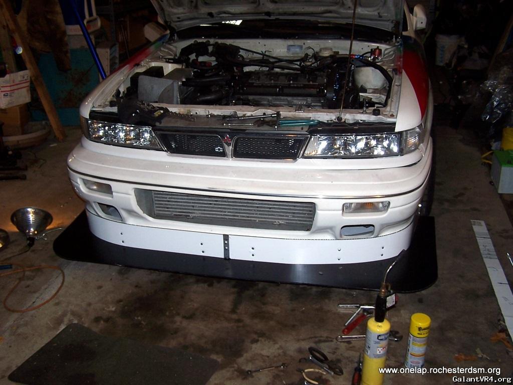

I chickened out and raised the splitter up one inch so now it sits 5" off the ground. I also painted the lip and finished making the turnbuckle mounts. A tree fell a few houses down and took out the power to the street just as I about to drill the holes for the mounts. So its not done but it should be today. Here are some pictures.
