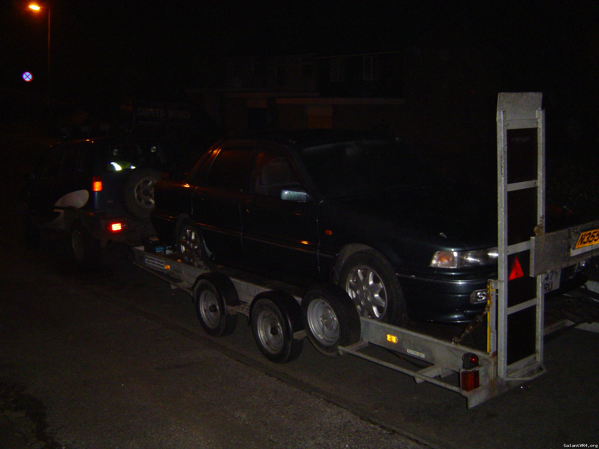

Yup. its an immobile galant on a trailer!

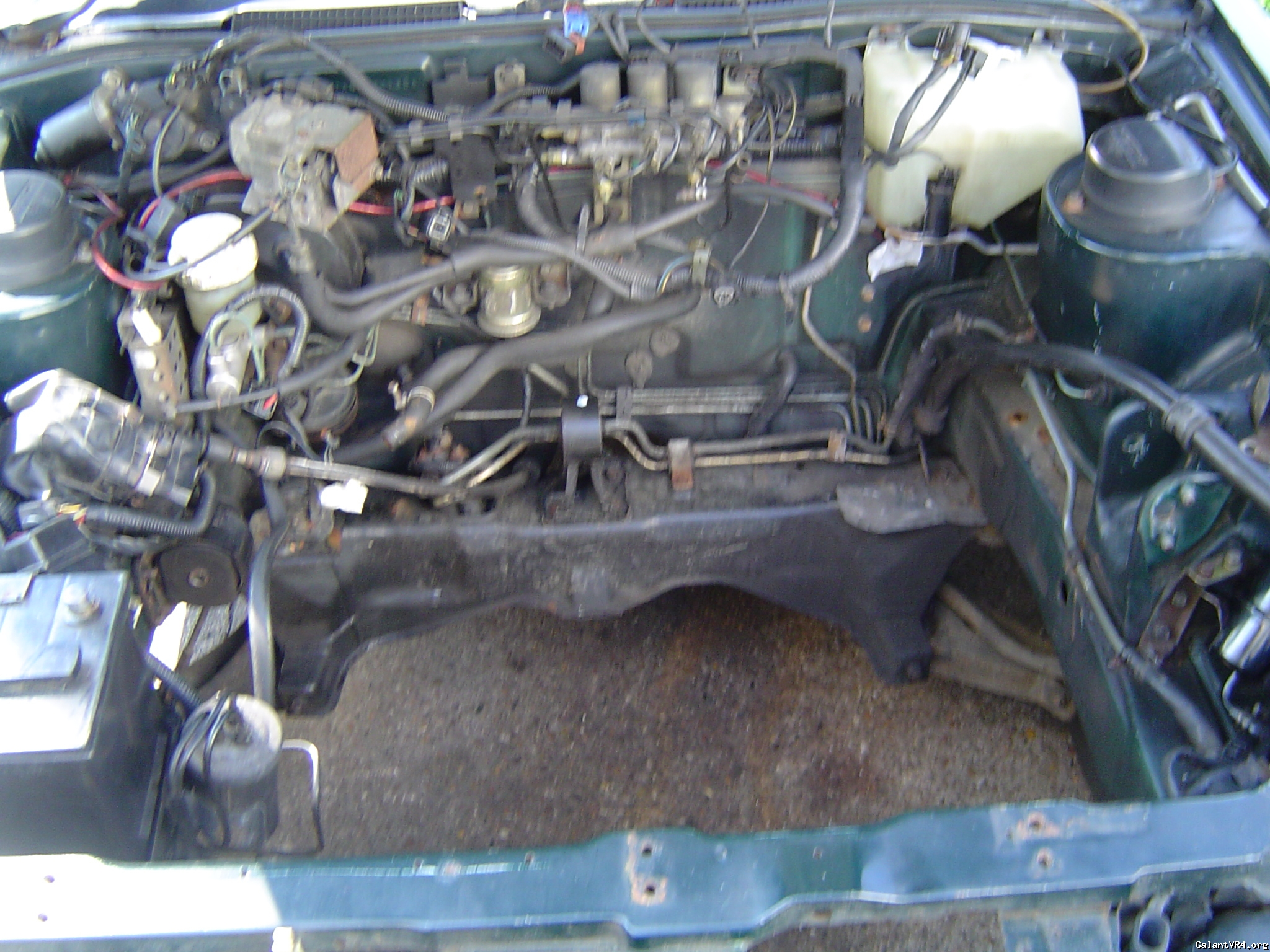

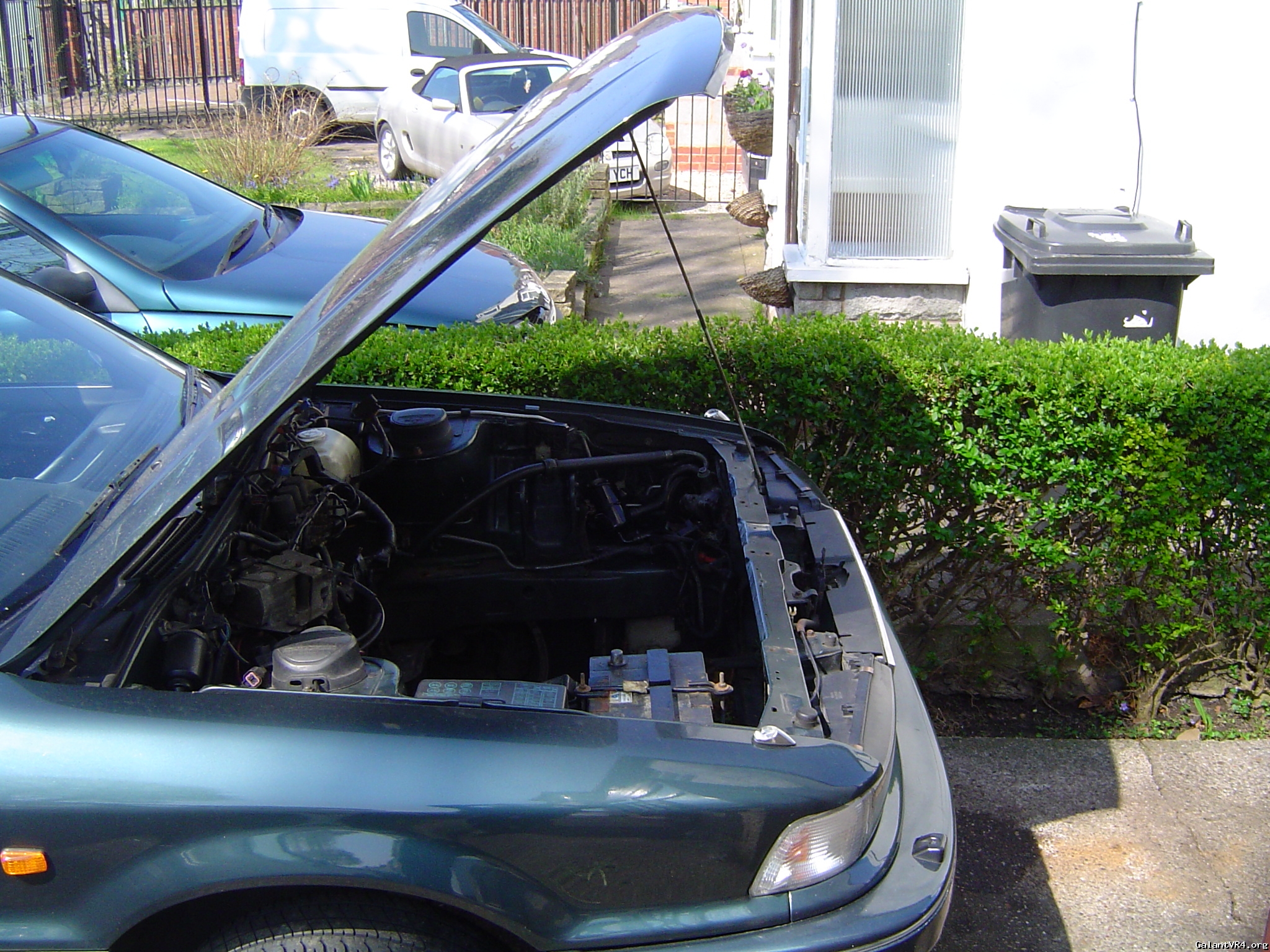

Gutted the front half of the engine bay 9rad and anciliaries. Got the car on axle stands pulled the shields, pipe and shafts, then unbolted the engine&trans while hanging off the crane, brought it forward 3" then dropped it on a crawler (much easier to move about!). Used huge floor jack and lifted the car by the front subframe about 3' in the air and rolled the engine and trans out the front. The pictures were taken lunchtime before i put the motor back.

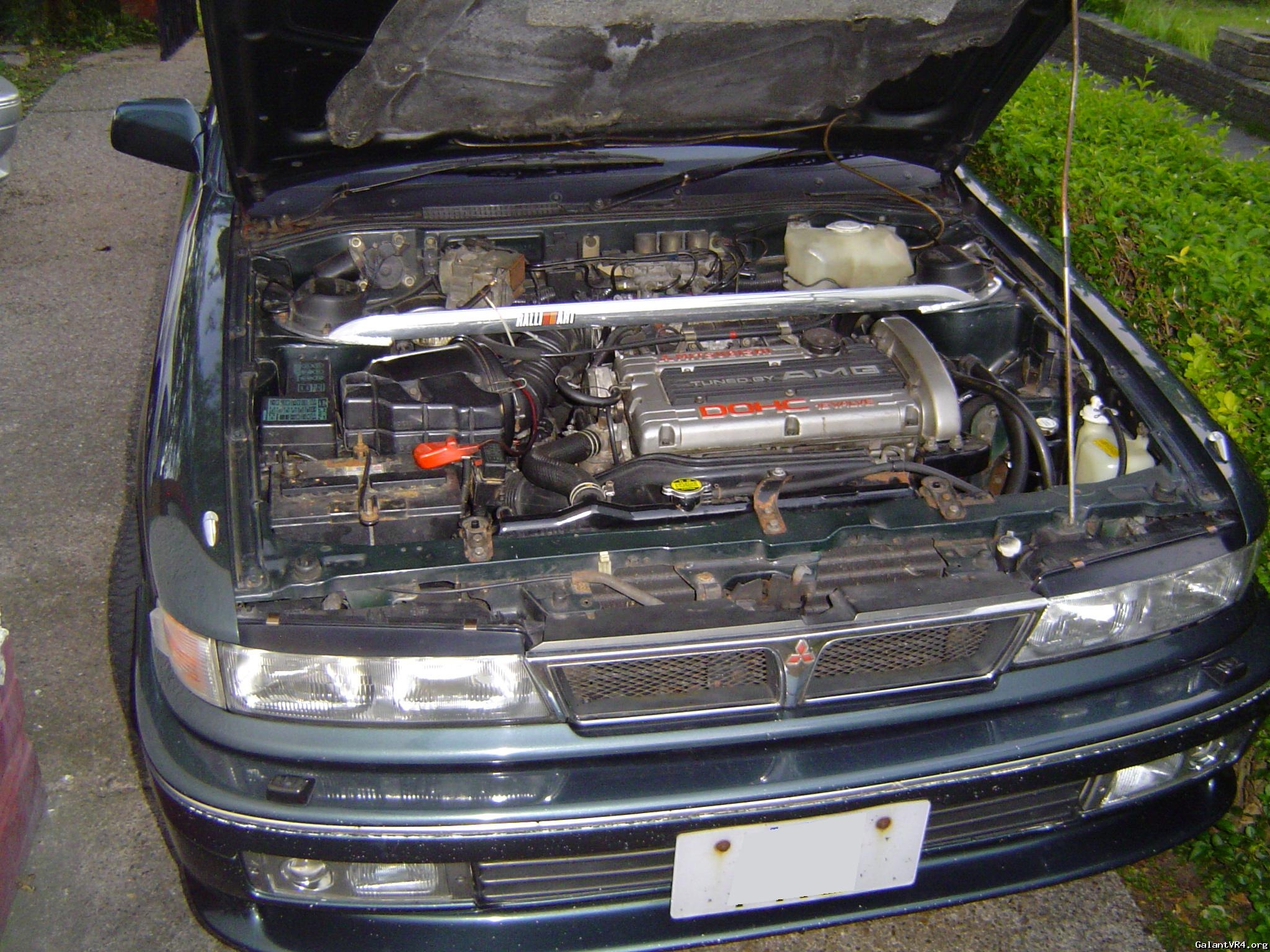

when it was all back together it prompted me to get off my ass and fit my towerbar, nice and tight at the front now, and the new motor is a peach.
Best bit is all with the bonnet still on! /ubbthreads/images/graemlins/grin.gif
