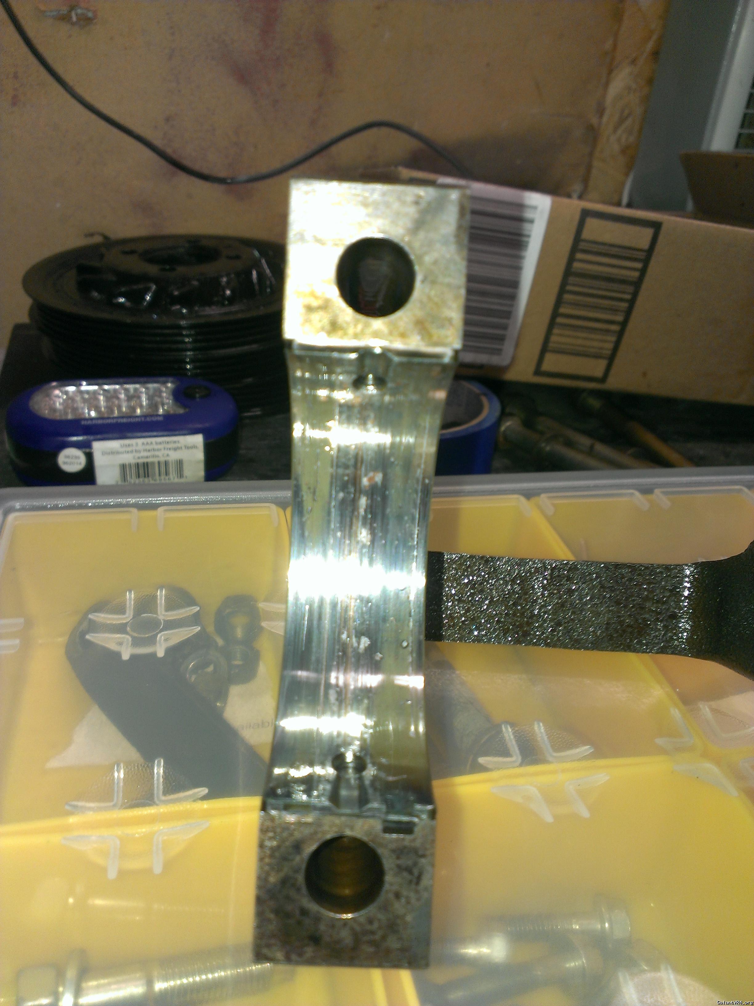

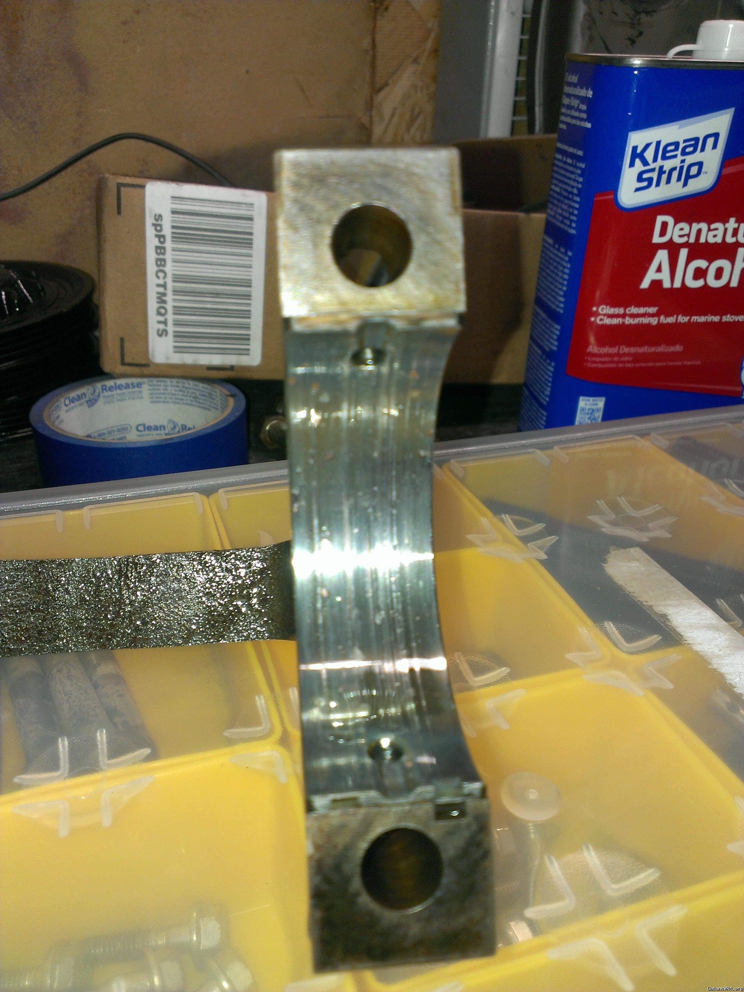

Inspection after coolant contamination

$60 bucks for new ACL race rod bearings, another $60 for mains is probably the best money spent. Honestly, I would do it. They don't look horrible, but I see some scoring. I would not trust them on a fresh build. Do it now or regret it later.
I used ACL race bearings on the last round, used the extra oil clearance bearings and Rotella 15w-40 with great success.
