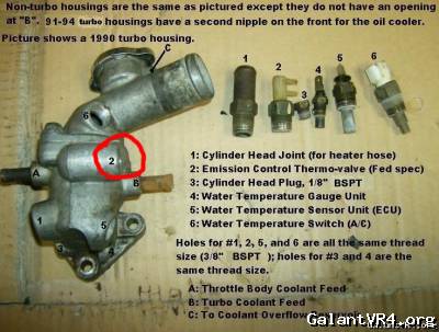

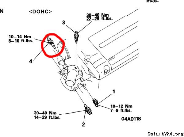

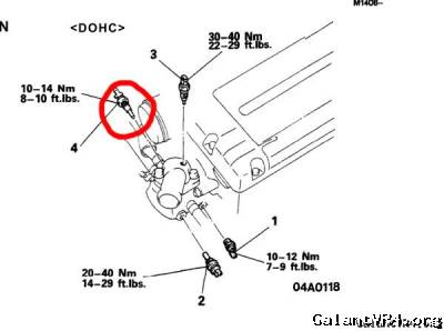

When Looking at the FSM I noticed there is a switch for radiator fan on the thermostat housing (number4) :

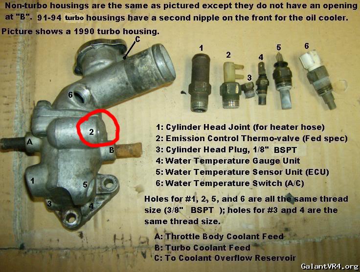

However when looking at some pics online I noticed in a 90s housing it has a thermo valve at where the #4 coolant switch is according to FSM:
I wonder what's the difference between a 90's lowing housing and a GVR4?
Also can anyone help with the part number for that coolant temp switch? Thanks.

#4 is the fail safe switch. It will switch on BOTH fans when it reaches its set temp. Its not found on dsm afaik.
