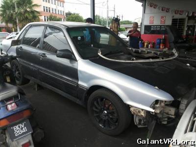

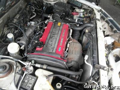

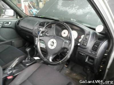

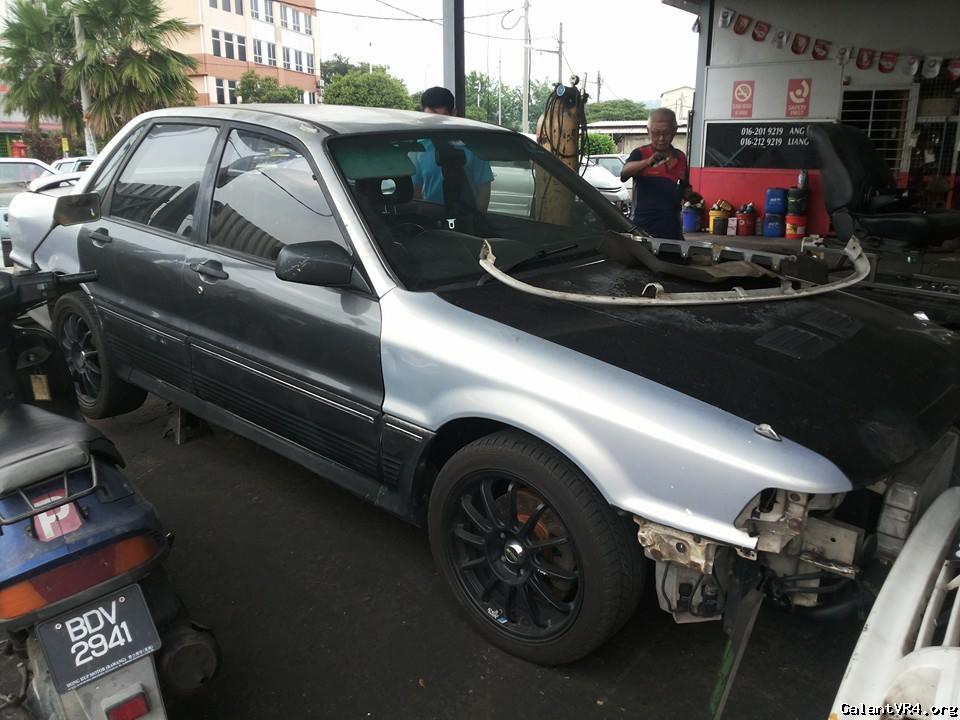

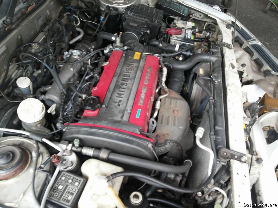

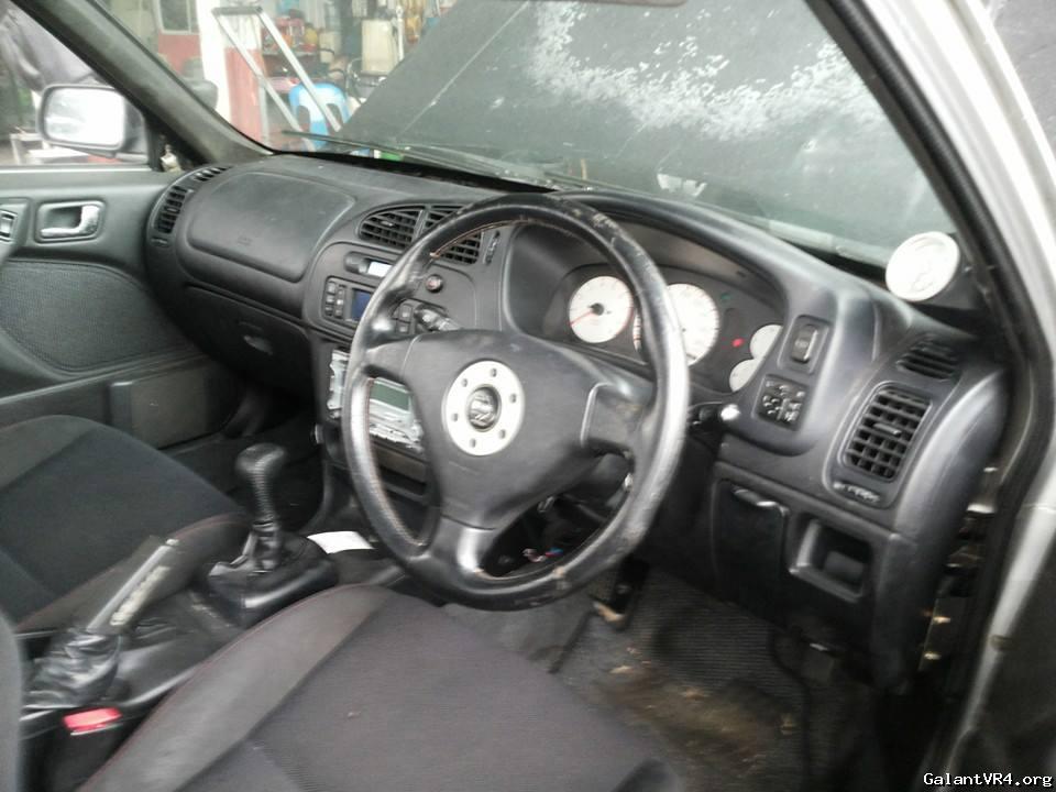

...hay guys, check this out
it even has a Evo3 dash in it
no info yet on this car, but I found the picture on facebook in a Galant VR4 group that im on.
11,993
Ugh. If people want an Evo, they should buy an Evo. Dash swap? Really?
I realize the transmission on the Evo 4-9 are stronger, but IMO it's not worth the engine swap for just a better trans, since you can make the same power with our "old" 4g63. There are other options with less headaches to deal with the weaker transmission.

just do the swap, ive seen many early evos with late model 4g63s in them, people put sr20det and rb20det in toyota ke30 corollas here, just take into consideration it wont be cheap.
