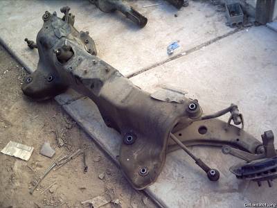

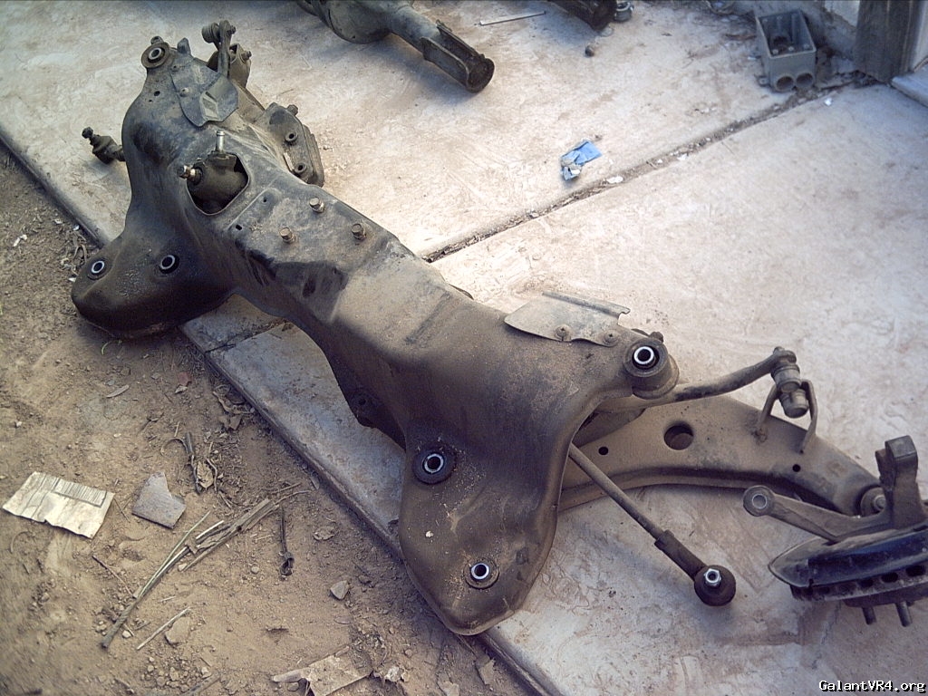

How may people would be interested in these bushing for the sub frame.
I would be depending on price. What are you planning to make them out of? Depending on the hardness of the material, they look like they may be pretty stiff. Are you planning on having some sort of metal sleeve as an insert?
I would definately be interested in rear subframe bushings. Replacing the bushings is next on my list.
Also, which 4 bushings come in the front subframe kit? I see 6 mounting points here.
