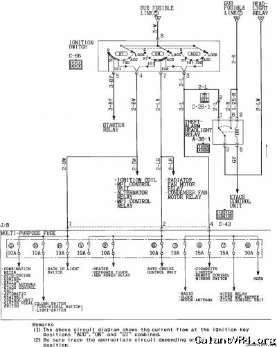

To solve the window issue, you should get to the basics with your voltmeter and check for voltage and grounds on the proper wires at the proper key positions for the switch connector in the door.

I don't know which wire is what though. I know the switch only gets juice when the key is in the "start" position. Where does the power come from for the switch?

check to have power in where you should and power out where you should. I'm just not seeing any one thing that could be the source of the issue given what does & does not seem to be working. double check your underdash grounds. check wiring for shorts to ground & from circuit to circuit.

South, I love you (noHomo). /ubbthreads/images/graemlins/worthy.gif tested the fuse, had juice but noticed it clicked when I touched it. Checked it out and it wiggles like a loose tooth and loses connection. holding it, the windows work. /ubbthreads/images/graemlins/grin.gif
