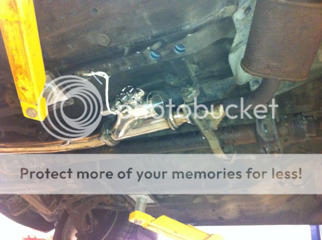

I have now used this cutout for over 2 years and around 10-12k miles, with great results:
They used to be sold exclusively by Raceland USA, but now you can get them from other sources, for about the same price as before:
These guys ($159)
Or, if you do not want the fancy remote control, these guys ($95)
This cutout does have a slight leak, which is noticeable because of extra quite (and restrictive) Summit exhaust. I expect it to be less noticeable on an EVO or DSM, which come with less restrictive exhausts from the factory. But, most importantly, the leak wasn’t loud enough to fail inspection from a “normal station”! So I can live with it!!!
