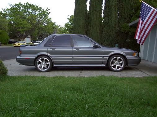

AWDPower
Feb 28, 2011
107
Vacaville, CA
I've got the Prokit/AGX combo on my Galant, and it's not slammed. I also didn't have any problem dialing out the camber to a negative .5 degrees with the stock adjusters.
