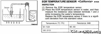

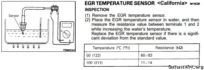

Looking at the manual, I find the following:
I'd imagine the lower value/range tells the ECU we're in open loop, and the second, higher value/range reports closed loop. ...back to this resistor idea (if I did go that route), what range would I want the ECU to see for the rest of its life?
