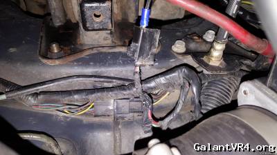

Where does it go? The wire is in the harness and I'd like to use that with Ecmlink to control something. I'd hate to cut it and run another wire through the firewall if the current wire is already under the hood somewhere. So where is the other end at? /ubbthreads/images/graemlins/dunno.gif Also the color is Light green/blue, not Black/yellow as in all the diagrams I found.

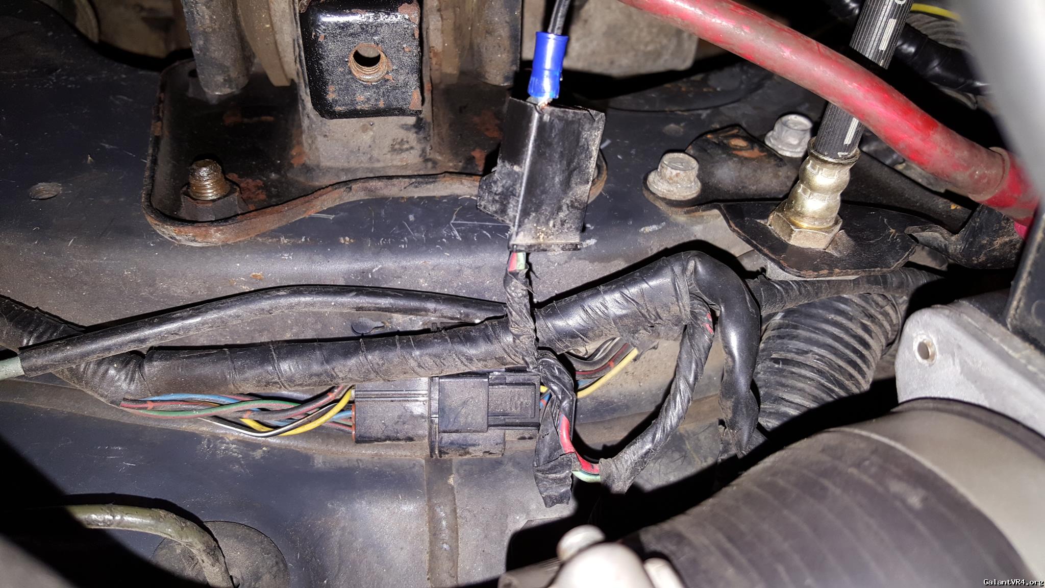

Well I finally found it. Real obvious spot too. Right next to the underwood fuse box. So now I could literally connect the temp switch wire from the back of the Thermo housing to this EGR connector without any extra wire. It reaches right across. /ubbthreads/images/graemlins/cool.gif

Instead of starting a new thread for this, where is this plug on the 91? Because I'm trying to do the same thing and I do NOT have that plug coming from that wire loom.
