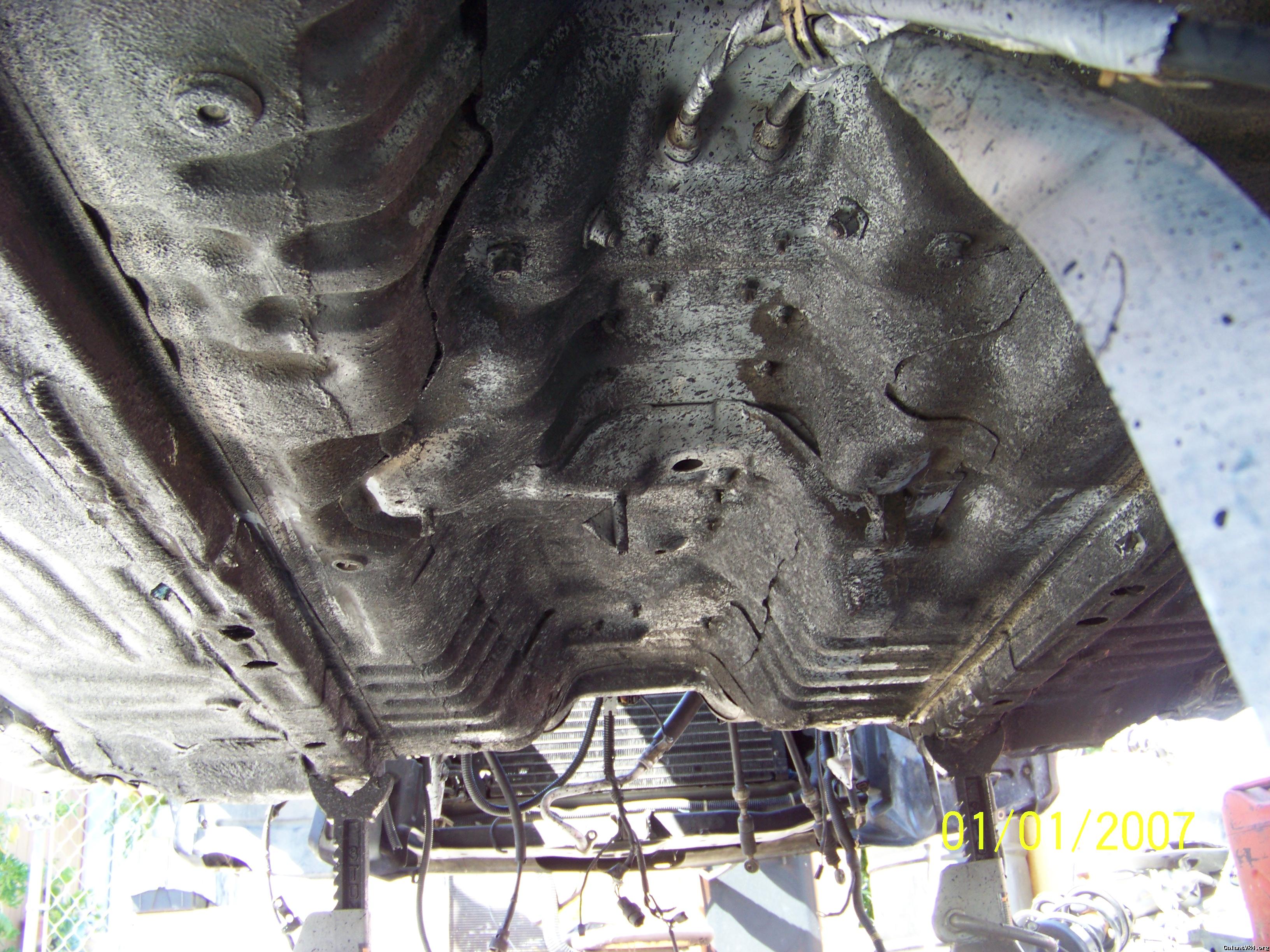

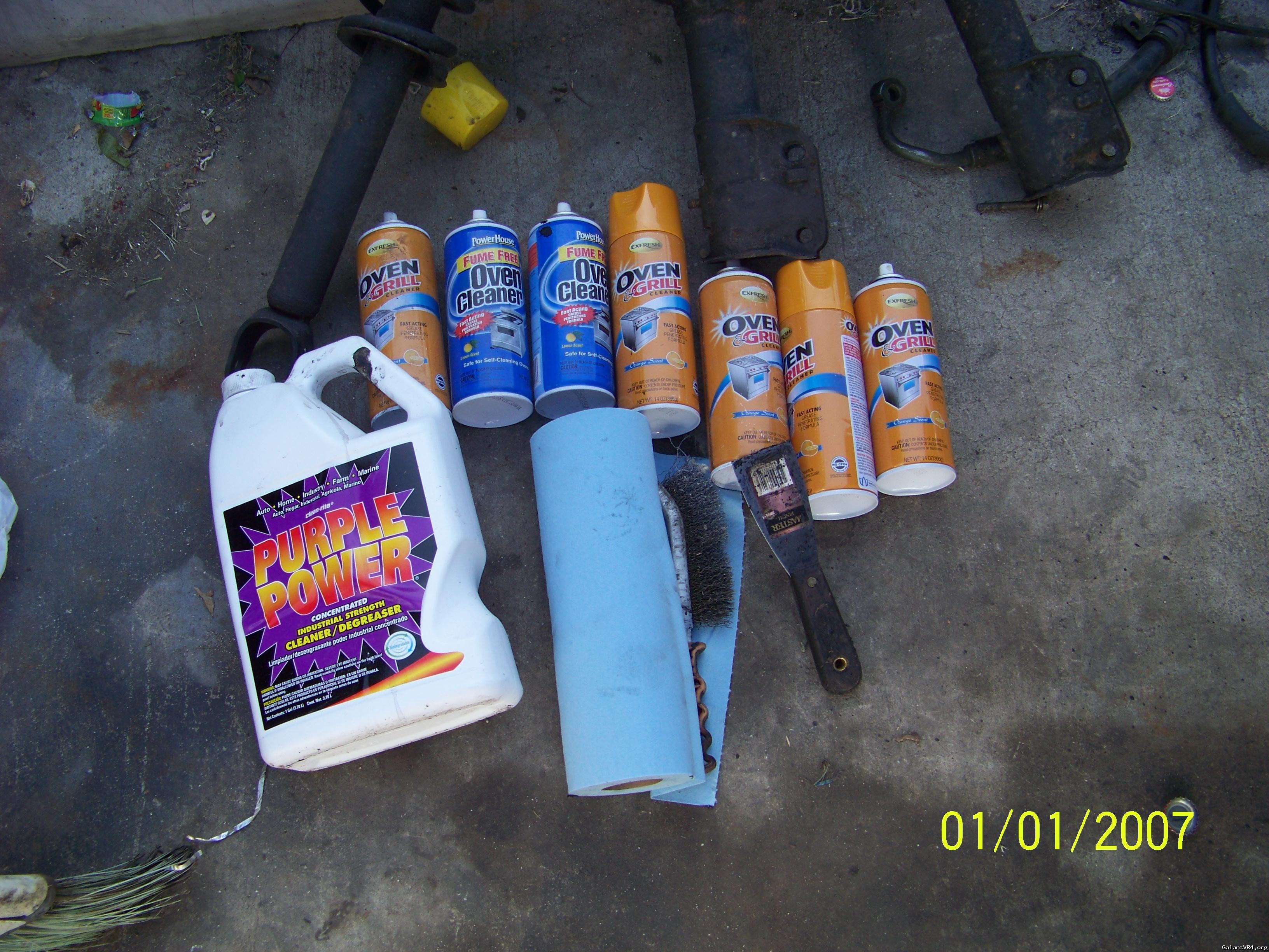

If you are planning on doing this heres what I been using some oven cleaner you can get this at the 99cent store I recommend the orange one has no CFC so its not bad for the ozone layer. All in all I used about 11 of theses cans and they work great for heavy build up.

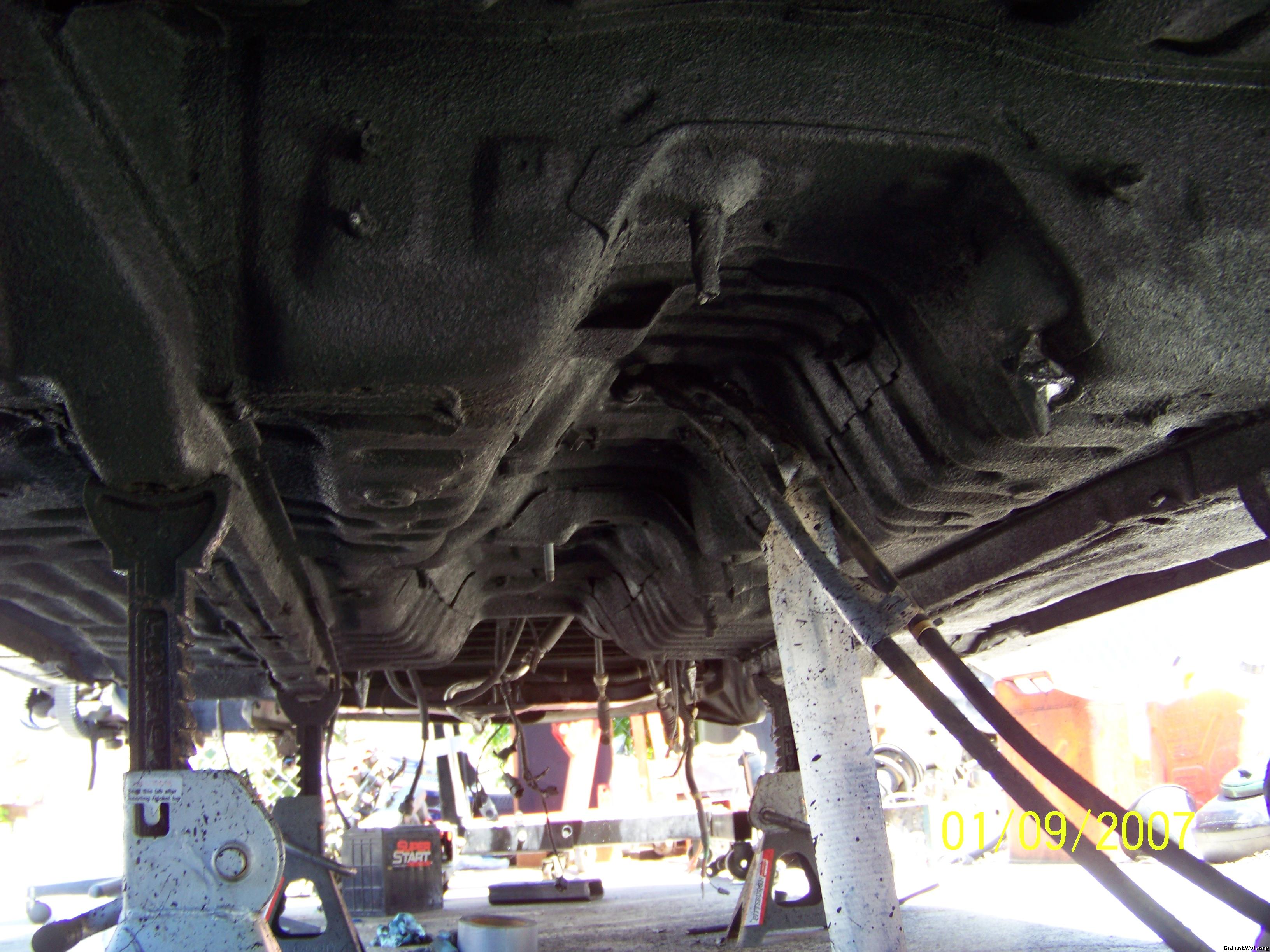

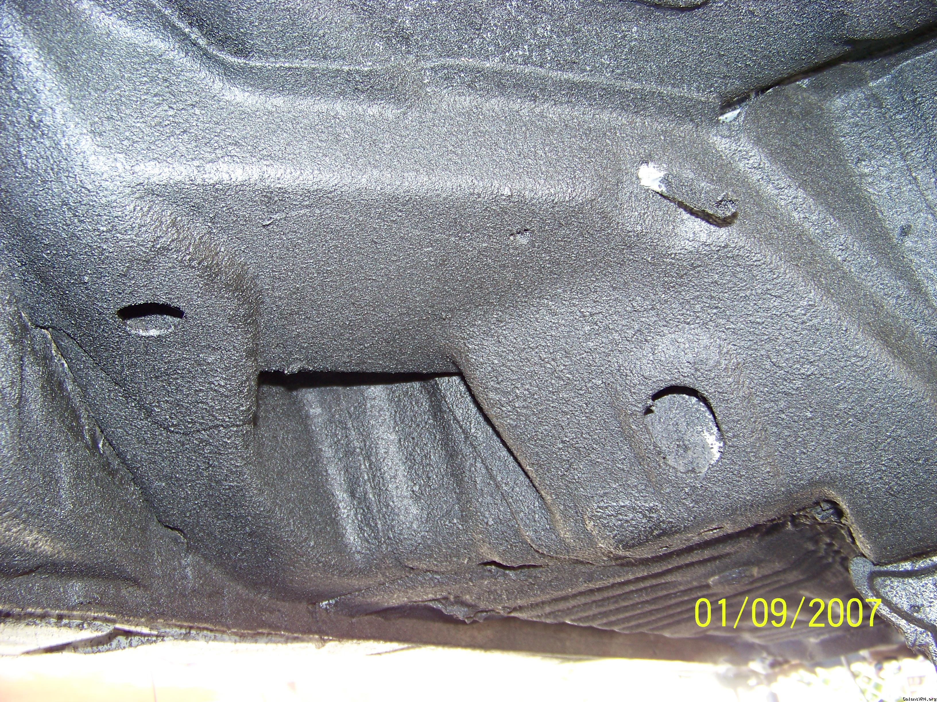

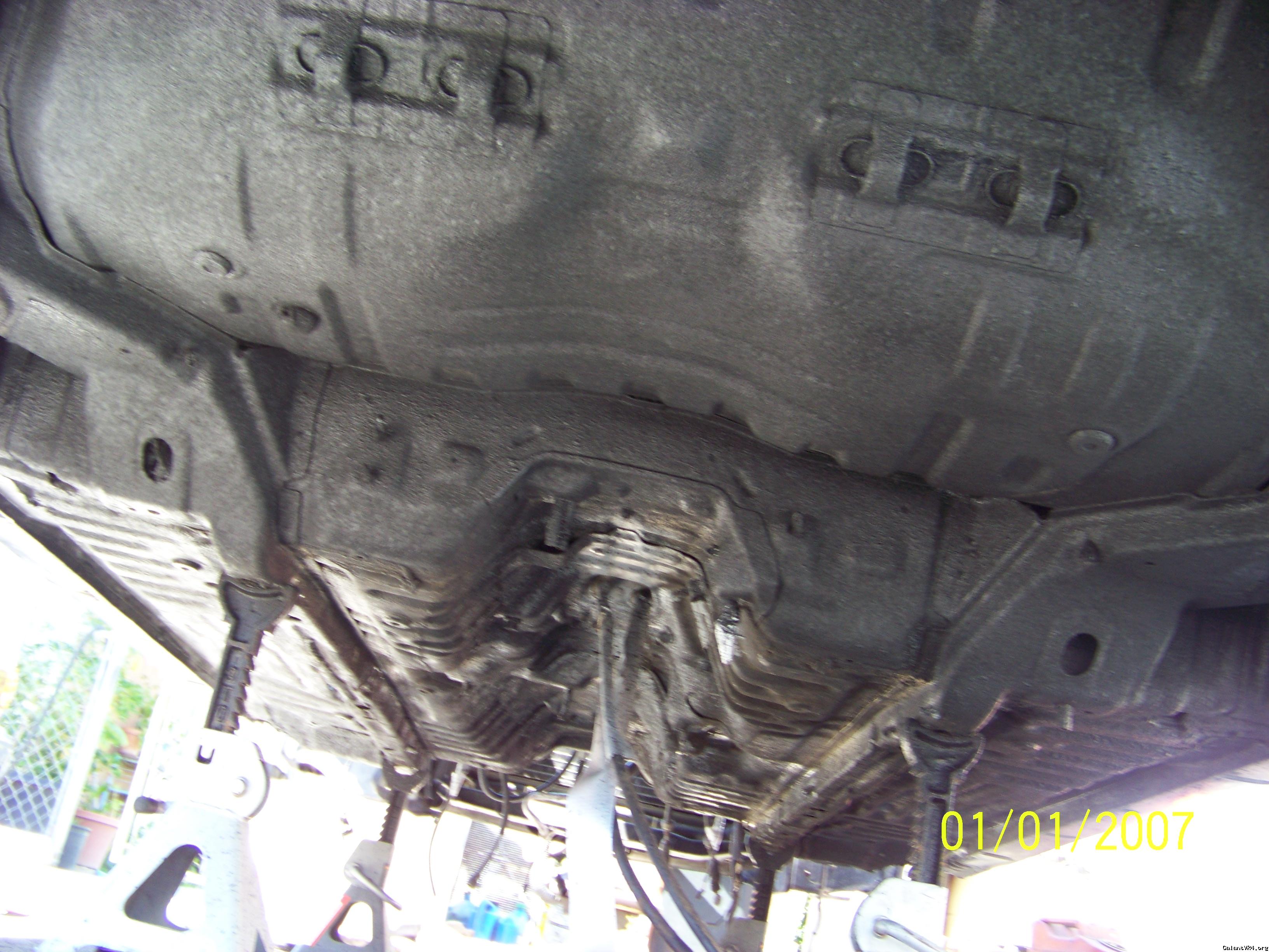

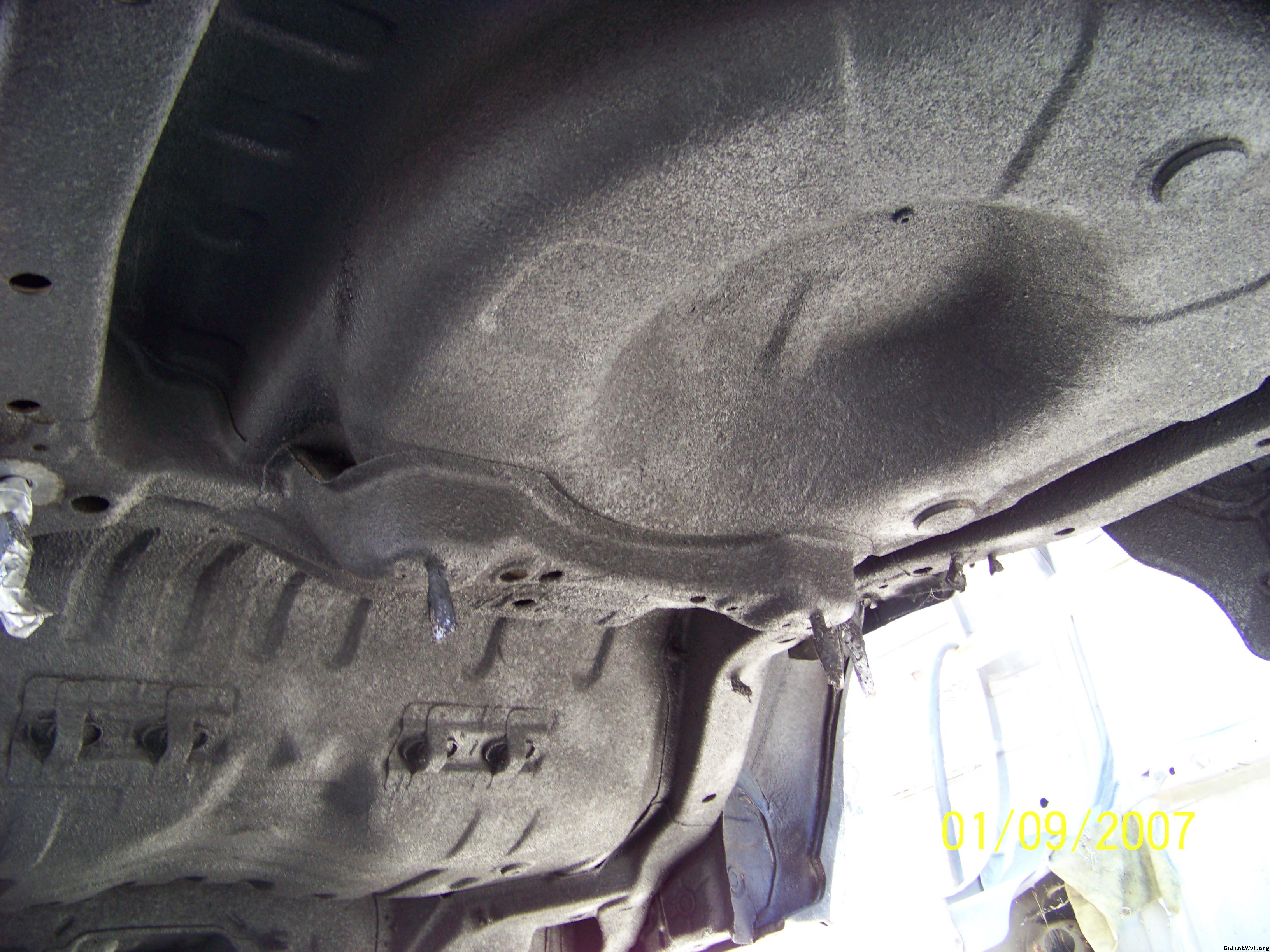

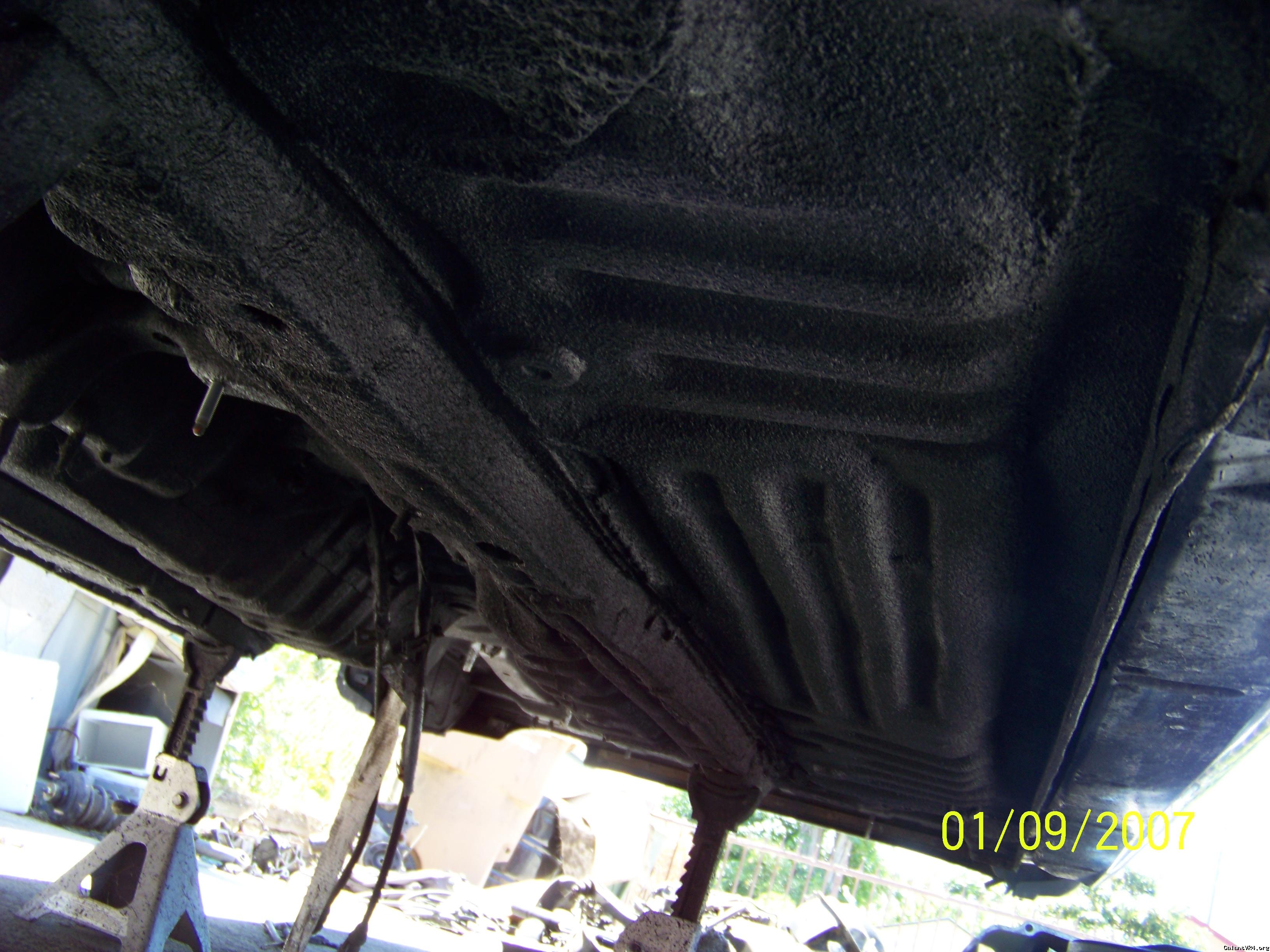

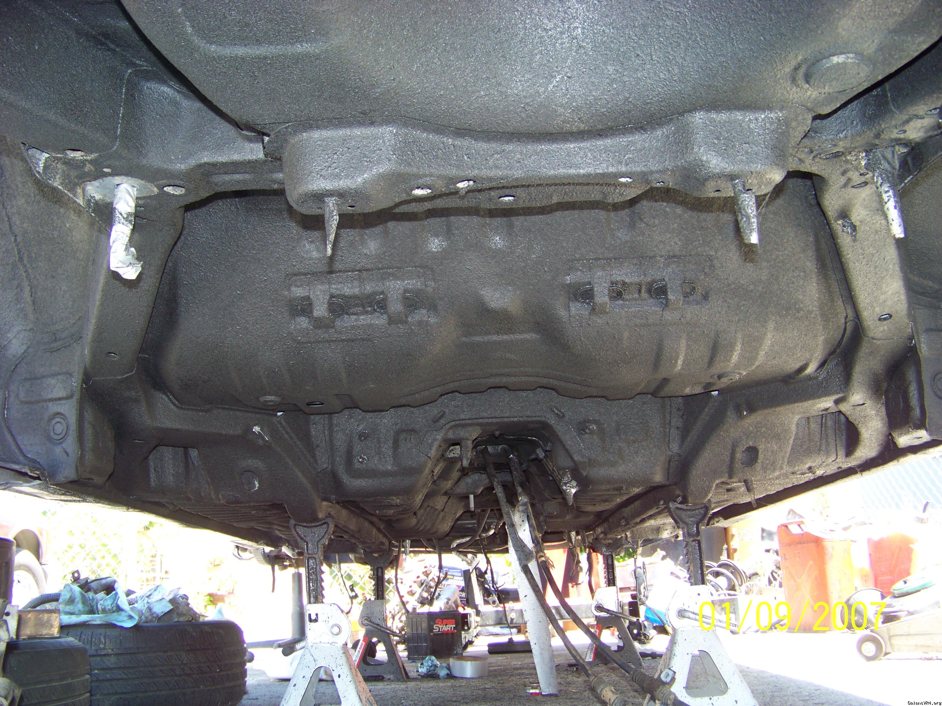

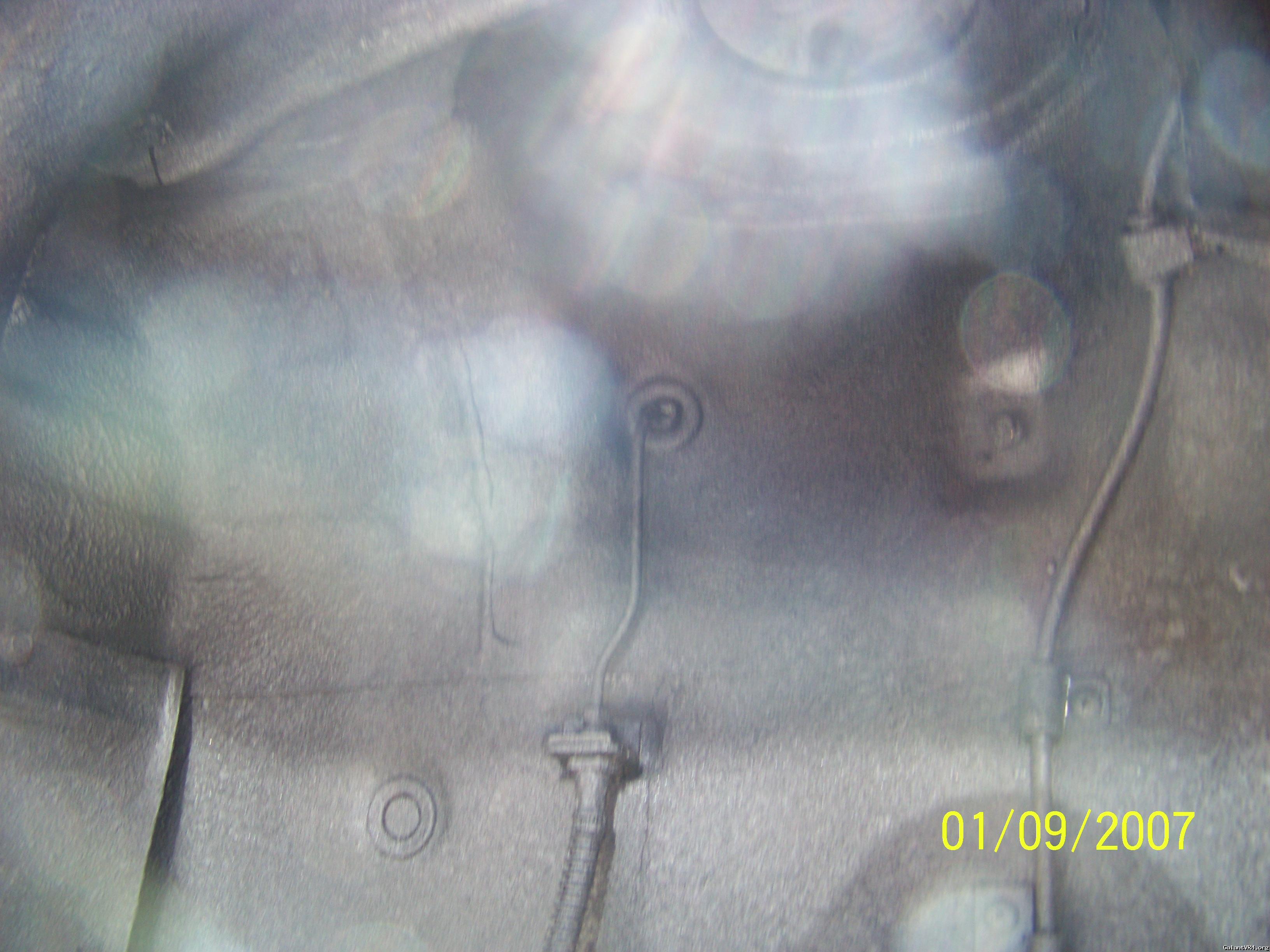

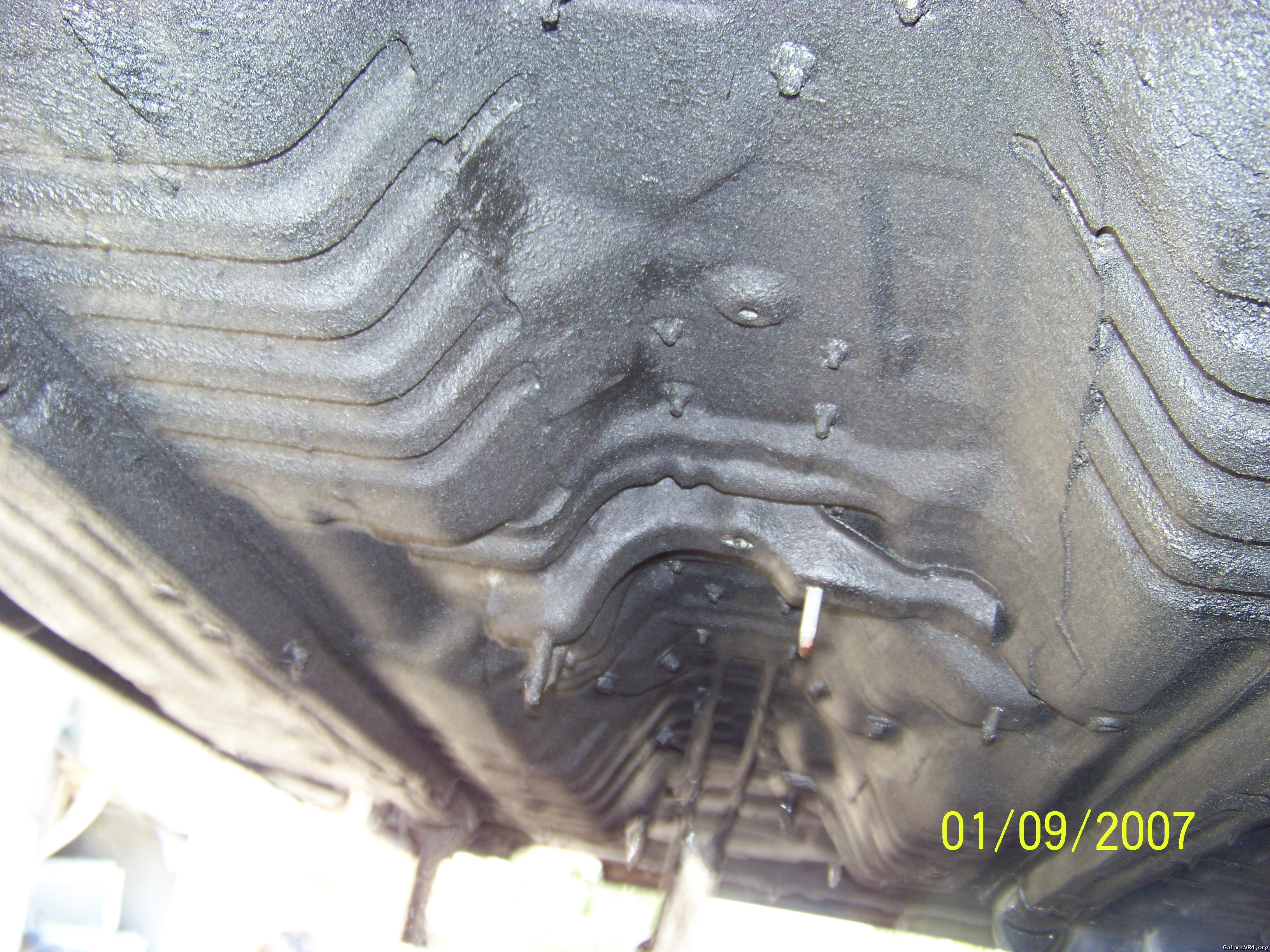

Ok so heres the final results in total I used 6 bottles wouldn’t hurt to have one more pics dont look that good looks alot better in person. I got all under the wheel wells and under carriage from behind the fire wall to gas tank area.
