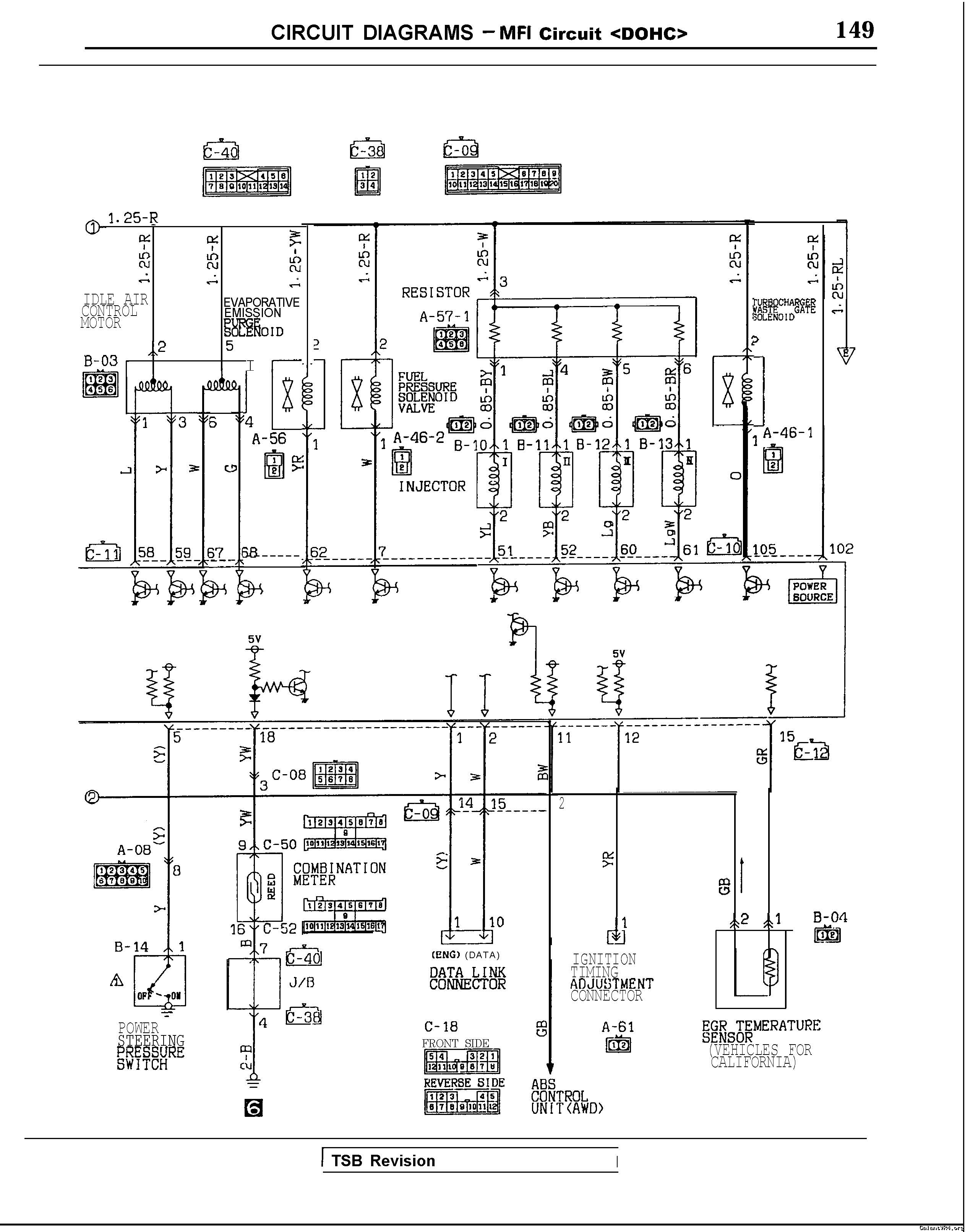

Well, my rebuild of ????/2000 is so close to completion I can hardly stand it. I thought I had reached the finish line a couple weeks ago, but upon starting her up, discovered that cylinder #4 wasn't firing. Troubleshot it to discover that that spark is good, fuel is getting to the injector, and the injector is getting some sort of signal, but fuel is not getting through the injector. Tried other known good injectors, still no dice.

^^/ubbthreads/images/graemlins/uhh.gifQuote:

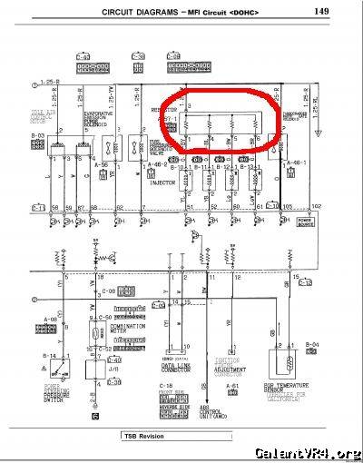

The injector portion of the circuit is on page 149 above. Check the condition of the wiring harness connector, just to be sure. Good luck /ubbthreads/images/graemlins/smile.gif.

Do you have a spare injector resistor pack that you can swap in?
I've had one check okay with a meter, and fail under the load of firing an injector.

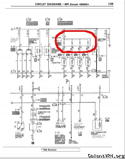

Thanks to Cspetros for the pic! /ubbthreads/images/graemlins/applause.gif
The injector resistor pack is a small rectangular silver box mounted to the firewall.
It takes a single power feed, splits it four ways, adds some resistance to each leg and sends the results out to each individual injector.
When one leg goes bad, you get a symptom very similiar to what you are describing.
It's a quick test to plug a new one in, providing you have a spare.
Another valid test is to plug your ecu into another car and verify the problem stays with the car or stays with the ecu.
