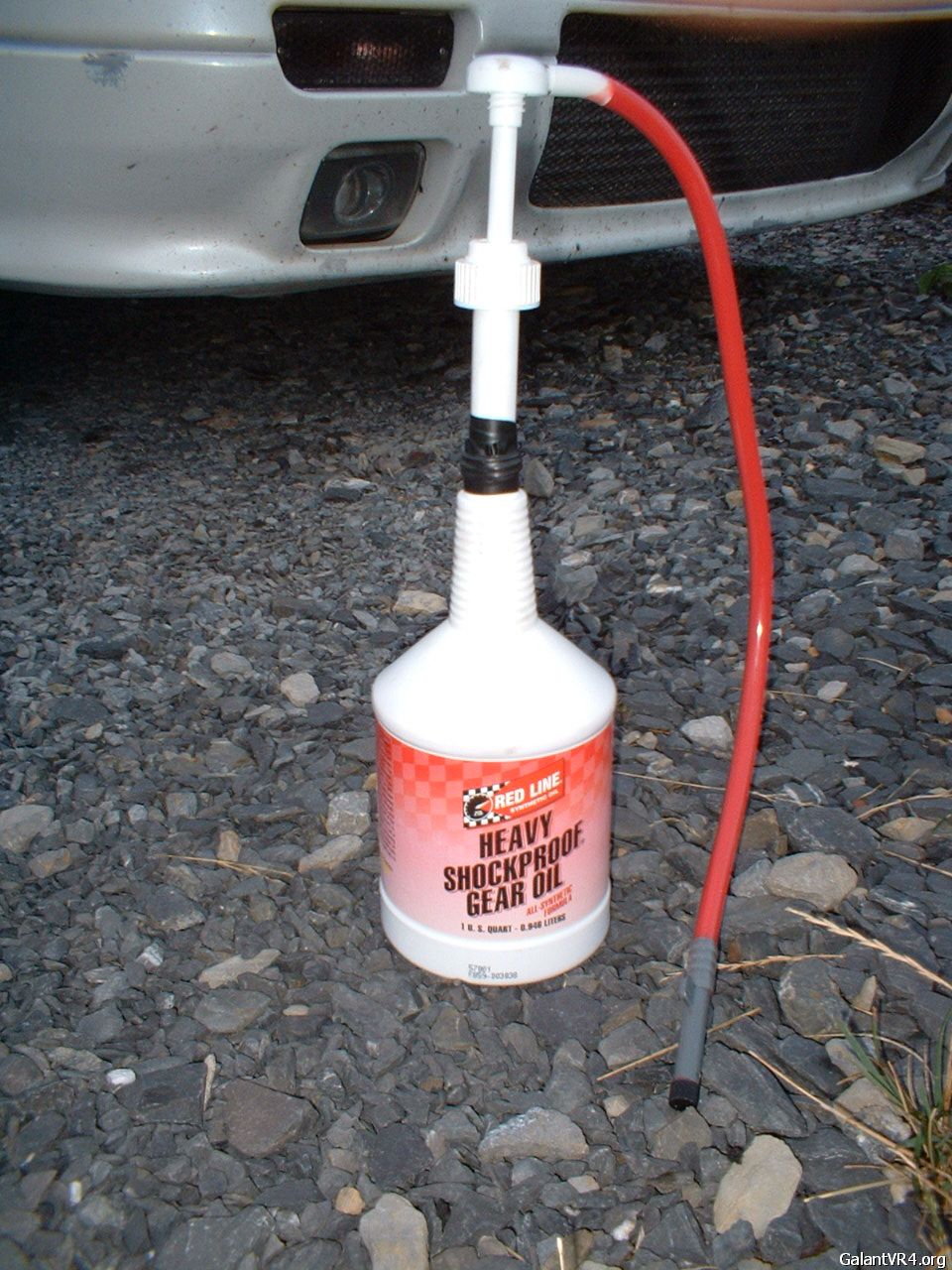

im sure some of you have already done this but i thought i would share anyway, i got sick of hasstle of trying to fill my t-case and rear with the hose/bottle trick so i came up with this way and it works amazing, took less time to fill up the rear than it did to jack the car up.

That looks better and cleaner than using a hand fluid pump. Where did you get the pump from?

Just need to clean it very well, so you don't pump abrasive cleaner into your innards... /ubbthreads/images/graemlins/smile.gif

For $6.00 you can go to Walmart and hit up the Boat lube section. The Quicksilver pump even threads onto the top of the bottle and the end of the flexible tube has a screw-on cap to keep from dribbling after you pull out. /ubbthreads/images/graemlins/grin.gif

you got it, thats where i got it. its in the boat oils and stuff section its used for pumping oil into boat motors, i also saw them at Gander Mtn, they are like $10, very clean and hastle free way to do it.

I just use a piece of silicon hose routed down through the engine bay with a funnel on the top. That gets the transmission and the xfer case. The rear end is still a pain. i like the idea of the 20cc syringe though.

i have the pump and 1 gallon jug for rears/tcases.
trans i use the synchroshift so i just jam the bottle up in there.

I filled a surgical glove with fluid and then squeezed it through a hose that was rubber banded around the open end.
For about $2 I bought a funnel that had a 2 ft long flex tube attached. Run it down from the engine bay to the fill hole. But the pump thing is a great idea.
