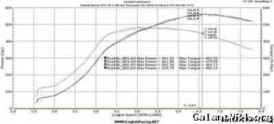

11,992
Paul, I would just use ECMlink. Piggy-backing one system onto another isn't fun. That's the whole reason I went to link. I'm not gonna talk down on Maftpro too much because when I purchased it, it was the best way to run SD without going full standalone and it worked pretty well. I'm not even sure I gained power over it with link, but now I have better support, tuning options, and driveability.

I wish there were more builds like this, where the goal is just a really fun street car. Nice graph, and definitely a nice gain in power!

We used to run a hobbs switch to activate the water/meth injection in the One Lap VR4 but once we got ECMlink we started using it to turn on/off the meth based on load. Works great and eliminates some of the wiring. From my memory we were a tick under 370whp at 25psi and 401whp at 28-29psi on a Mustang dyno. A good intake manifold can really wake up the FP3052 up top.

How much timing up top?
Interesting, I've been up to 33lb's on a 30r on straight pumpgas so far.
11,992
I think timing up top is 20 degrees. Maybe 21. I have the car down while doing some rewiring to clean up what I had to fix on the dyno for the meth setup to work correctly and I've been busy with other stuffs since I got home.
33psi on straight pump? Like 92 octane? I realize that may be possible, but my setup definitely won't allow it.

I always forget how much timing a stock CR 4g can take, especially on meth injection /ubbthreads/images/graemlins/ooo.gif
I think that with straight 92 on my 9:1 motor I couldn't push past 13* at peak torque with decent boost, and cutting boost for timing didn't help. I'd wonder if you'd experience the same thing, but I'm guessing you and Lucas probably went over that since he has tons of knowledge about optimizing meth setups.
33 on straight 92 seems like an awful lot to me with a 30r... /ubbthreads/images/graemlins/uhh.gif

I was able to do 15degs peak torque on pump with the motor you have now slugs. 24psi and 17degs peak timing. Car pulled good. But feels way better on e85.

For reference, I generally shoot for 15 degrees of timing at peak torque. If I can get there great, if not who cares. Its just a number. What matters is the area under the curve and how it drives. For the One Lap VR4 we were at 14 degrees of timing at peak torque and climbing to 17-18 up top. That's on a 9-1 motor, FP3052, 264/272, my intake, etc..etc. That made 401whp on a mustang dyno with 50/50 water/meth at 28psi. I will say that on a road race car it is really important to have timing up top to help keep the car cool. Running big boost with no timing is just asking for it to overheat. On a street car its not as important.
11,992
Quoting Brianawd:
On my E85 Tune I was at 21degs peak timing with 17degs at peak torque, spiking 32psi holding 30psi.
That's awesome timing on 9:1. It really shows that E85 can make amazing power when tuned for it. Knowing how much power Brian made on this turbo, I had higher expectations. Seeing others' numbers makes me feel better about mine. It's too bad E85 stations aren't more plentiful in my area.
