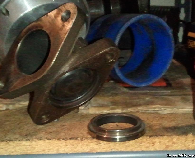

wat size spring u got in the external?....u got this piece in there?(pic).....this caused really bad spool when i forgot to put it in once....
Yeah, I bought the external brand new (Tial 38mm). The turbo acts/sounds like it should, but the power is just not there. Don't get me wrong the car made decent power at low boost so the turbo is working...something is just failing under those heavy loads...it can never be easy.
