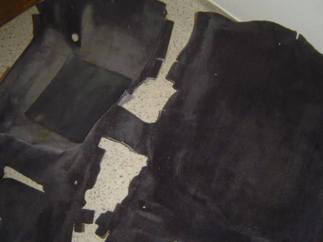

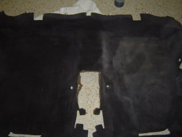

I did the carpet in 253 this way before I sold it to Jesse Withrow, it came out really good for how bad it started, here's a half 'n' half before and after pic. if you have sections that are especially faded you might want to spot treat those with the dye first, as they will take a bit more time/soaking to really even up the color. I used an automotive carpet dye, but it seemed the same as rit liquid dye. I used I spray bottle to do the aplication.

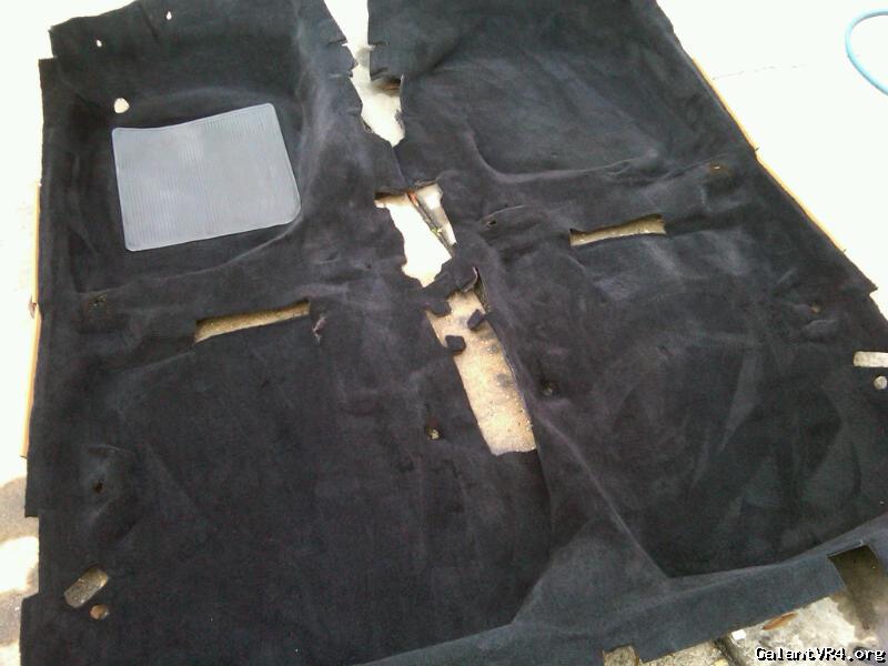

Ok so I dyed my carpet with Rit Dye and it turned out AWESOME!!!

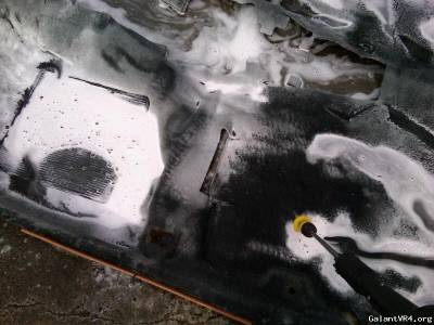

This is when I was pressure washing it. It looks like somebody had tried to clean it before. Took an hour before no more suds came off while washing it.

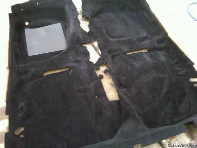

6 bottles of Rit Dye, and about 8 hours of soaking. This is the result. Lighting isn't great, and the carpet is still wet.

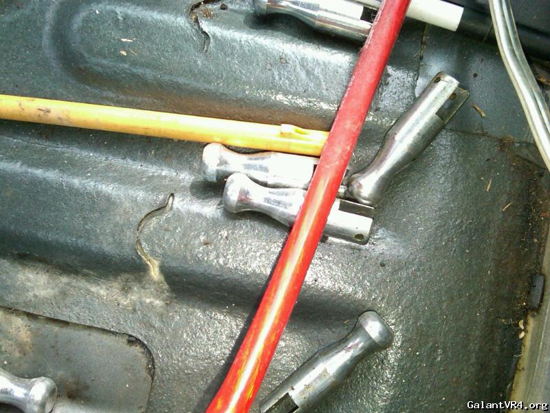

Anybody got any idea what the hell these things are? There were about 20 of them under my carpet!!

6 bottles and 8 hours?! Holy hell. I used 3 bottles and let it sit for maybe 2 hours. Yours may have came out darker than mine.
Did you see how mine turned out in the, "updating the interior - not wop approved," thread?

Yea I seen yours, and it looks good. I wanted to make sure mine was dark black, so thats why I used so much dye and let it set so long.
There were a bunch of condoms under the carpet, along with some makeup and alot of what looked like poppy seeds. Those things I pictured got me stumped though. They are aluminum, and a little bit of weight on them. I just cant figure out what they are.
