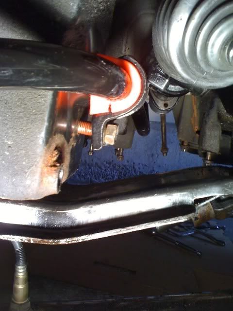

Quick question for you guys.
I picked up ES' front sway bar bushing kit for a 1g. I'm about to tighten the brackets and noticed the bushing doesn't sit very nicely. The bottom of the bushing doesn't get full coverage. Is this normal?
Here's a pic:
Also, I believe I read a thread stating the 4 bushings and washers go unused. Is that right?
Those four bushings/washers should be able to be used for the rear sway bar endlinks iirc.

Looks like you've got the job mostly done.
As I remember it, the ES sway bar bushings are a PITA to install. Or it could have been weaksauce on my part. The bushings are a lot less compliant than the original items, so yeah, it's not too much fun. I used a lot of the supplied grease and a longer bolt to get the mount to start. I believe I also used Prybars, Vise Grips and C-Clamps in some manner to get the bracket down far enough to get the longer bolt to start in the threaded hole in the subframe. It's been so long since I did the job, I don't remember exactly what I did to get the bracket down over the new bushing, I just remember a lot of swearing and at least one bashed finger.

Starting the bolts weren't the issue lol I got that part.
Before I tighten them all the way down I want to make sure they'll sit ok.
It looks like the bottom of the bushing won't sit flush against the frame.
Can anyone confirm the use of the 4 smaller bushing in the rear?

It'll be fine. I just got done doing the whole rear end and also the front control arm and sway bar bushings. Mine was the same way, just tighten it down making sure nothing pinches and you should be golden.

sweet man, I just didn't want to crank'er down and risk damaging anything.
What did you do with your "little" bushings from the kit?

Gave them to a friend with a 240SX. I bought new moog endlinks all around and used the energy suspension kit for the rear sway bar.
