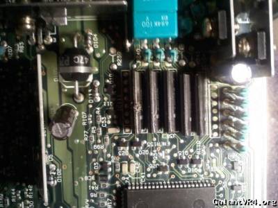

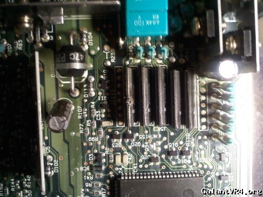

It sounds like Random Misfire to me. You aren't getting a P0300 MIL code from it? /ubbthreads/images/graemlins/confused.gif Does it do it when the engine is cold, or only after it has warmed up?
That's IC112, which controls both the BCS solenoid and the FPR solenoid. It looks like the burn may be towards the front of the chip, so it would be the BCS/wastegate solenoid. If the solenoid is shorted, or the wires to the solenoid get melted/shorted together, that is what happens. I doubt it has anything to do with the DSMLink.

Could I just un clip them? I did yesterday and reinstalled the ecu and nothing happened, it didn't start to smoke or melt or anything. Should I not do that again?
If you aren't using either the BCS or FPR solenoids, I would just wiggle the IC back and forth until the leads break off, and leave it that way. The chip is already popped, so its doing no good for you.
