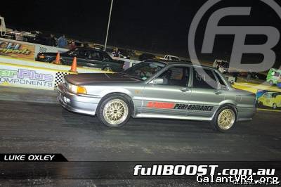

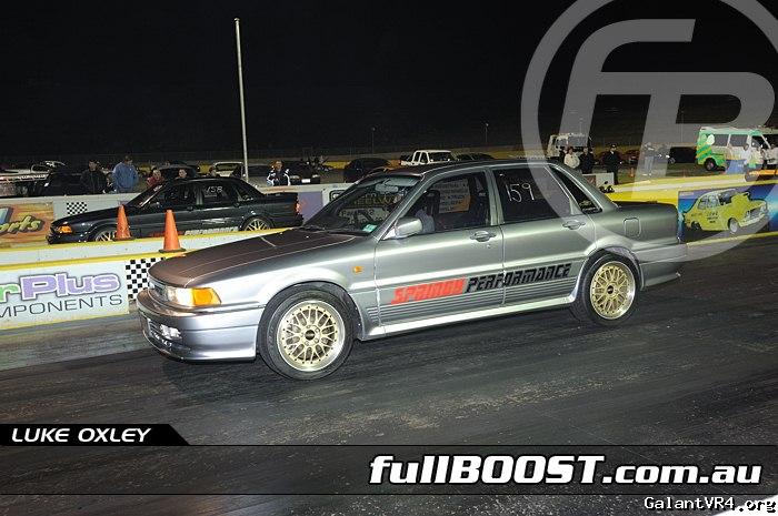

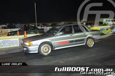

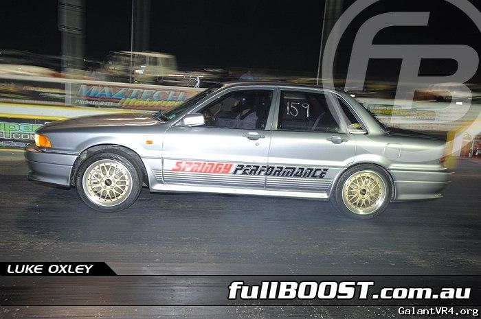

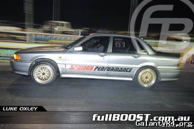

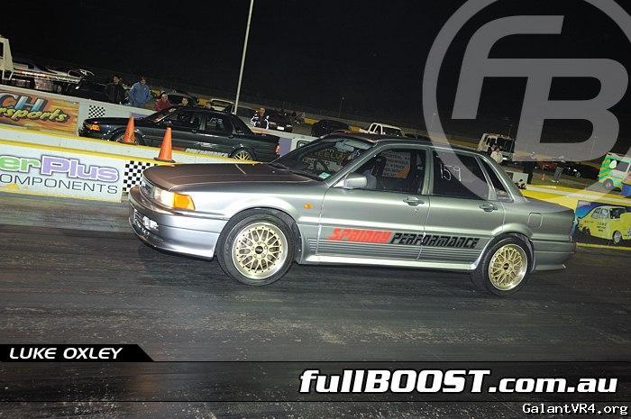

The launching pics also updated above!

Well crap son I see what happened, it isn't the weak parts its the green car in the other lane.
Your car knew from the start that Green cars are faster. /ubbthreads/images/graemlins/rofl.gif
