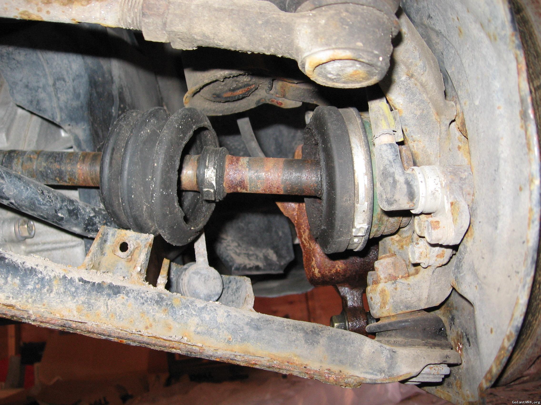

The front passenger side wheel area has developed this click noise, which isnt quite a clunk but is loud enough for pedestrians to hear. When the noise began I was just driving down the highway in a straight line when the steering wheel suddenly pulled right. At the time, I thought it was built up ice in the wheelweels from spinning the tires in the snow as people with AWDs are wont to do. Since I cleared the ice out, the click showed up from time to time, eventually getting worse.
Driving around a corner under acceleration seems to be when the click is most likely to happen, although it will click under acceleration in a straight line, accompanied by a twitch in the steering wheel. To me, it seems like a spline of the axle, or whatever part is directly driven by the axle(or both) may be stripping.

It's probably the joint in the axle going bad. I think you may have to replace the entire axle? I haven't done one on my car yet so I couldn't tell you for sure. My axle was clicking on my nissan nx and the bearings inside of the joint was destroyed.
From Raxles.com:
Continuous "clicking" sounds on sharp turns usually indicates a worn outer joint.
Usually the sound is loudest on the joint opposite of the turning direction.

Found a torn cv boot. I get a loud popping noise at the outer cv joint when the steering wheel is turned, so I will be ordering a new one from raxles.com and installing it ASAP. I also found that upgraded axles are too expensive for my busted ass, which is unfortunate ( DSS level 2 front axles ).

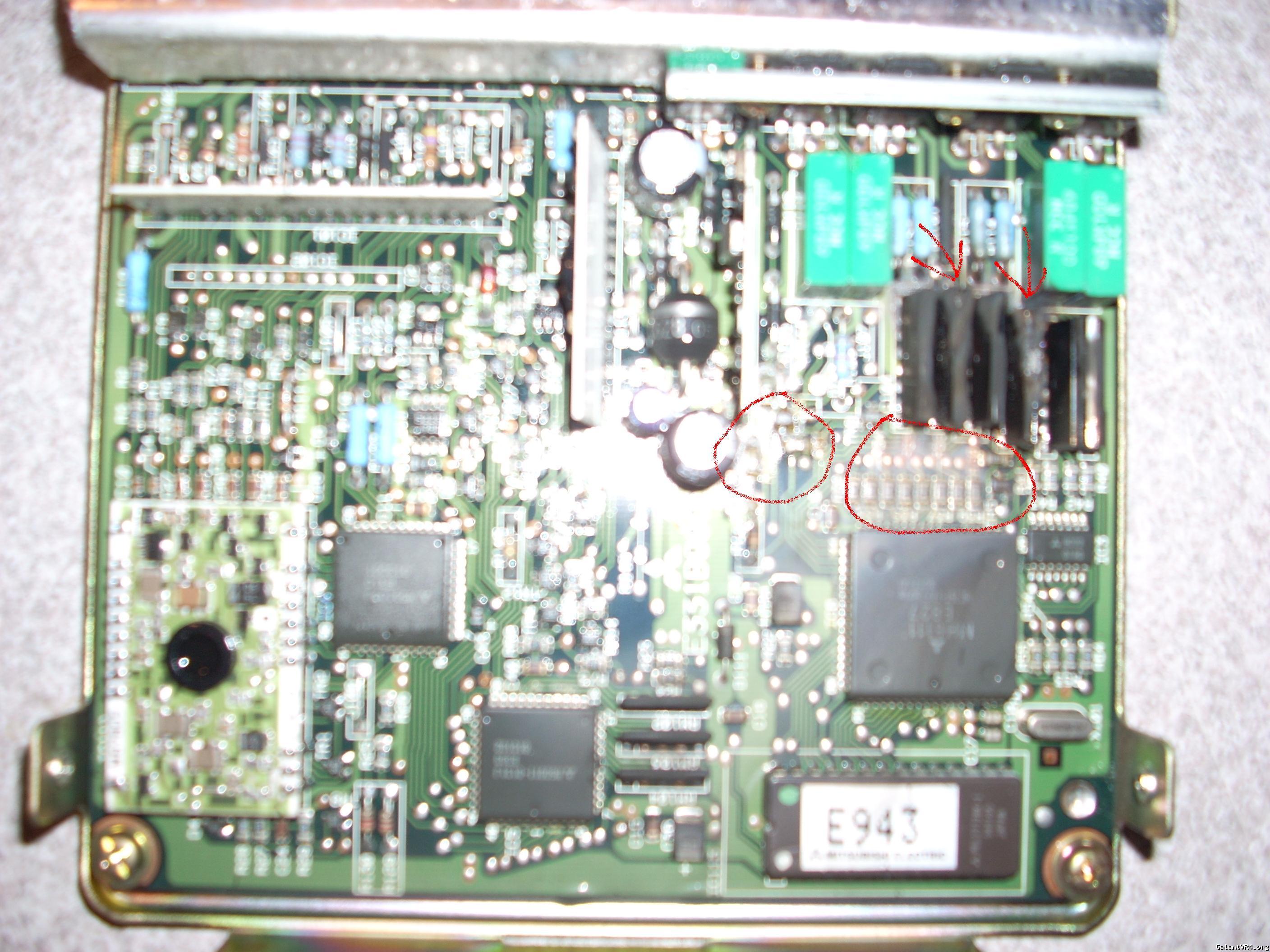

You were right, the ECU is toast. It looks like something actually exploded , judging from the black marks on the inside of the case and the little black plastic kibble spread across the board.
The discoloration on the board is pretty widespread. Also, the black chips(?) with the arrows actually split open and partially melted.

Isn't that one of the common signs that the ISC motor is shorting out? An exploded ECU? Only time i've actually seen something like that was from a backwards battery. Looks like a new one might be a better route considering the damage.
Wiz
Mm, I think its the other way around, meaning discoloration on the ECU can cause idle issues via the ISC drivers (see voltage/idle thread ). Apparently, the ISC traces on the ECU run really close to the leaky capacitors that everyone is supposed to replace (see the link on "exploded" in my previous post). Since there is discoloration right beneath the capacitor which is closer to the center of the board, I think the discolored ISC traces would be a likely culprit if I was having idle issues. Idle wasn't a problem up until the engine would no longer crank over. Unless theres a different issue you are referring to? I guess I could always test the ISC unit anyways, it couldnt hurt.

Yes, don't just assume that it was the bad 47uF cap that caused the ISC drivers to blow. It can also be caused by a shorted ISC, so you really should pull yours out and test it before installing the new ECU. There's nothing worse than installing a $250 ECU and then watching smoke pour out of it. /ubbthreads/images/graemlins/uhh.gif
