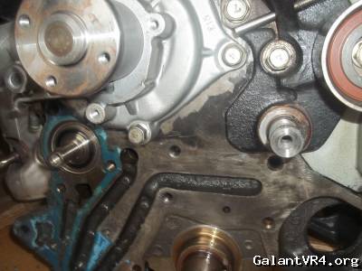

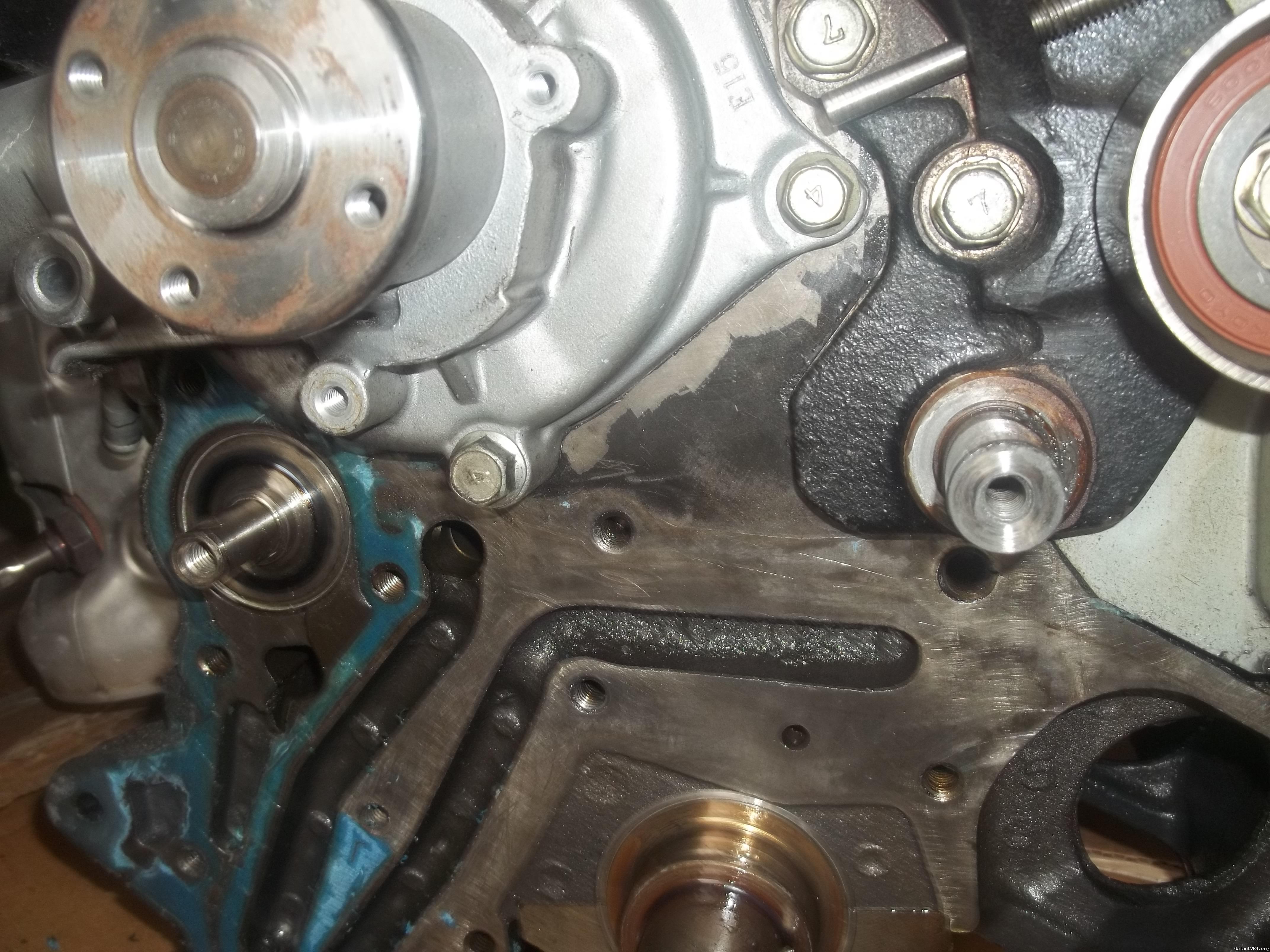

God damn setting timing and swapping belt is EASY. I did that today Along with spin the oil pump with a drill while the belt was off and found what I thought was all my leaks.
The only thing dripping was the lower bolt on the hydraulic tensioner was dumping oil, I put rtv with high temp thread locker on it, put it in and couldent see ANY more leaks.
So I put on my new timing belt and was done, get to the gas station and I'm still dripping oil and my belt is soaked GOD DAMN.
Could the rtv and thread locker have melted when got to operating temp. Has any one else had this problem? ( I'm using rtv good to 720degrees and thread locker good til 450)
Looks like I'm tearing her down on sunday again.

Hate to say this but you will have to take off the oil pump housing and replace the gasket as neither of the tensioner bolts runs into any oil passages . There is inverted boomerang shaped oil passage cast into the block just above the lower tensioner bolt. Your oil pump gasket may be compromised in this area allowing oil to seep through to the bolt.
yeti
Oct 13, 2010
803
san diego california
That's the best picture I've seen yet thanks,everyone's been telling me that and I've been really confused cause its clearly leaking.
I've heard I can get some pipe dope in there or liquid teflon? I'm going to try that before I remove the front case.
