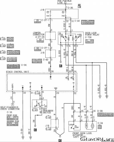

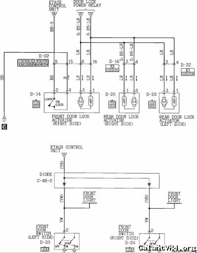

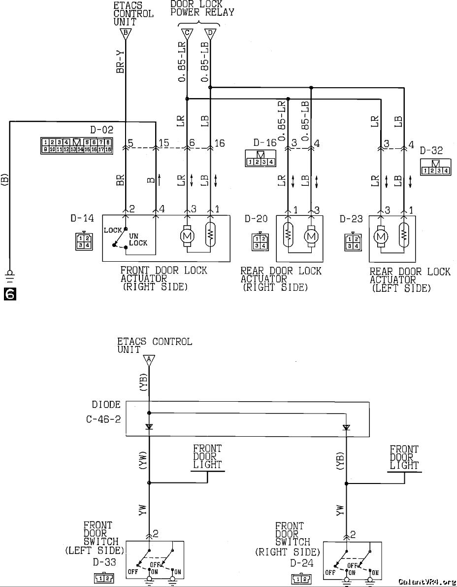

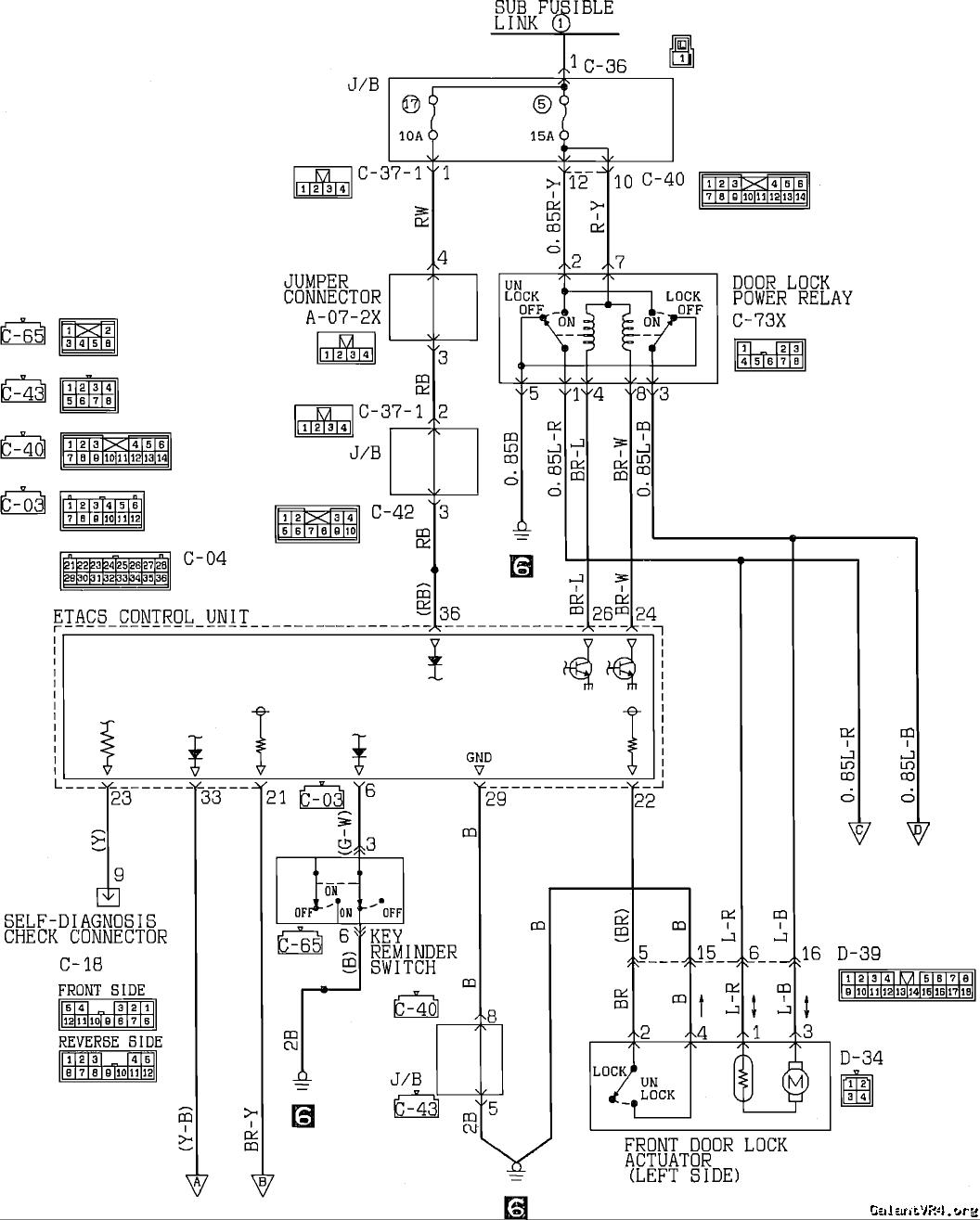

Hmmm I wonder why mine don't work then, there's not an actual button to push to unlock or lock them huh.
GSX_TC
Apr 7, 2011
3,733
Houston, Texas
Yeah mine def don't do that. I have to manually lift up or push down the lock when I need to open them. Anybody ever have this problem?
dsm10o0
Jun 16, 2010
685
San Jose CA
I just figured out this problem with mine.
Take off your under dash panel and you will see 3 relays down there. Its the middle one. iirc, its a 7 pin
Diego
Dec 9, 2007
2,132
Mine used to when i first put it back together, the locks would lock when I started driving IIRC.... now it doesnt lock unless i manually lock them... ill find the fuse or the culprit someday...
chucklesas
Feb 14, 2003
1,895
Dayton, OH
The wires leading to the actuators inside the door sometimes become disconnected too. Although, for both passanger side and drivers side to have this occur, probably isn't as likely as some sort of relay issue.
