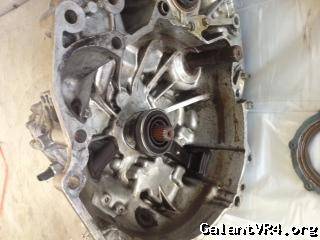

This has gone from a relatively simple clutch job to a nightmare. After installing and removal 3 times now, I have a leak, not my biggest problem though. What has developed after only 100 miles or so, and wasn't there until I took it to a mechanic to determine the leak, is a grinding noise if you will. When my car is in neutral and the clutch is not used there is a grinding or chattering noise. As soon as I press the clutch the nois goes away and the car is beautifully quiet. It does not seem to affect performance yet but am acrid as to what will happen. The flywheel is a stock one which was resurfaced when I replaced the clutch (with an autozone cheapy, it was free after they saw what happened to my old one from them) a hundred miles ago. I pretty sure I'm going to have to take tranny off again but lookin for someone to tell me that it's an easy fix. I can dream can't I.

Only thing outside the tranny internals that could make that noise is the throw out bearing. That's really your only option before you have to get inside the tranny again.
When my intermediate shaft outer bearing was bad, it make noise just like you describe. No, AAMCO said they replaced some bearings. I'd still suggest you find out which ones, and any other stuff they said they replaced/removed/repaired etc.
It's possible they did something wrong, or something else was going bad and it didn't become apparent until now.
Maybe you are lucky and they just put something together wrong that's right under the tranny end cover.

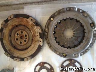

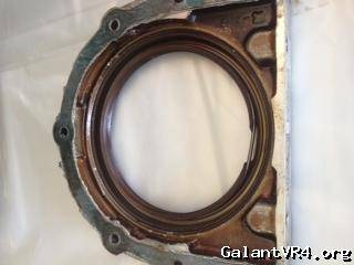

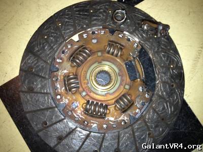

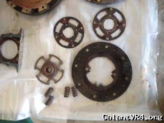

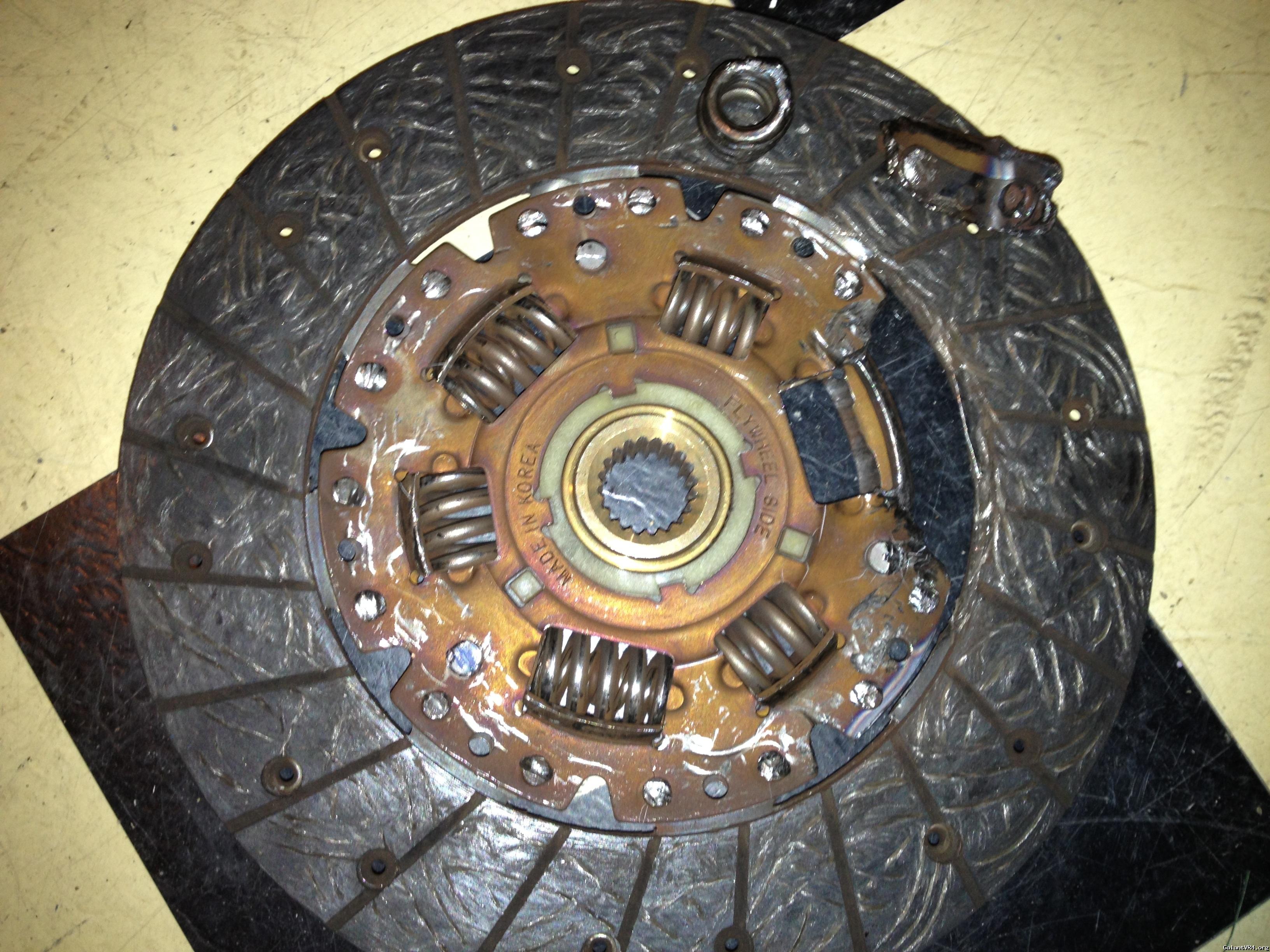

So, 2 weeks and about 100 miles after the new clutch and it diesd in the middle of a busy street.I got it home, tore it apart and as I was unbolting the Presure Plate metal parts just fell out.
Can these Sachs Oreilly clutches be that bad or is there a larger issue. I resurfaced the flywheel upon instalation. I also,from what I can tell had my rear main seal leaking. Can that affect the cclutch like this? Is my luck just this bad. My car is stock daily driver and I shift no higher than 3500 rpm.
I am going with an ACT this time hoping it will fix the issue. Anyone have input on best ACT for Daily Driver and where to get the best price let me know.
