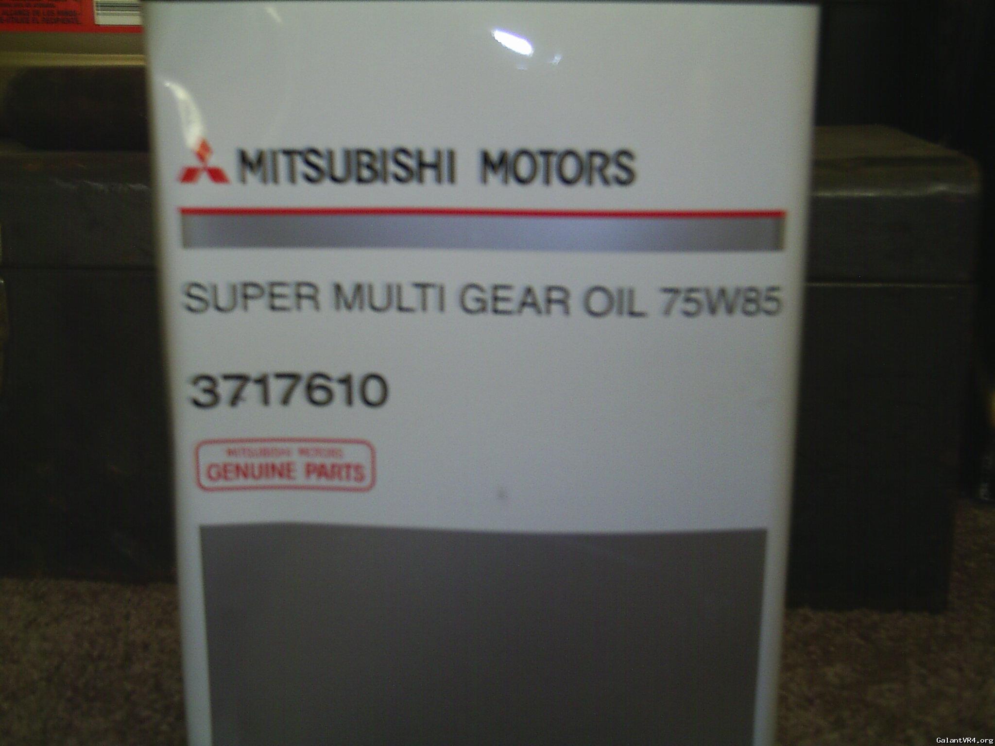

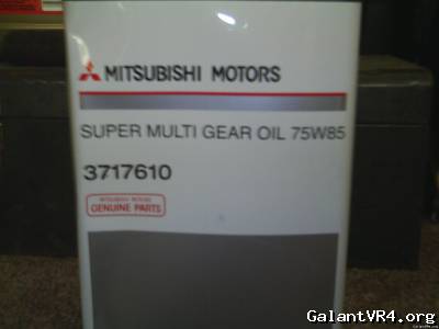

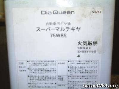

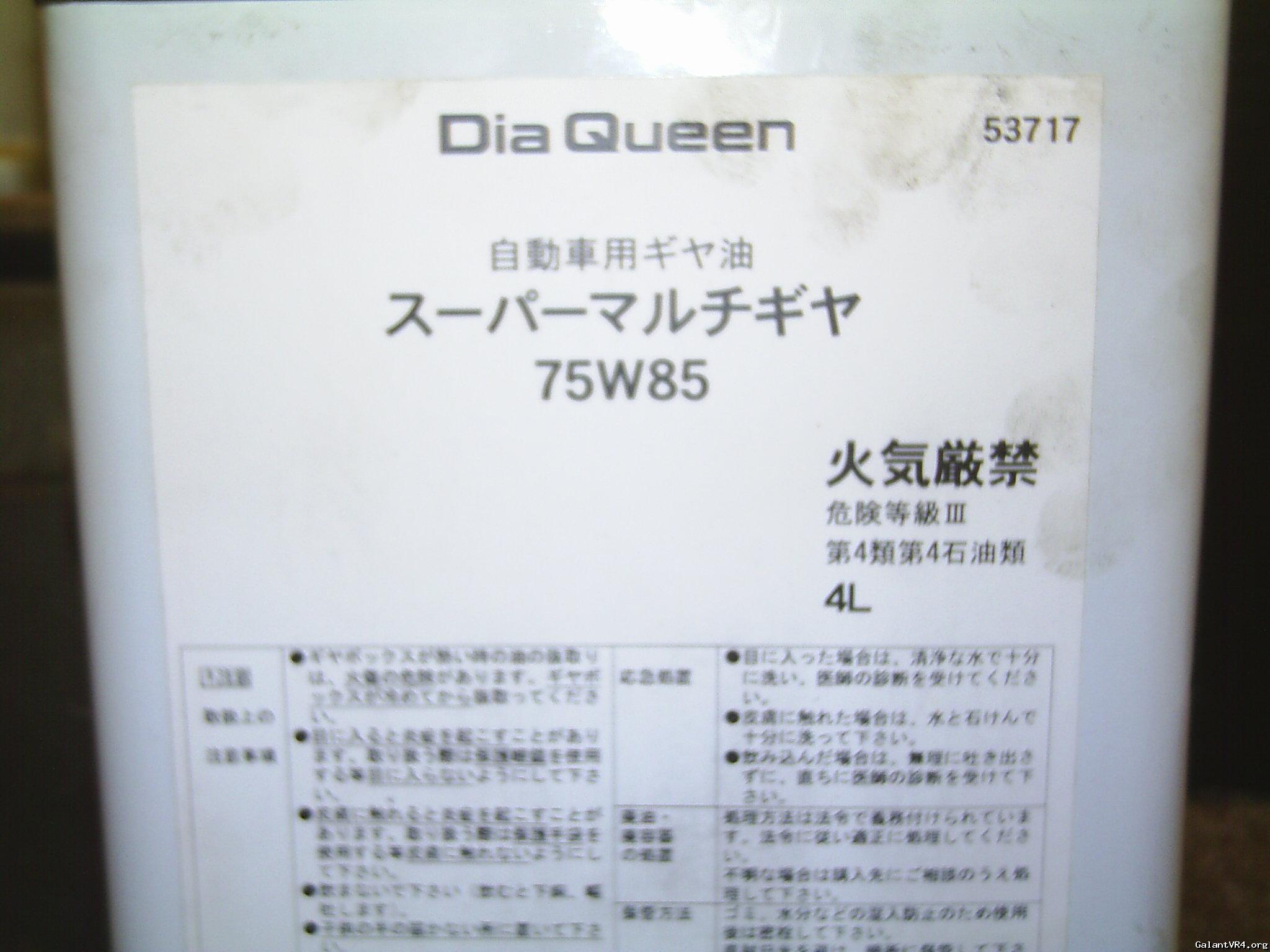

I figured this have might been answered already, but it has been a while since I have been posting here. I got some transmission fluid for the rebuilt trans in the Galant, and it doesn't look like the last container. Has there been a part number change? I don't have access to the Mitsu catalog anymore, can anyone help me out?
10,992
Well if it helps any, the Japanese on the top container says "Super multi gear". The numbers I think you can read. /ubbthreads/images/graemlins/grin.gif

For anyone keeping score, they are the same fluid. Two seprate sources confirmed that is diaqueen manual transmission fluid in the new container.
