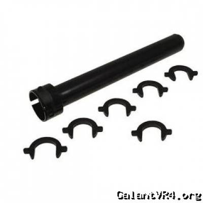

Inner Tie Rods is what we're talking about. The issue is that I called napa and they can't get me anything until next week and I've got to drive tomorrow.
I do have a place to work so that's not an issue. I seem to remember, though, that last time I did it there was difficulty getting a wrench in to tighten it up. There's very little space between the rack and the subframe in there and I seem to remember not being very confident that I got everything good and snug.
Anyway, I'll order the moog ones and deal with it when I get back.
