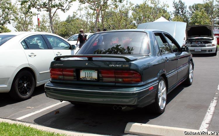

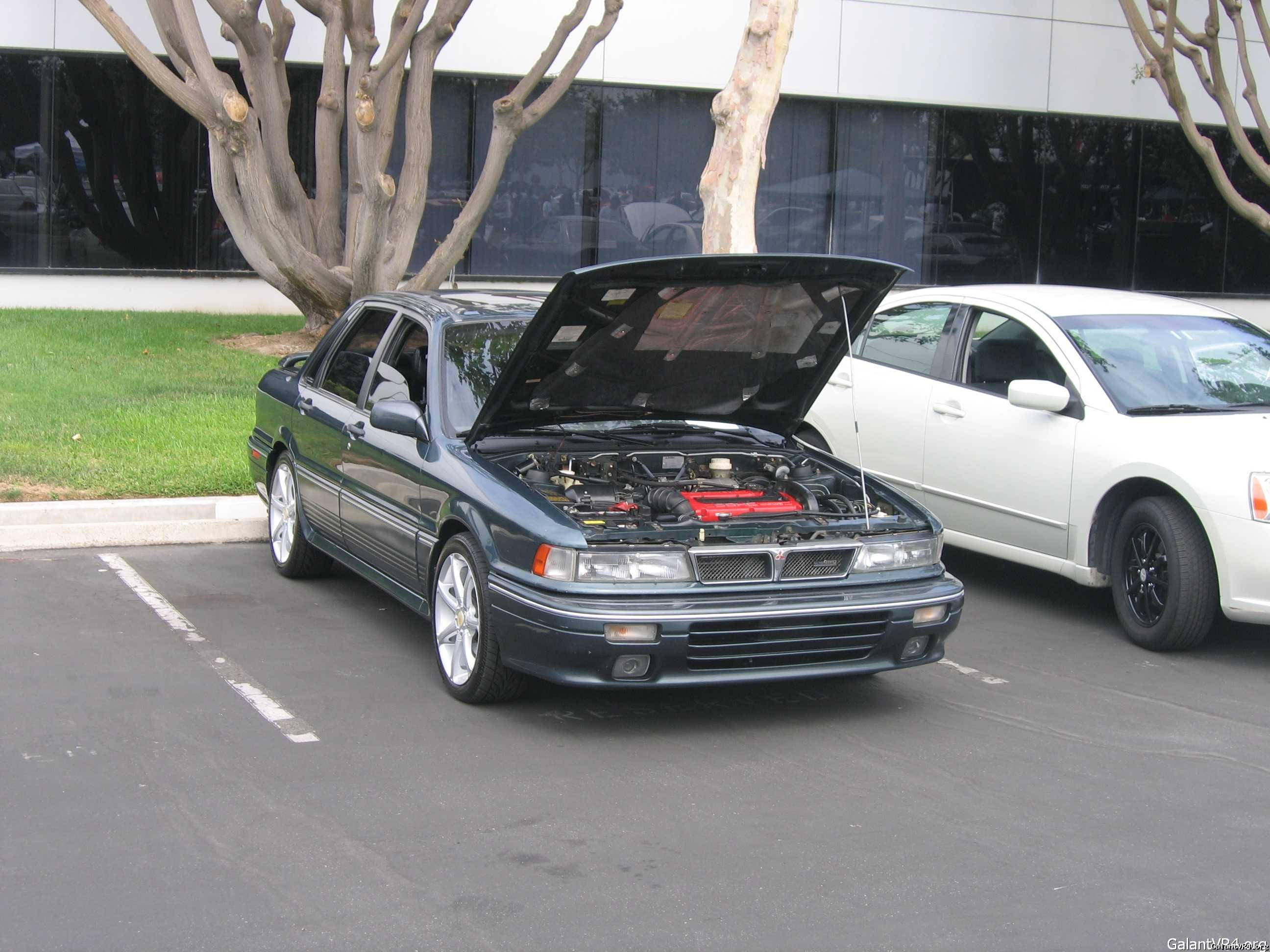

Here it is when my wife and I went to MOD in California. That year Motor Trend had a small little blurb about MOD and the picture with my plate was shown.
