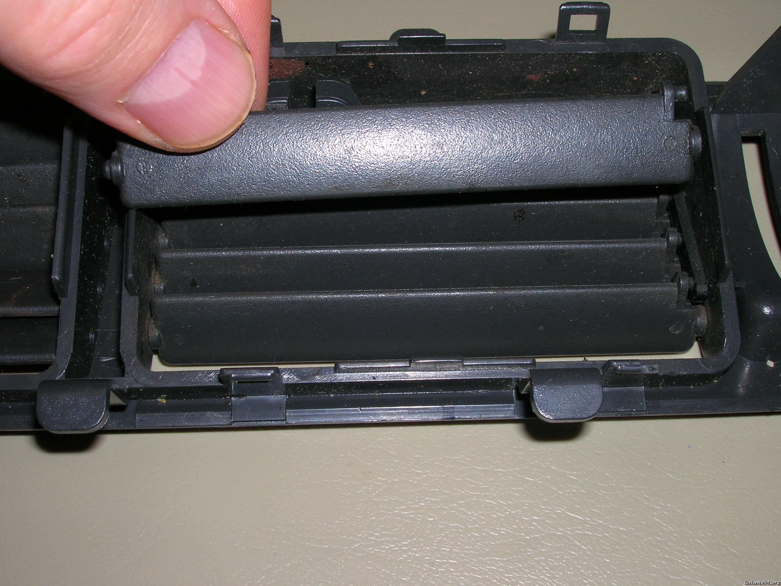

holeshotmoe
Apr 7, 2005
1,298
VA
If you are very very careful you can replace the louvers without pulling the housing. I replaced a few of mine using louvers from spare side vents I had sitting around. Forget which side...but maybe both side vents are needed. Yeah, I think the center vent has two different length louvers. The L/R side vents supply the replacements. I'll try to post a shot of the louvers themselves and you'll see that you can slip one end into the hole, carefully bow it just enough to get the pin into the other end.

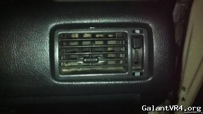

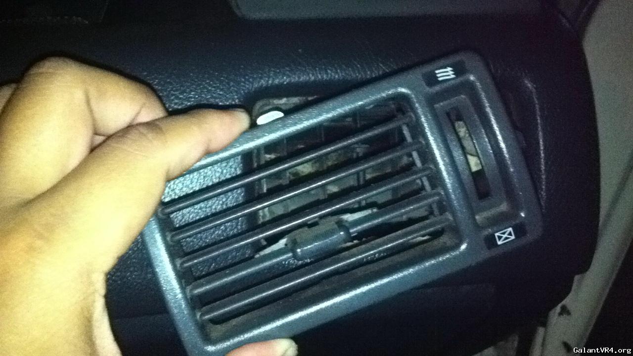

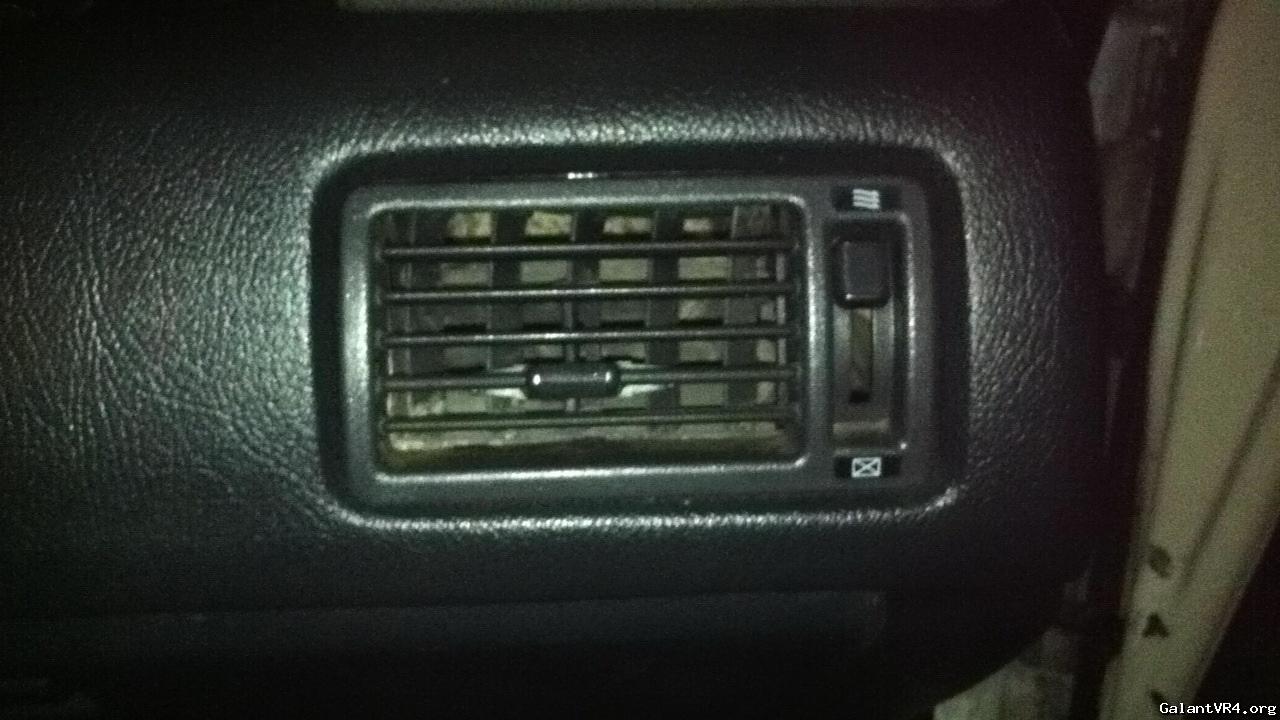

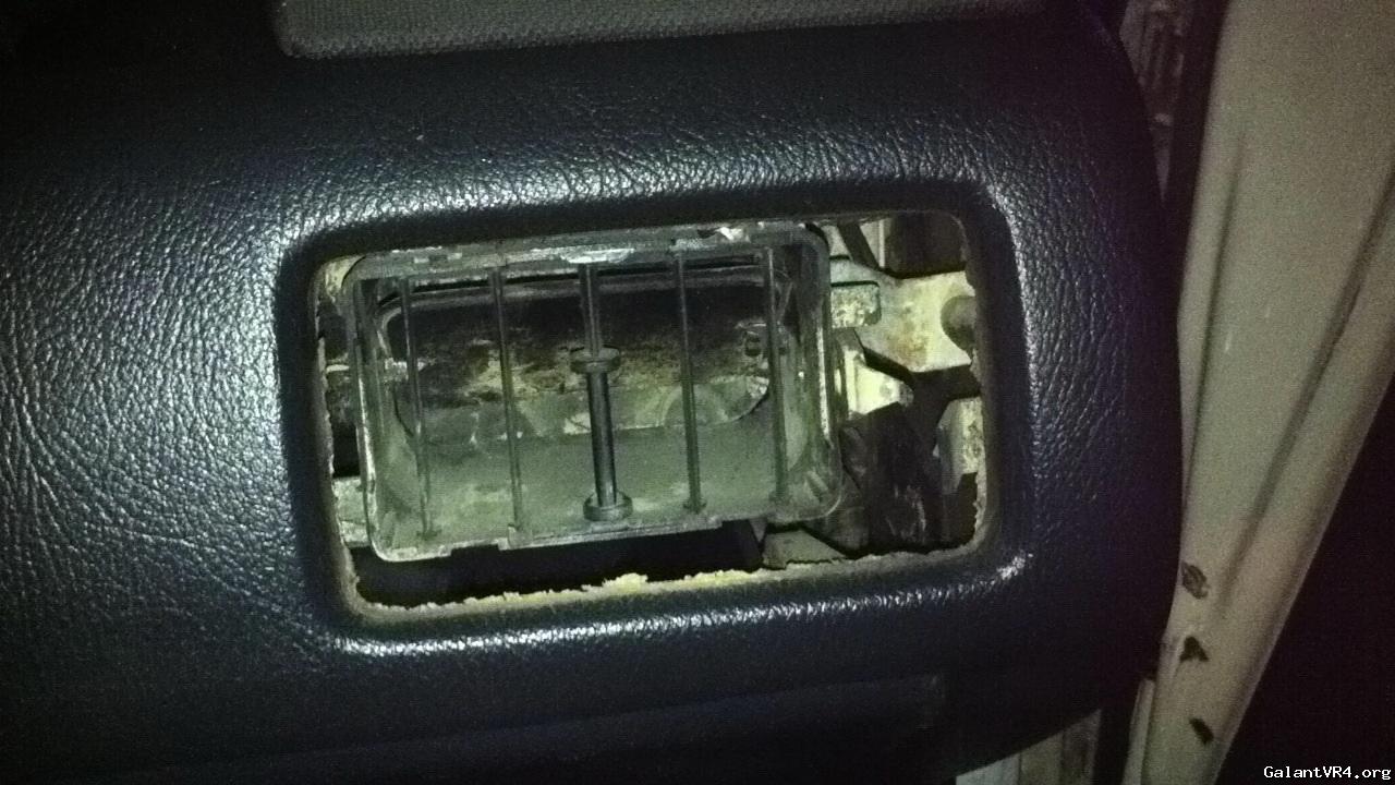

supa_saloon
Oct 9, 2011
104
Rodriguez, Pilipinas
Hack job from a friend.
He used some sot of gum looking adhesive on the sides to make sure it's a snug fit
it's shitty, but served it's purpose. /ubbthreads/images/graemlins/grin.gif

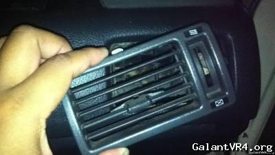

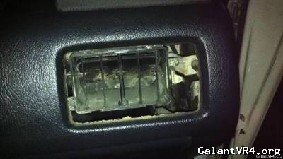

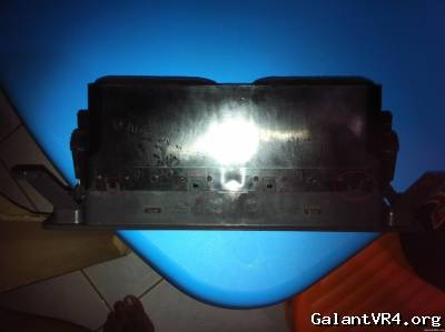

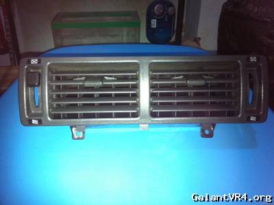

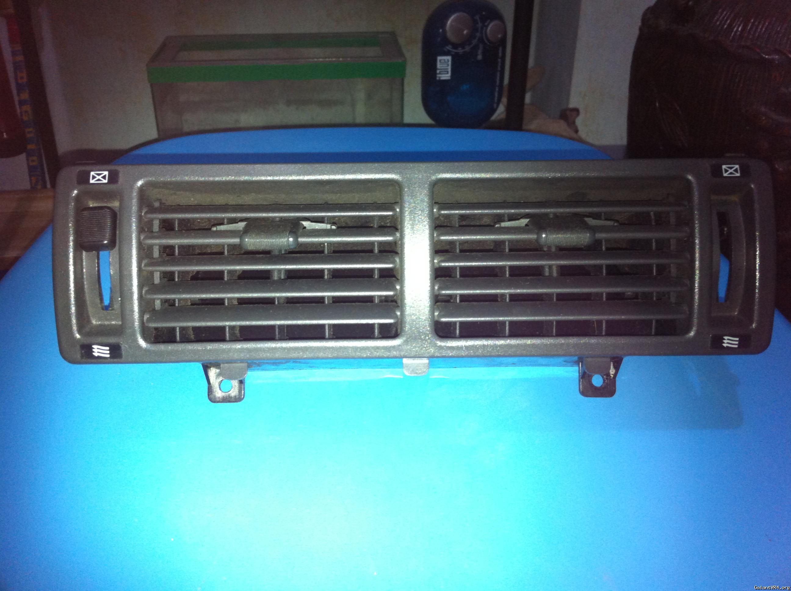

supa_saloon
Oct 9, 2011
104
I bought it from citymunky and they came like this

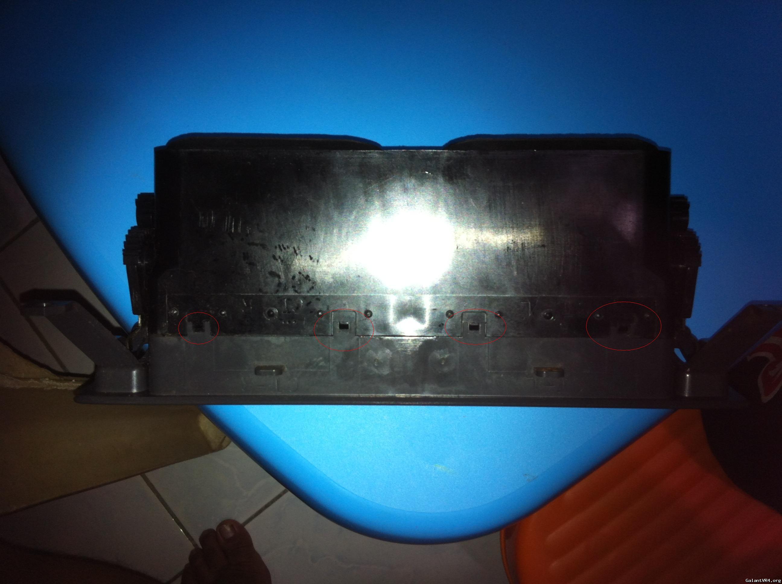

Separated the front part from the rear part, they are held by the adjustable tab in front that adjusts the opening or closing of the vents, and some small tabs on the inside, i think there' a few for the center
Removed the one that needs to be replaced, careful because some small chips may fall on the inside, you may need to totally crush them and have the new center vent snucked in.
See to it that the other tabs wont get in the way for the whole thing to go inside, you may need to remove those small tabs too.
holeshotmoe
Apr 7, 2005
1,298
VA
Here's a shot of the back so you can see what you have to achieve when you install them from the front side.
