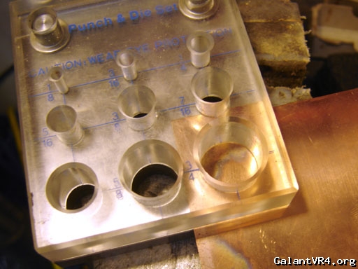

If I HAVE to make my own I was going to step up and make a punch and die system that will punch all of the holes out on location.
I was thinking something on the order of this but with holes that correspond with the gaskets.
