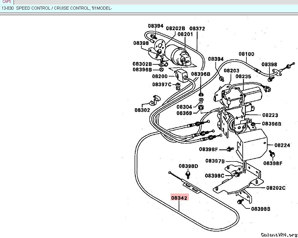

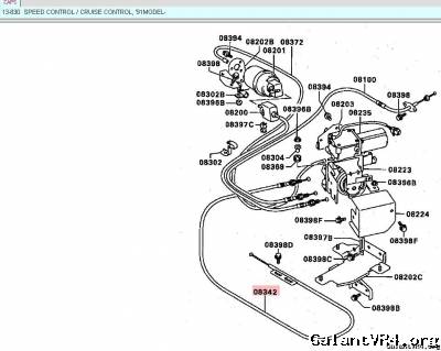

Found this thread in a search for +throttle +cable - funny it has just been revived - now i won't get flamed for bringing it back from the dead.
My car sat for many years, and amongst the various harnesses/connectors that rodents chewed off, my cruise>throttle cable was also damaged. I've searched all around and can only find NON-cruise throttle cables available. I would very much like to keep my cruise.
Anybody know the part number for the cruise>throttle cable? Please please please!

Hi Rich & G,
Thanks for all the info. You are right that the controller must match the actuator. I would prefer to utilize original wiring and get Mitsubishi parts. However this will be a last attempt to bring clarity before I resort to aftermarket alternatives.
For actuators, there are 2 options, i.e. as you specified, vacuum based or electronic. And there are part numbers for each sub component (please refer to the links below). Is there not a single part number for complete actuator with all its sub components because arranging for all sub components will be a nightmare!
The info I found on the web is conflicting. Both for E33A-SRGM 2:
a. MB488441
b. MB539368
This is further getting me to think about aftermarket option.
Of the after market ones there is two options:
a. Rostra (posted by G)
b. Some German universal kit (can't find the name now). Model is something like MS-50
I hope both universal kits will allow me to use stock cruise control switch next to the windshield wiper control. Will appreciate if you can recommend and help me make a final decision.

I will check out the numbers later and post them up.. the year breaks is what you need to pay attention to.
I understand the want to use original parts. As for the cable, don't worry you can hyrid a LHD cruise cabe and a RHD non cruise cable.
Aftermarket would hurt my hea and I can't understand why the king of "it's not original" would be a proponent of an aftermarket setup /ubbthreads/images/graemlins/wink.gif
Hold on a bit and I'll post back before the end of tomorrow.
