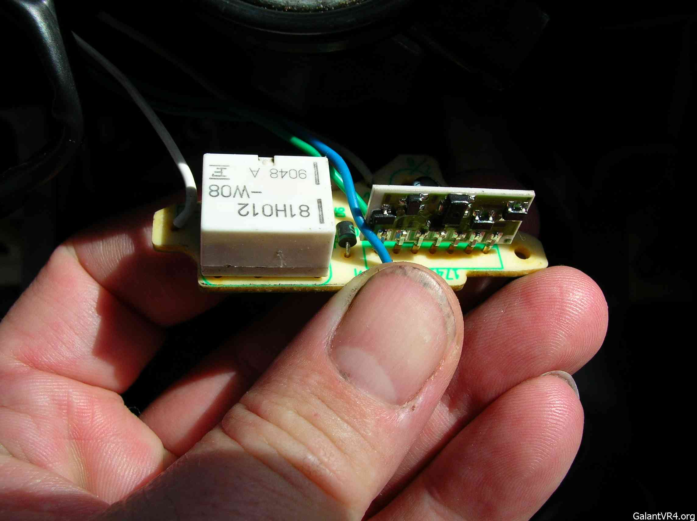

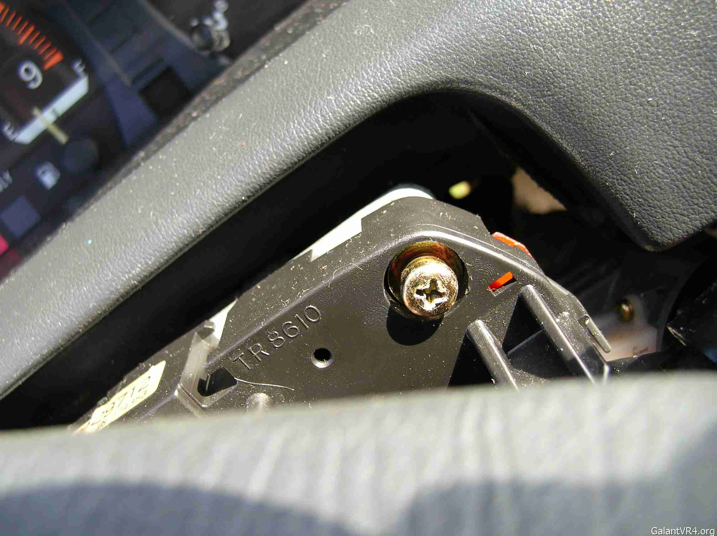

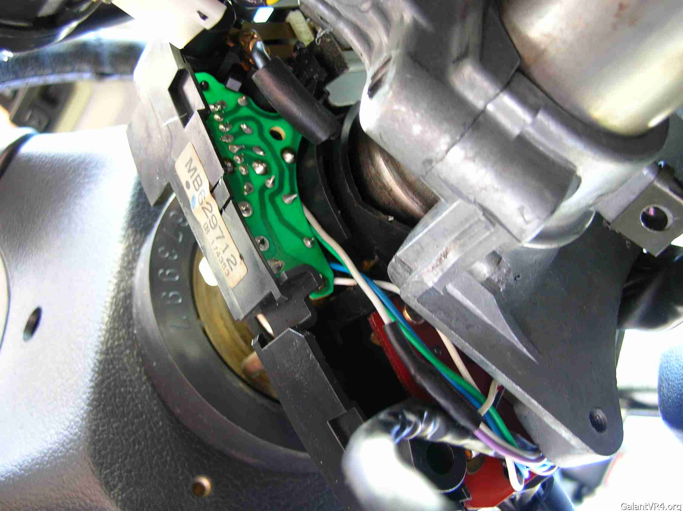

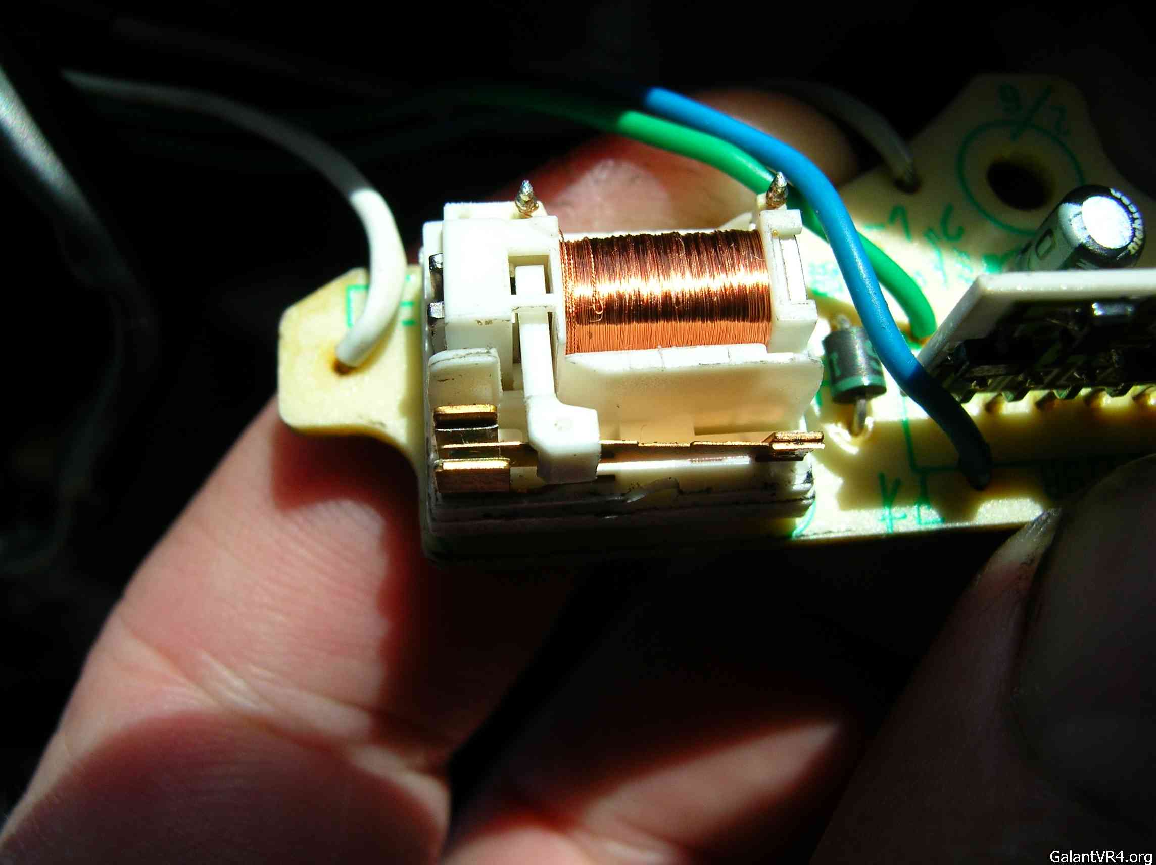

I can add some pictures:
After you remove the plastic shields under the steering wheel and surrounding the column assembly, you need to rotate the steering wheel, to get at a few screws that hold the assembly in place:
Here's a picture of the whole board, as it is installed into the column switch assembly:
This is what the board looks like once removed from the assembly. The relay in question is in the lower, lefthand corner, with a white plastic cover:
Here's what the relay looks like with its cover removed. If you have a small file, emery board, or some sandpaper, you could try just cleaning up the Common and Normally Open contacts, which are the ones that get pitted from repeated use:
