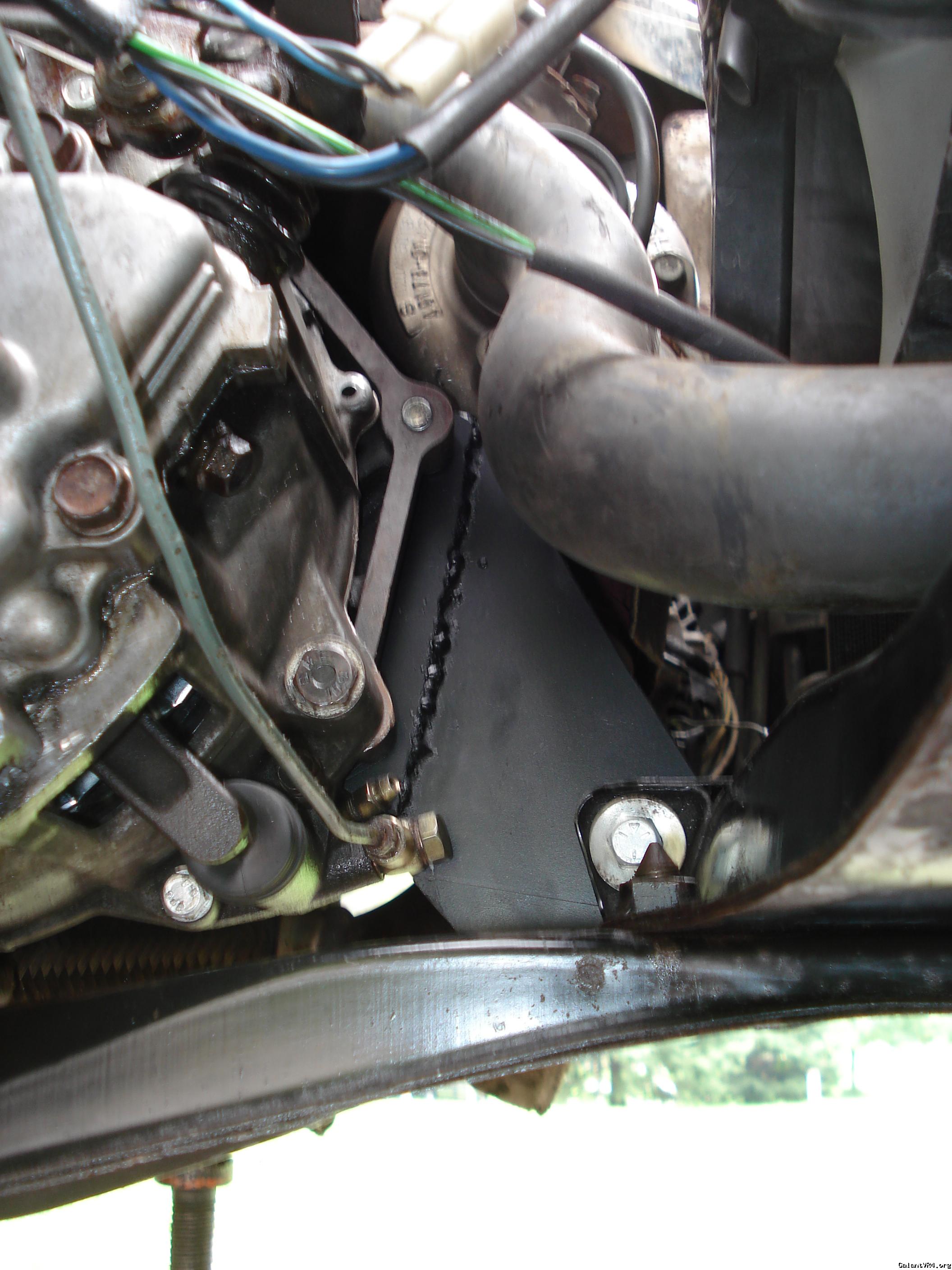

my 2.4 stroker is a 4g64 block on a 4g63 head, just i lost my front engine mount and had to fab one up from scratch.
