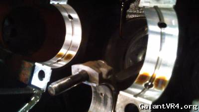

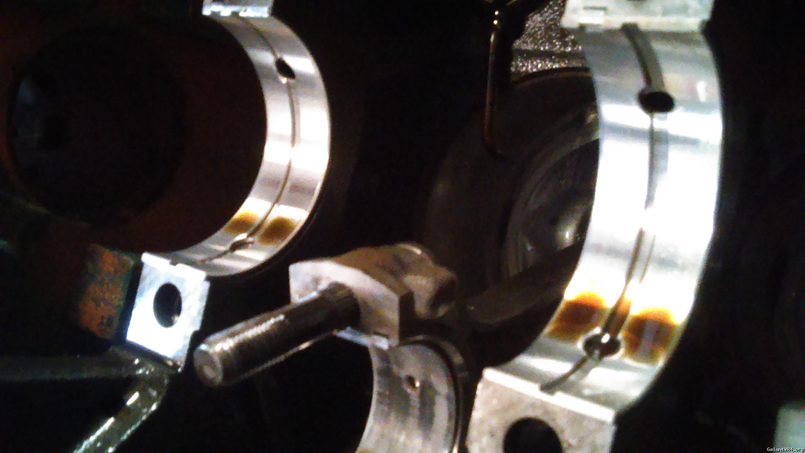

The crank is scored and groovy. Crank number two is at the machine shop for a polish and clean. Probably worth the $86 in hindsight. Keeping my fingers crossed, because I only have one more spare 6 bolt crank laying around the shop after this one.
The bolts have been torqued a (guessing) minimum of 4 times in the past. Once when it was built, again when someone else was in there and removed the balance shafts (maybe), two more times when I plastigauged it and assembled it, and who knows besides that. I'm leaving the head on for this procedure, so not dealing with head bolts at least.
I've assembled a bunch of engines in the past, and this is the first one I know of that isn't still running to this day, so I'm feeling a little befuddled. This is the first time I ever skipped having the crank looked at by a machine shop, and inevitably polished, but it looked so good I assumed it wasn't that important. Perhaps I put a nick in one of the thrust surfaces and simply overlooked it.
The mottled look of the rod bearings has me wondering high spots on the crank, low oil pressure, too much linear movement of the crank, or what?
Ps. Sorry for the horrible photo quality.

Hard to see anything in that pic. I've rebuilt engines without having the crank polished before with no ill effects.

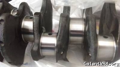

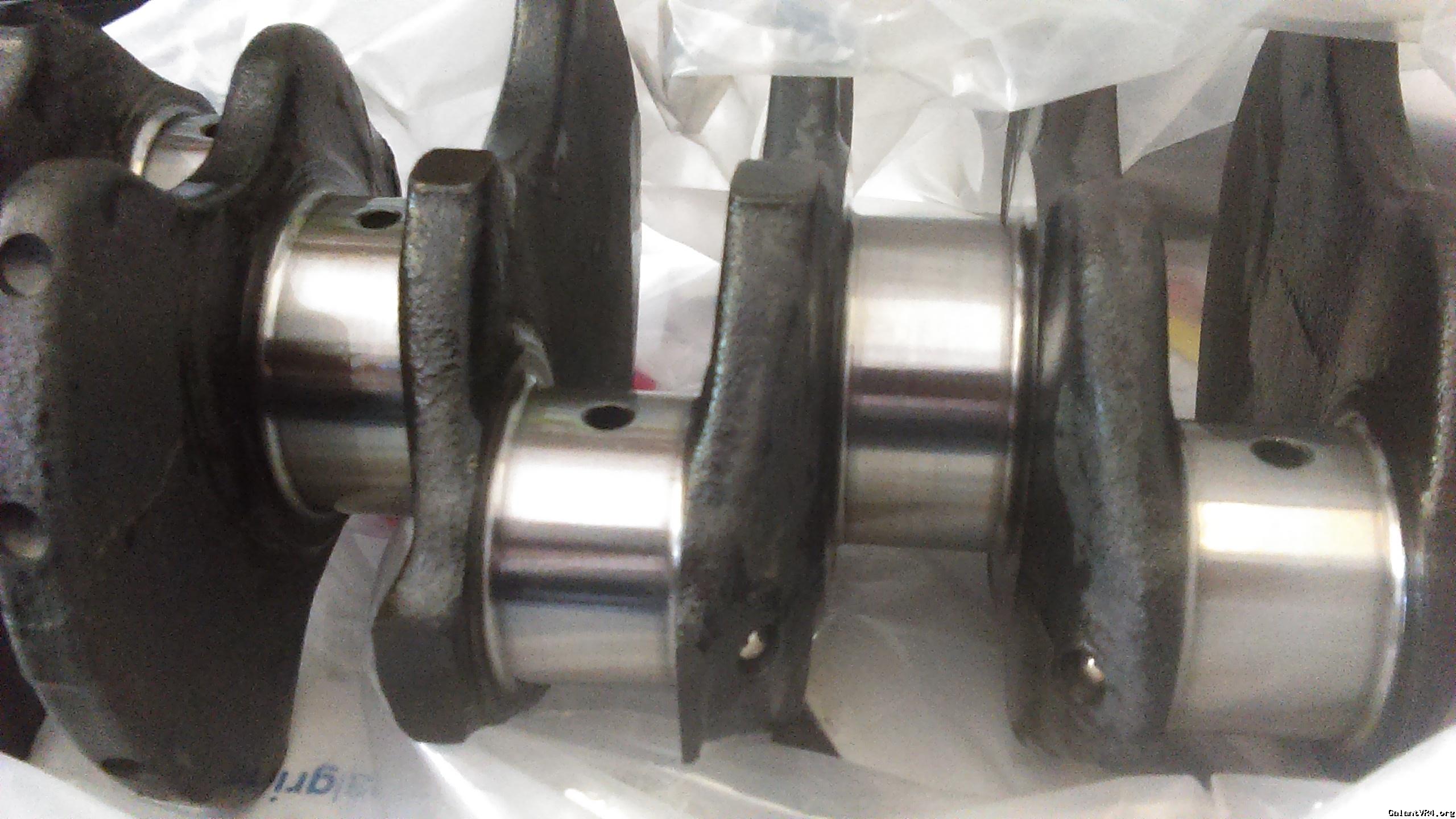

Factory nitrided crank #2 polished and ready for action. Machinist said, "That is some hard material!"
