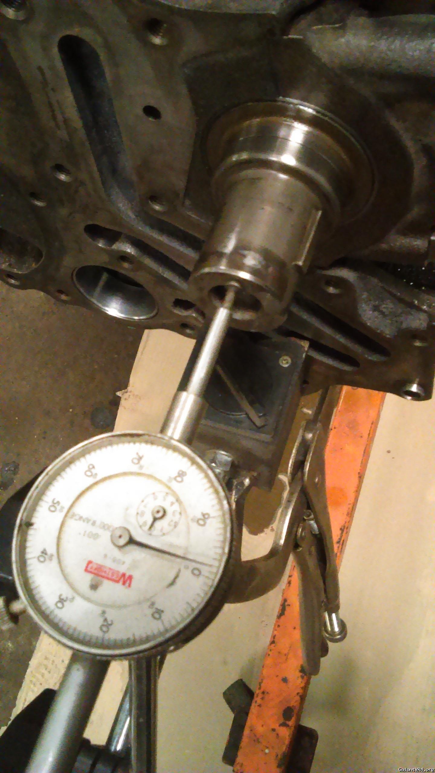

I just drove my Galant 1000 miles last weekend, and was super stoked that I didn't burn a drop of oil (new pistons). Then yesterday I started noticing an RPM drop whenever I push the clutch. By the end of the day the RPM drop was joined by an illuminated oil light. On my way home, the engine began to stall whenever I push the clutch to come to a stop. Starting to hate this damn car. /ubbthreads/images/graemlins/banghead.gif
Thoughts or insight?
Coltsfan
May 4, 2014
200
Tonawanda
Still full of oil. I just put a pry bar against the harmonic balancer, and I want to barf, or take up hard drugs.

So last Sunday I crashed my downhill bike really hard. I think I separated one of my ribs from my sternum, and now I have 1/8" of friggin' crankwalk. When I sneeze it feels like I'm taking a baseball bat to the chest.

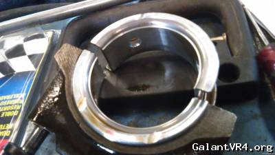

Post up pics of bearings for us to look at.

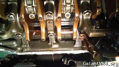

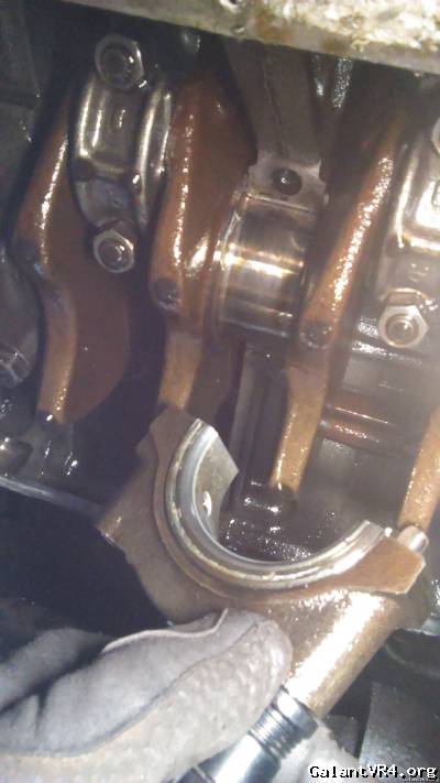

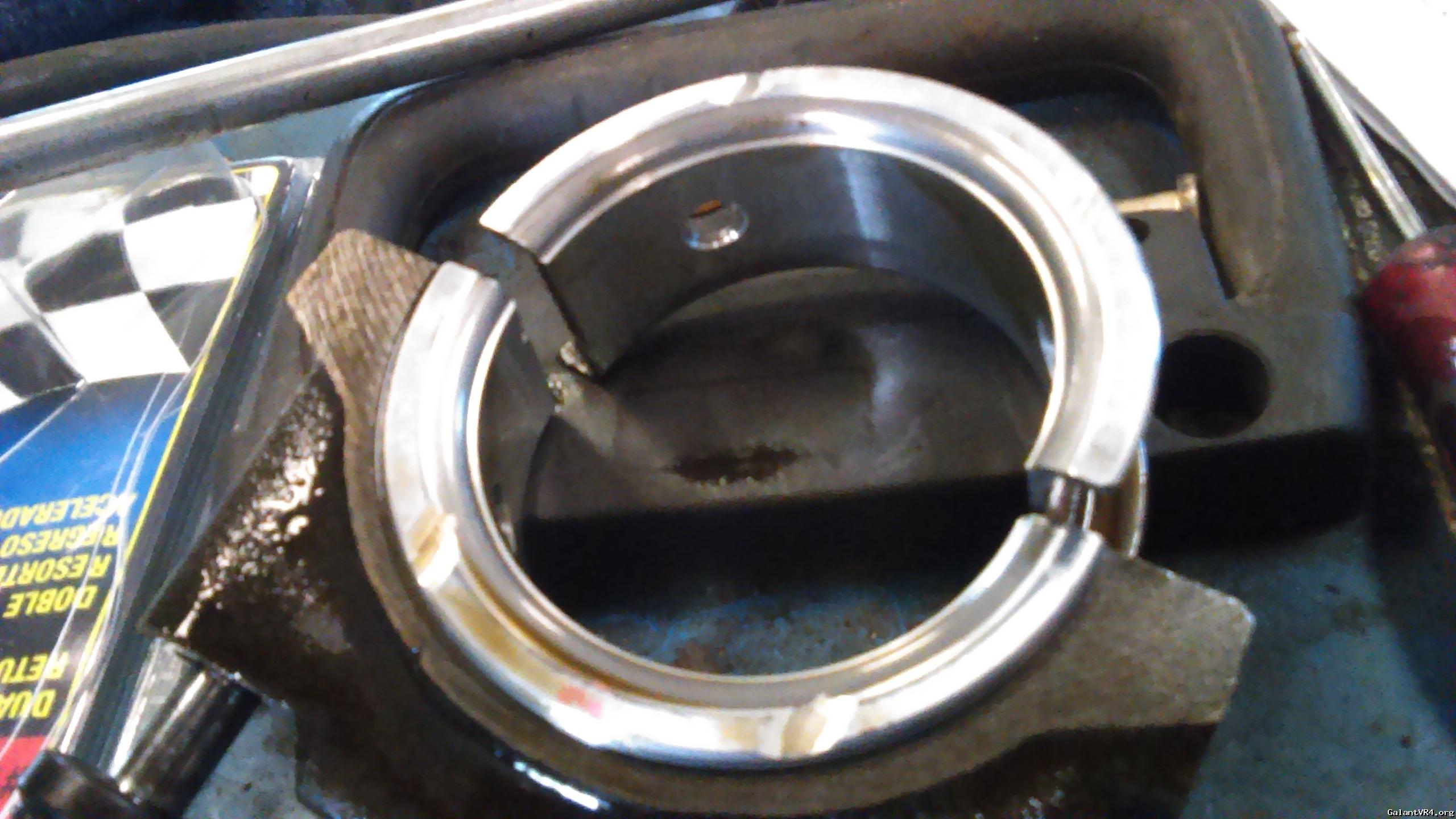

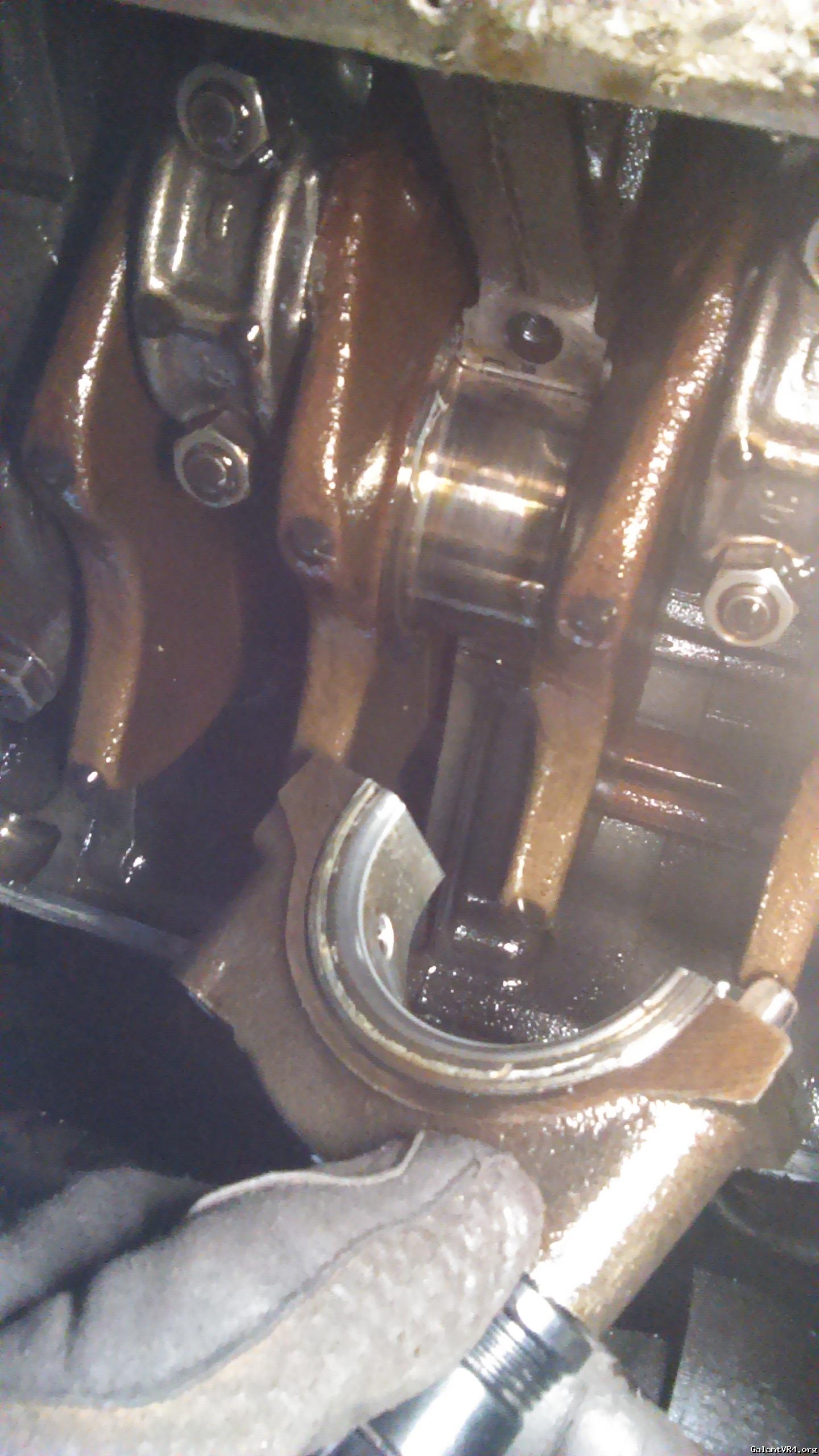

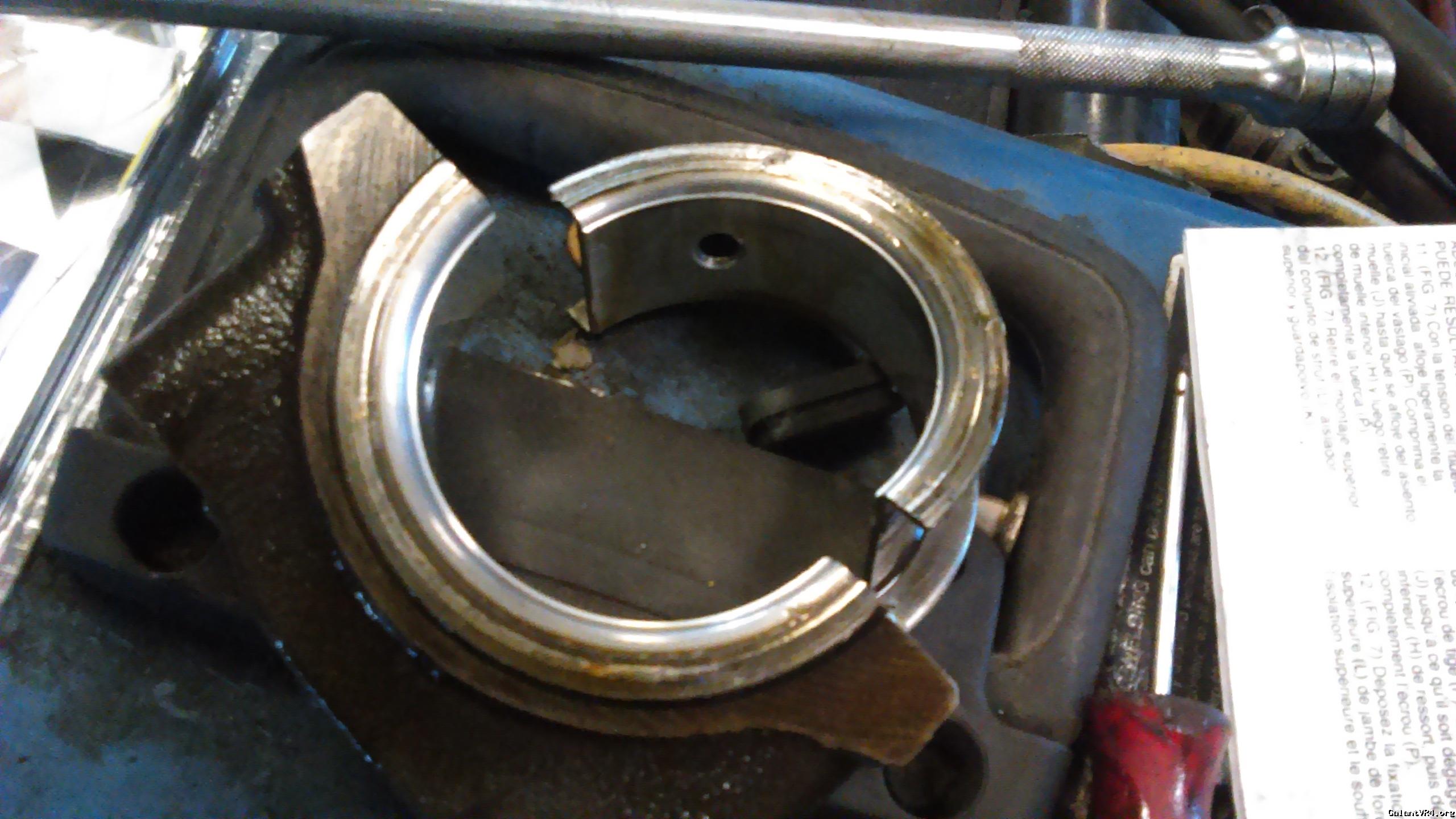

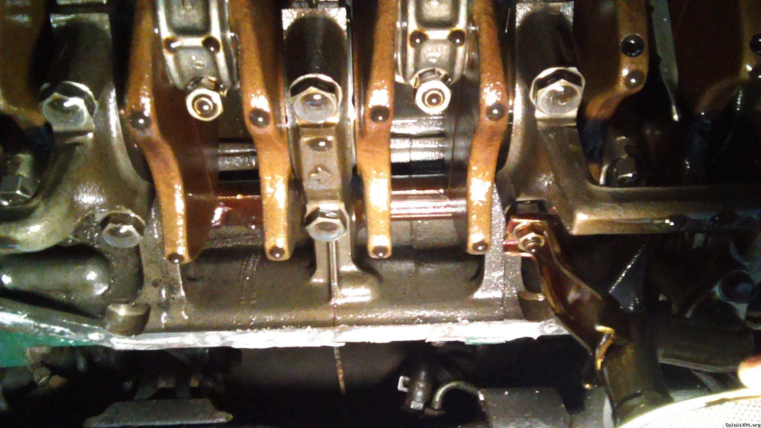

I wont swap main caps, I know I can't do that. I was referring to the used bearings. It's going to be days before I see a new set of main bearings for this thing. Stores don't even stock wheel bearings for this car.
I'm working my way around the oil pan with a putty knife now. Pics to arrive shortly.

That crank looks mighty old there buddy, you ensure it was safe to still use before the new bearings?

That looks like a dry bearing to me, or contamination of the bearing surfaces.
The oiling channels in the crank should be cleaned out very well, in fact BogusSVO did a write up on it and how he removes the balls in the counter weights to clean the crank out.
