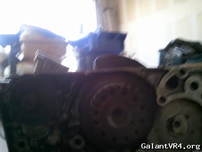

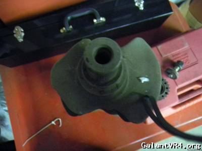

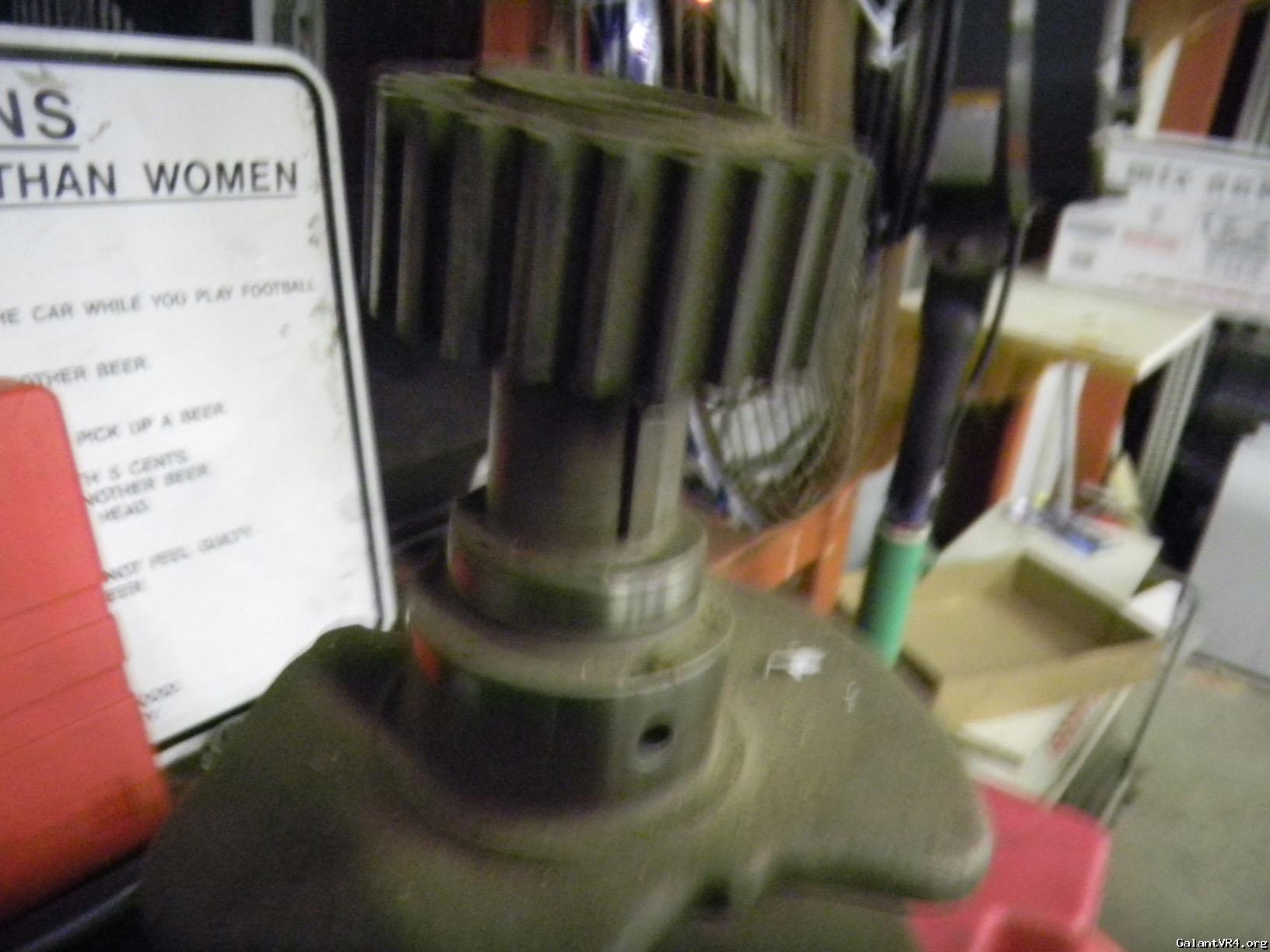

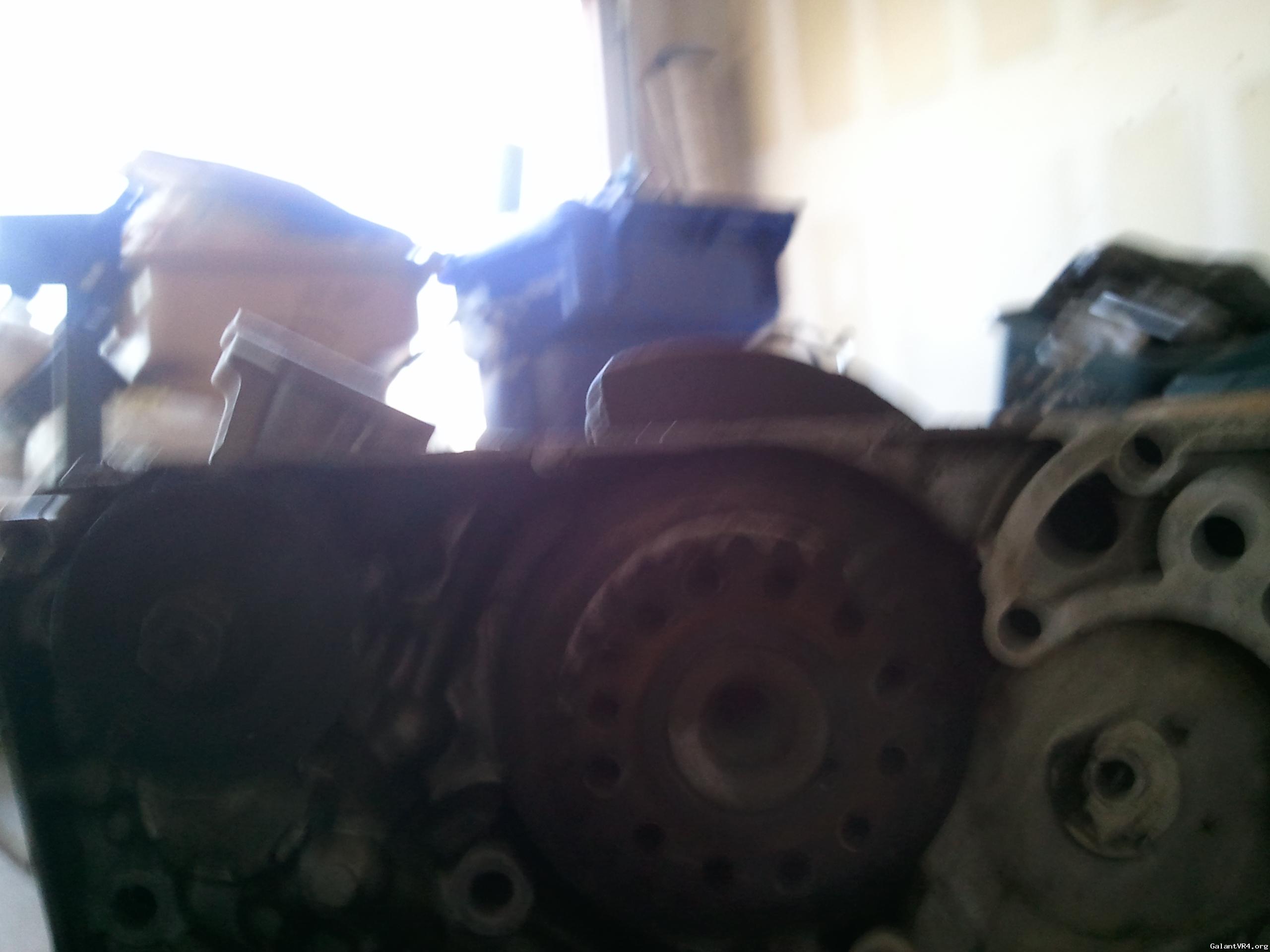

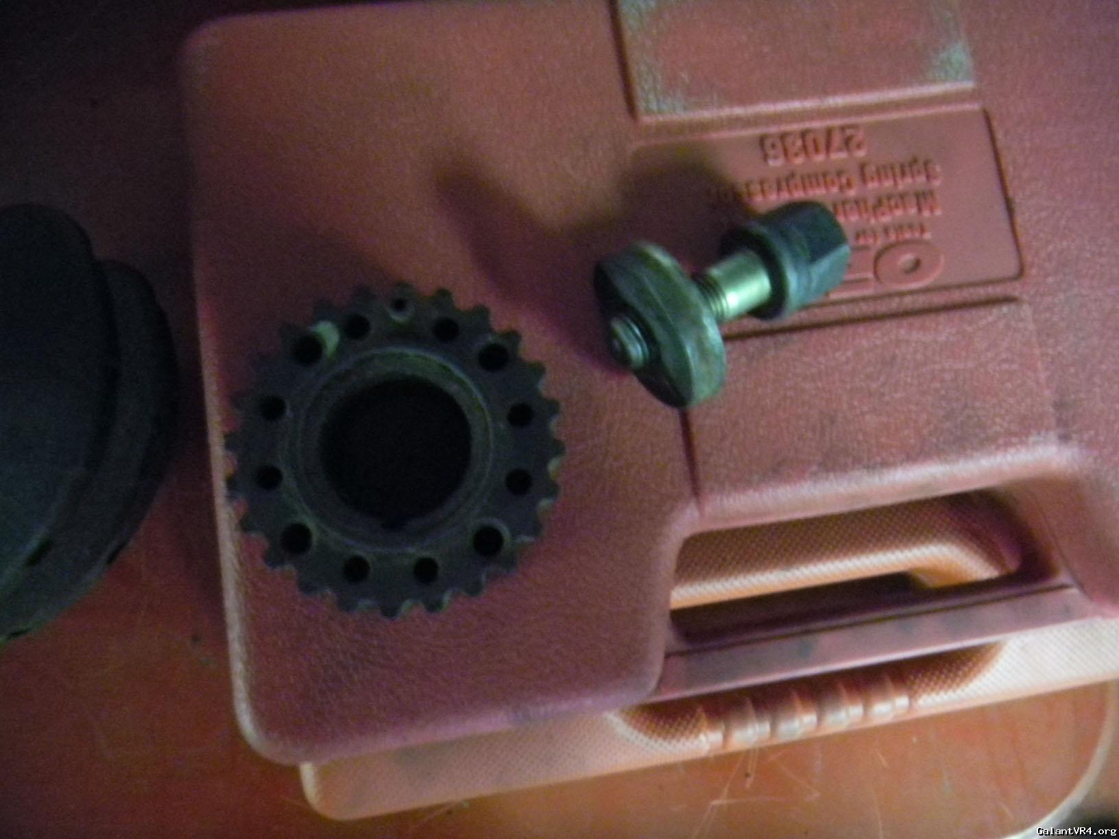

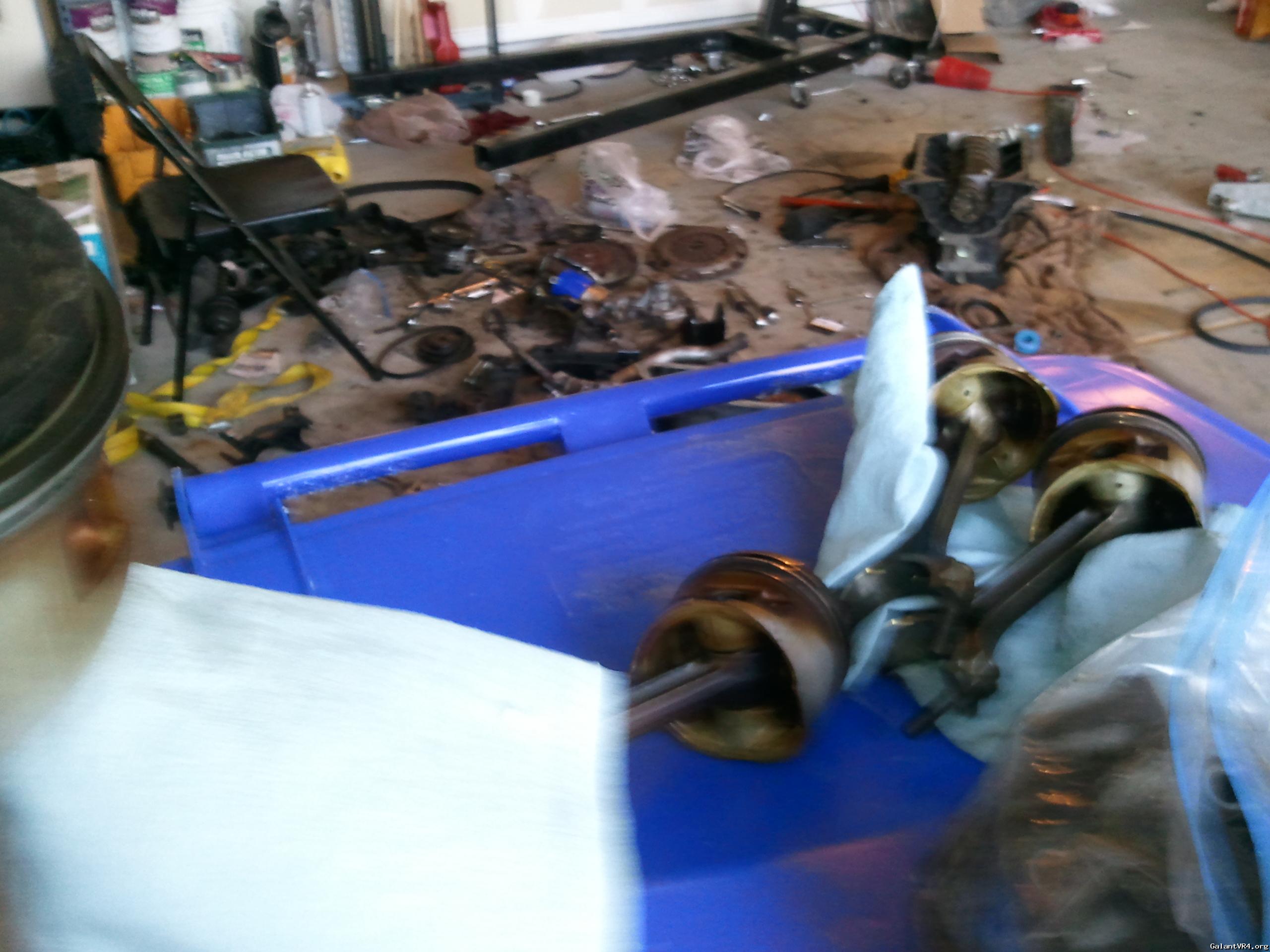

HEllo all and thanks for any help as some of you have read in prior posts that I did find out what happened to my motor. It seems that I spun a bearing and it was bad enough to break the bearing and overlap its self thus causing it to cease. The crank has deep cuts in it and I dont think it can be repaired so its gotta go the crank bolt is out as are all the other bolts but the crank spocket wont budge is there a special way to remove it so the I can drop the block off to be cleaned and get the rods and crank kit going ?

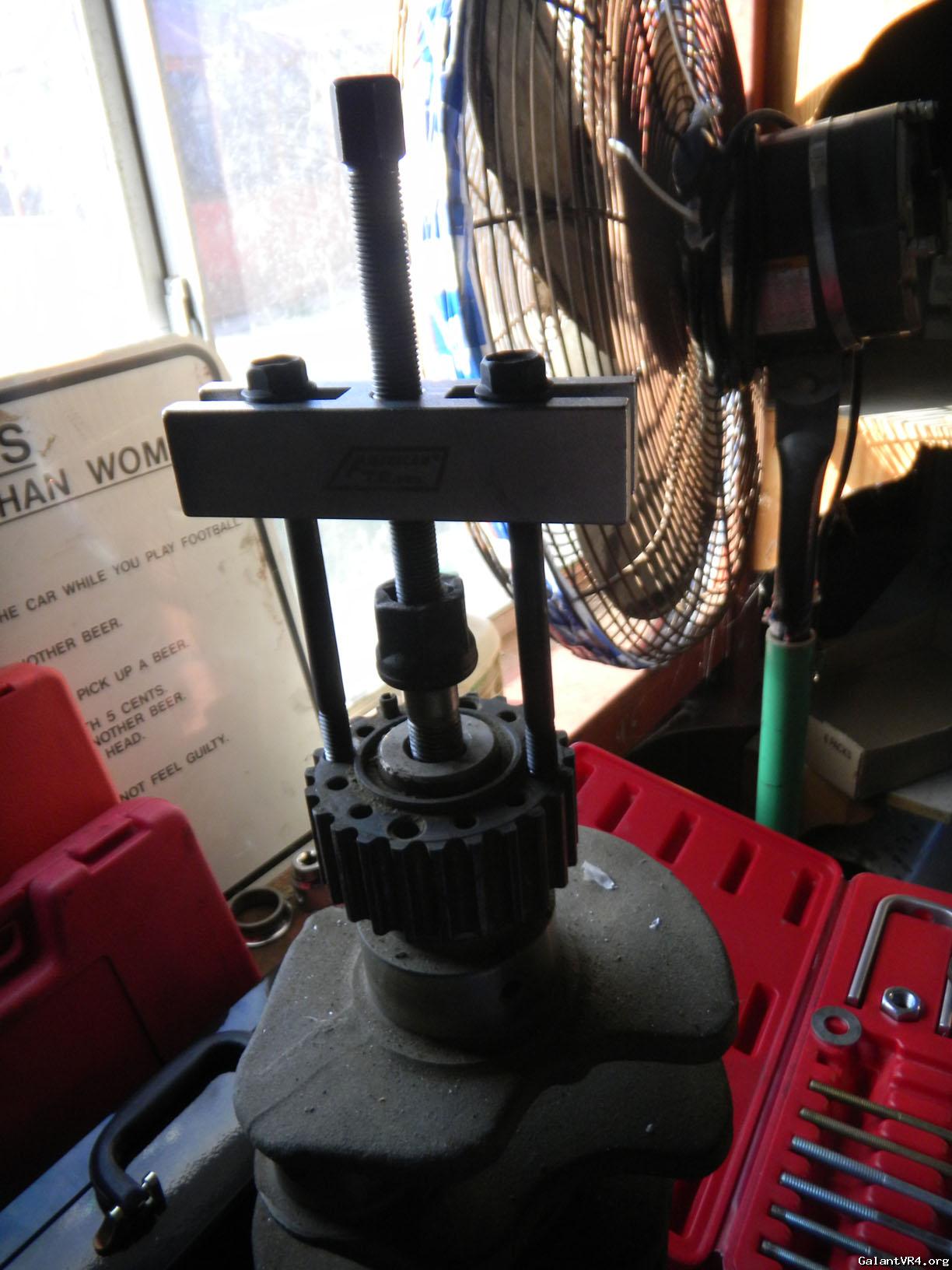

The crank sprocket is keyed and you may need to put a pulley puller on it.
edit: sorry for the fuzzy pictures, i need to get a new camera....

Drdamm21,
Were you able to get the sprocket off? Or do you still need assistance?
Edit: Here is what I would do if i were you.
This is your average steering wheel puller. Basic Harbor freight issue.

On topic. Why not just get a new sprocket while you're at it? They're not very expensive.
vapid

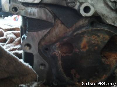

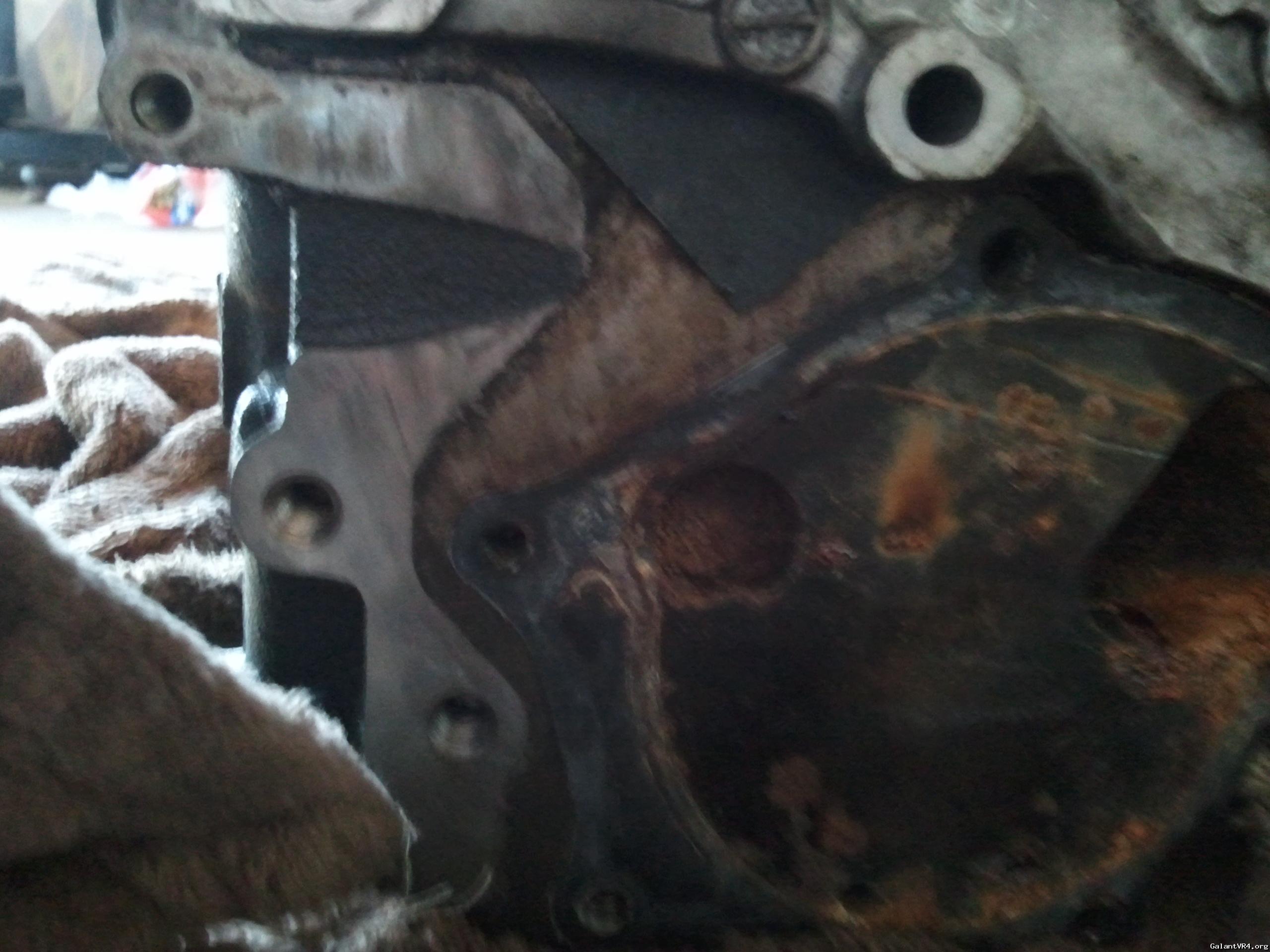

I believe he needs to pull the sprocket to get the front case off. He wants to re-use the block and I don't think the oil seal will clear the sprocket.
vapid
Sep 24, 2005
918
IL
Sorry, I didn't realize he still had balance shafts, I thought he could just drop the whole thing. Long night.
YEs the ballance shaft is there but was not being used but yes I need to bet the damn front case off and remove the messed up crank so I can have the block acid dipped
