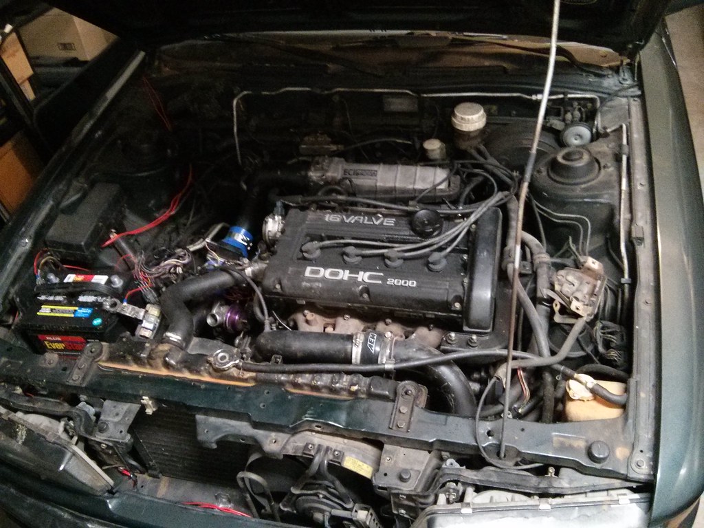

I'm brand new to Mitsubishi's and VR4's so I apologize if I'm asking something stupid. I can work on an F-15 but I don't know much about what I'm doing with cars. I did try to look through the documents and different manuals and that kind of stuff. All the codes and terms don't make much sense to me yet so I'm not really sure what to look for. I did a search but mostly come up with for sale posts.
I just got a VR4 a few days ago and am starting to get things in order. The cooling fan went bad I guess, and the previous owner hooked up a new one. Problem is, he left the old bad fan still hooked up, and just added another fan and wired it up pretty weird. Old fan is mounted in front of the radiator on the drivers side. New fan is mounted behind the radiator on the passenger side. He wired it up to the old fan and to the battery and has a switch inside to turn it on and off.
First order of business is to get that old fan out. Problem is, I'm not sure how to do that. I removed the parts from the hood latch and around that area to try to get it out. It's currently unbolted and just sitting in there, but there's not enough space to slide it out. I'm assuming I need to take out the radiator to get the fan out from that spot. I wanted to make sure I'm not missing something stupid, or if that's the real way to remove that fan.
Thanks in advance and sorry if it's a dumb question.

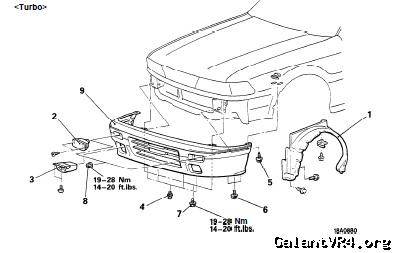

removing the bumper might be the only way to go...

I wouldn't say it's a giant intercooler, but it's fairly large. The bumper is currently already off though, and it doesn't really help with removing the fan.

Stock, these cars have two fans. One puller that sits behind the radiator in the engine bay on the passenger side, and one pusher mounted on the front of the AC condenser right behind the bumper on the driver's side. Are you sure that old fan isn't just the stock pusher fan that comes on with the AC? You can't really mount the stock puller fan in that location, as it would never fit with the shroud, amongst other obstacles. Sounds like some confusion between you and the previous owner.

Ah I didn't know there were two fans. I should probably check and see if both work. From what he said it seemed like the pusher fan went bad and he added the puller fan in just to get it working.
