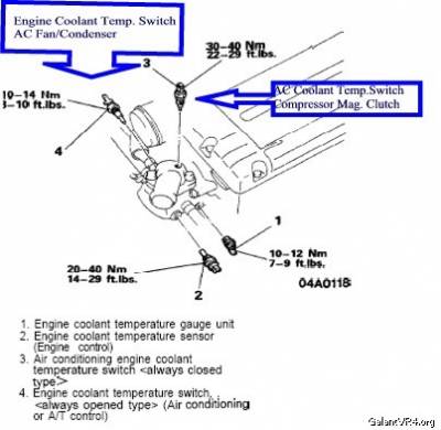

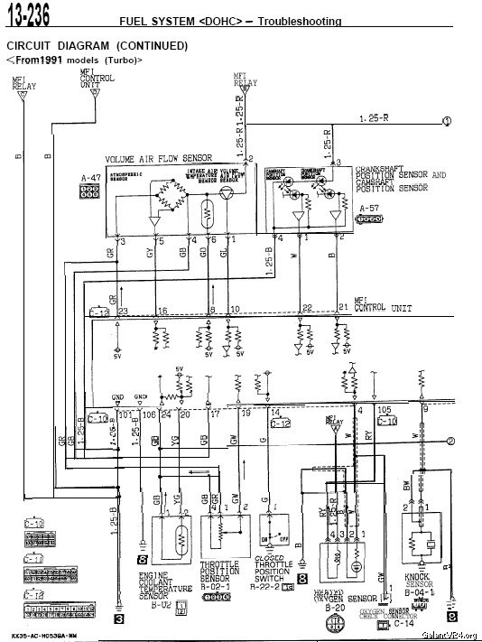

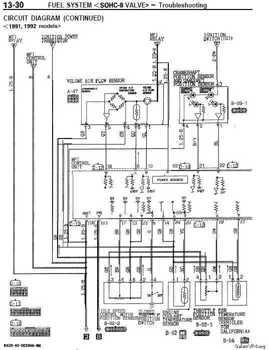

Just checking: that diagram is for a SOHC 8V. Doesn't he need the one for the DOHC 16V Turbo?
Anyone know the thread pitch on the front sensor with the one wire for the dash gauge?

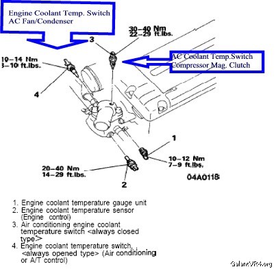

When I first put my GVR4 together I got the wire that goes to the single terminal connector on the back of the T-stat housing and the one on the front of the housing mixed up and switched them. I had the same problem as you're having. You have to make SURE that you don't have those two mixed up. Also, it looks like that diagram only has the one for the ECU's coolant temp sender, not the single wire one that goes to the gauge or the single wire one that turns on all the cooling fans in case of an overheat.

Just looking at my wiring diagram, I see that the green with black wire goes to ECU pin 24 and gets its ground from inside the ECU. I'm picking that you had a short somewhere before you found and repaired the wires which burnt the trace on the ECU circuit board from pin 24 to ground. If you feel inclined, pull the ECU and check, bridge out any burnt trace with a bit of wire. Otherwise grounding externally is probably OK, but may allow some slight errors due to current flow in the ECU ground.

Anyone know the thread pitch for the #1 sensor in that diagram...for sure? I want to add an accurate guage there to replace the one in the dash.
The Green/Black striped wire is the SENSORS GROUND from pin #24 of the ECU. If you are NOT getting GROUND on that wire there is a good chance that you have a blown trace in the ECU. You should NOT connect it to a chassis ground, as that can cause a ground loop issue that will throw off your O2 voltages too. You need to see if pin #24 at the ECU is grounded or not.
BTW, that 2-wire sensor with the green/black and yellow/green wires on it has NOTHING to do with the gauge in the dash. It ONLY connects to the ECU so the ECU knows the coolant temperatures. There is another single-wire sensor, with a yellow/green striped wire on it that connects to the dash gauge. /ubbthreads/images/graemlins/wink.gif
