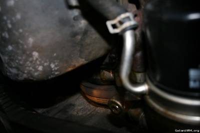

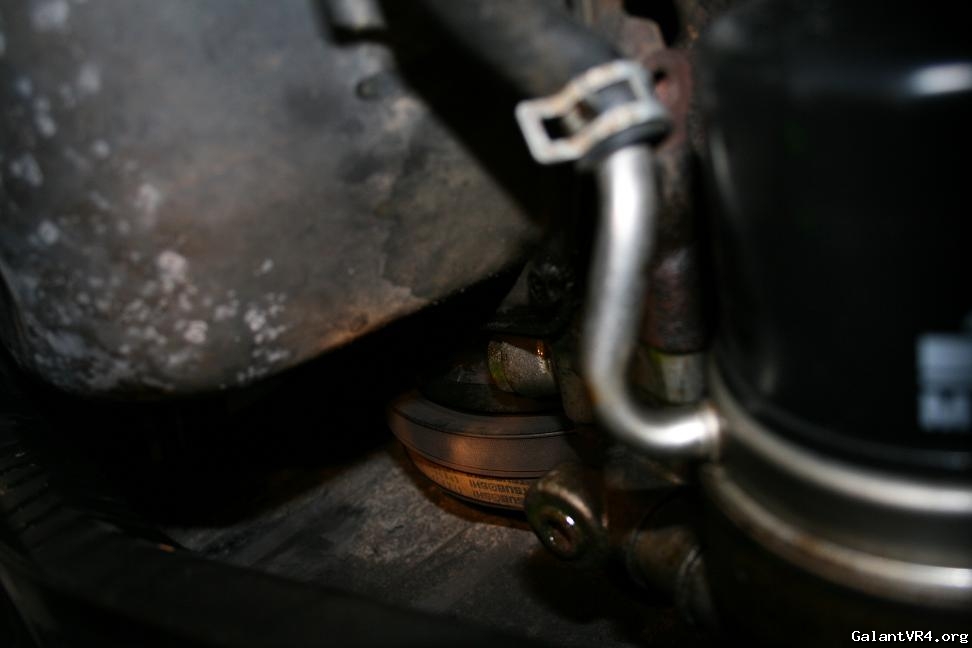

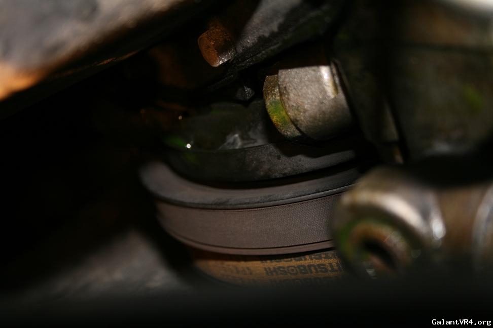

I changed the oil in the galant last week and noticed some coolant on what appears to be part of the housing and I believe the lower timing assembly adjacent to it. Not enough to really puddle, but enough to notice. I can't identify where it could be leaking from. Any thoughts? Within the past few days the car started to reach operating temp much faster than usual and it started to overheat just now as I pulled into my parking spot. For the past two winters it's been so cold that the temp gauge won't reach op temp while cruising on the highway. Bad T-stat? Old/low coolant? Haven't flushed it in a while...

The metal ring that has 2 steel nipples coming out of it, that is between the oil filter and the housing, is a water cooled "radiator". Are the rubber lines leaking? Is the "radiator" leaking?
The other thing it could be is the water pump. It sits directly above the oil filter. It has a gasket to the block that can leak. It also has a rubber seal that seals the water pipe that can leak. It also can leak at the water pump shaft.
Could be coming from a lot of places. Better get it fixed soon.

So it looks like the only way to diagnose it is to start taking things apart?
I'm thinking that it's probably the water pump. I doubt it has been replaced in 100k mi. If I buy a water pump from JNZ, I assume that it will come with all the gaskets and rubber seals that could be responsible (if it's not the pump itself)?

No, all you have to do is degrease/ clean it up real good, then get under it while it's running to see where it's leaking. If it's a big enough leak you may not even have to clean it first.

Yeah, I replace water pumps every time I do timing belts on these cars. The water pump (any I have ever purchased) comes with the gasket and the o-ring for the water pipe. I doubt either of those are leaking, I'm thinking the water pump is bad. Don't let it leave you stranded! I had 96k on my eclipse, original water pump, and I got stuck 3 hours from home when the bearings went out on it.
I vote water pump. Take the timing belt cover off and see if there is any pooling. That should either confirm or eliminate.

Like Vman said pressure test first, it is better to find out where the leak is than replacing water pump etc and still have a leak from some where else.
