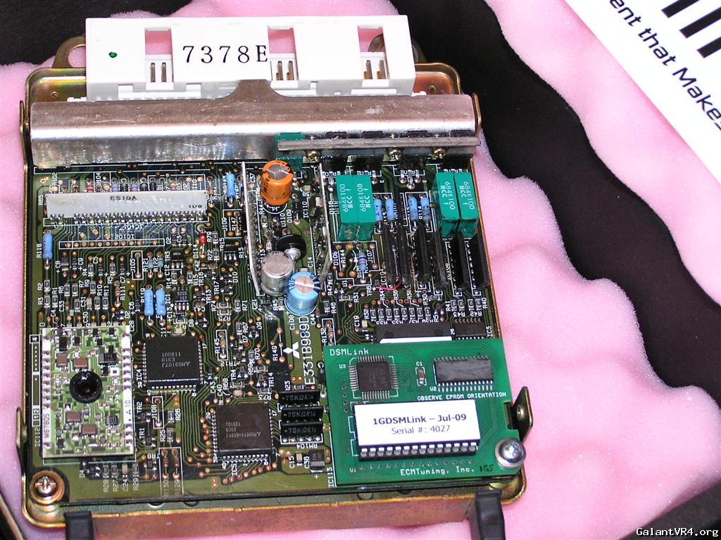

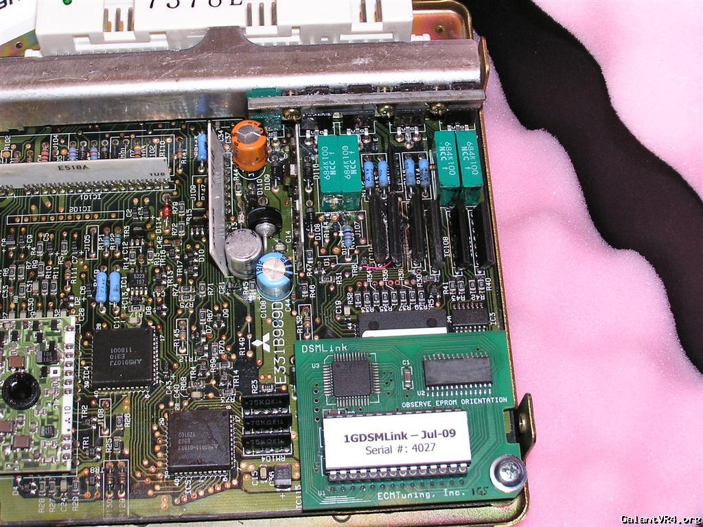

Got my ECU back from ECM Tuning today - all fixed up. They said it appeared to have actually been on fire - not just melted. I believe it based on the amount of smoke rolling out of the dash and the amount of soot on the board. They also installed an updated DSM Link Eprom for me that has all the latest bug fixes. They said the one I had in there was "REALLY" outdated. It worked - so I never messed with it. /ubbthreads/images/graemlins/dunno.gif
It cost me two hours of their labor time, but I am confident they went through it and made sure everything was cleaned up and working properly. Guess we'll find out when I get time to put the car back together.
Here are a couple of the "cleaned up" pics:

Sweet /ubbthreads/images/graemlins/smile.gif Dave does great work and it looks like you got your link updated too. Now get that thing back in so we can get the guys together again.

From the looks of the board around IC105 I'd bet that there are a few more wires on the bottom too.
Glad they could fix you up. I didn't think it was done for.
