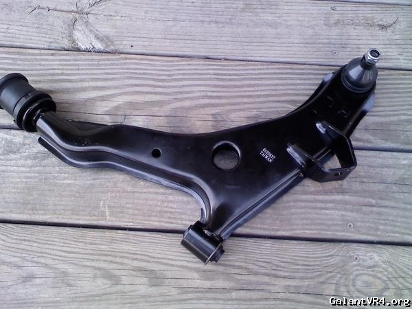

well i just picked up my new control arm today that i ordered from autozone.

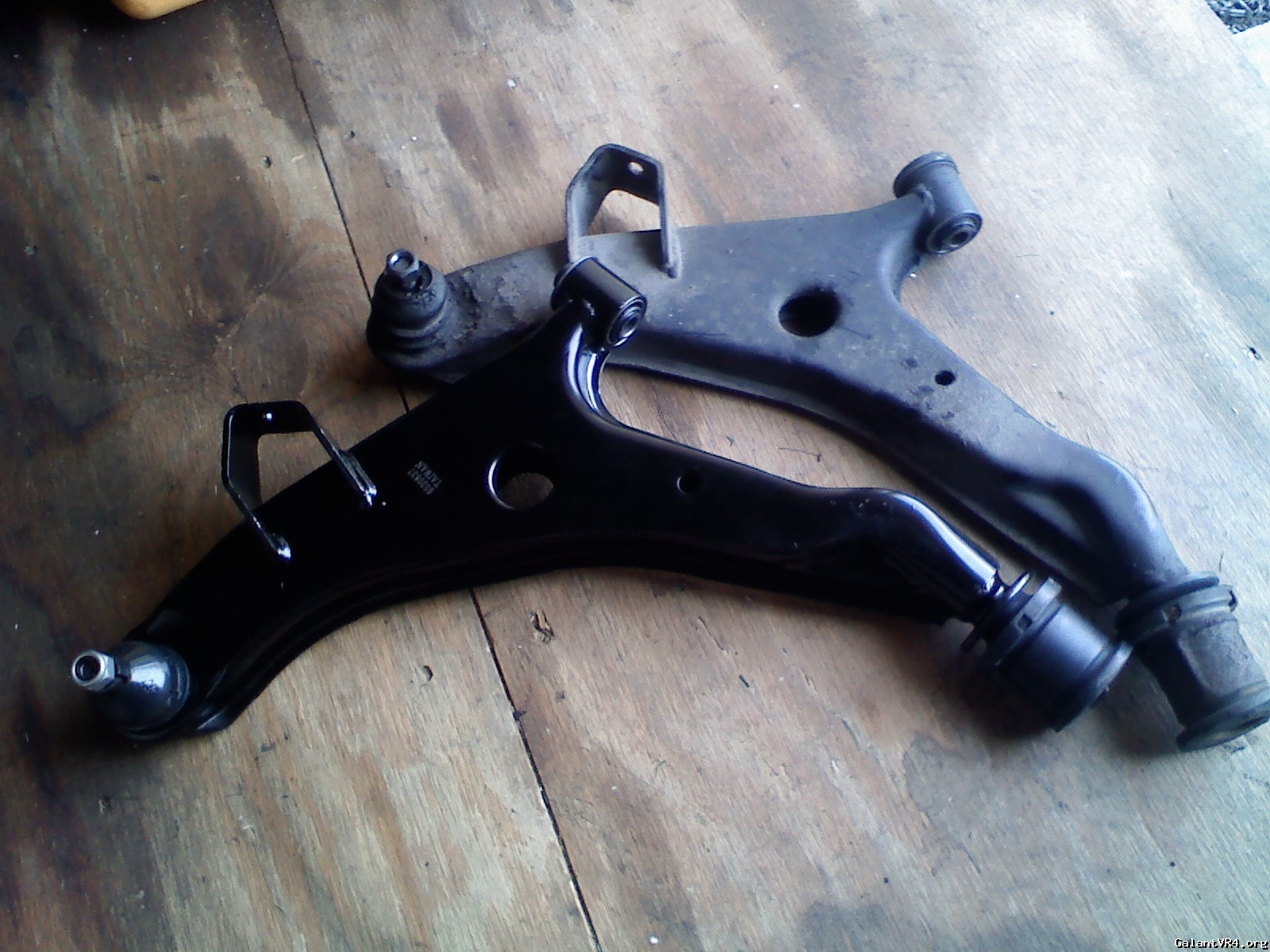

its made by Dorman and this is for a 1G AWD. Autozone does not have these listed in there inventory so i just gave them the part #520-837 and they price matched rock auto's price so i got it for $85. So anyone that needs to replace a control arm, this is the best and cheapest way to go instead of paying around $250 from Mitsubishi. It comes with a ball joint and compared to the old control arm i took out of my GVR4, the only difference is the bigger bushing is maybe 1/8" shorter but my old was is quite worn out

Looking good! Let us know how the fit and finish is on these with that bushing being a bit smaller.

Wait, isn't the rock-auto part the wrong part? If it's the one with the funny picture that doesn't match, it's actually the wrong part and they just have it inventoried wrong. If that's the case, then autozone is price-matching for the wrong part...WHICH IS AWESOME.
BoostedAWD91
Mar 1, 2007
2,937
Danville,Pa
rock auto's control arm listing for the galant is wrong yes, but this is listed under 1G Eclipse GSX or Talon Tsi which is what number i used for autozone to order and price match. Im going to install it either tomorrow or Friday, ill let u know how it fits

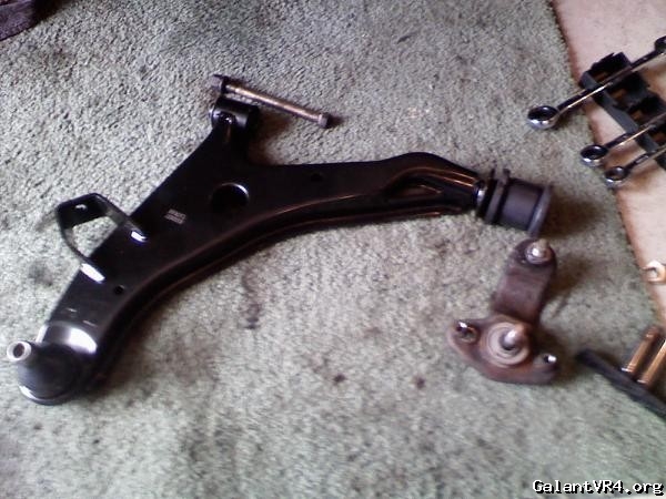

How to Remove the Control Arm
First you must remove the hub. To do this u need to remove the following:
Brake Caliper bracket (17mm), Rotor, ABS Speed sensor (12mm), Axle Nut (32mm), Sway bar end link (14mm), Tie Rod end (17mm), hub from the strut (17mm) and also break loose the ball joint nut before everything is off which makes life easier
Once the hub is removed u can start removing the control arm
U have one long bolt with a nut that is a 17mm that needs to be removed
Next u need to removed the U-shaped bracket. There are two 14mm nuts and two 17mm bolts
After the bracket it off u should be able to pull it right out.

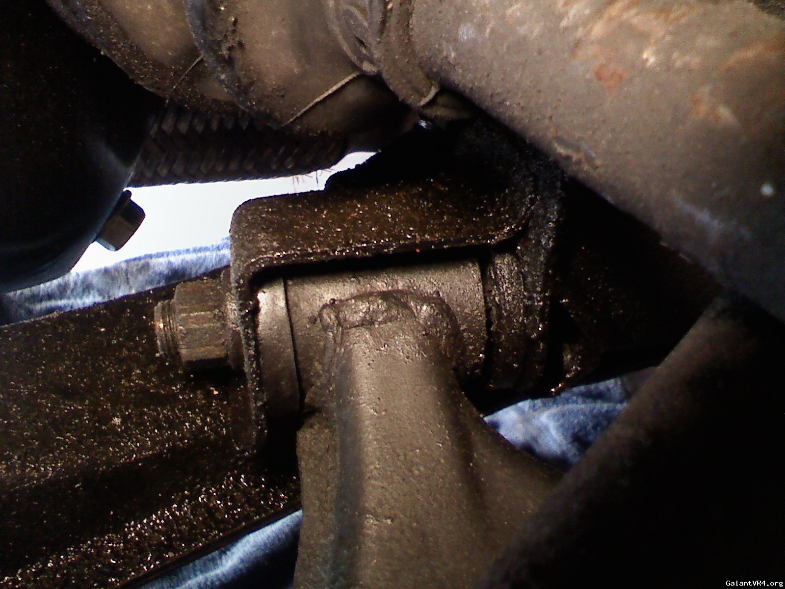

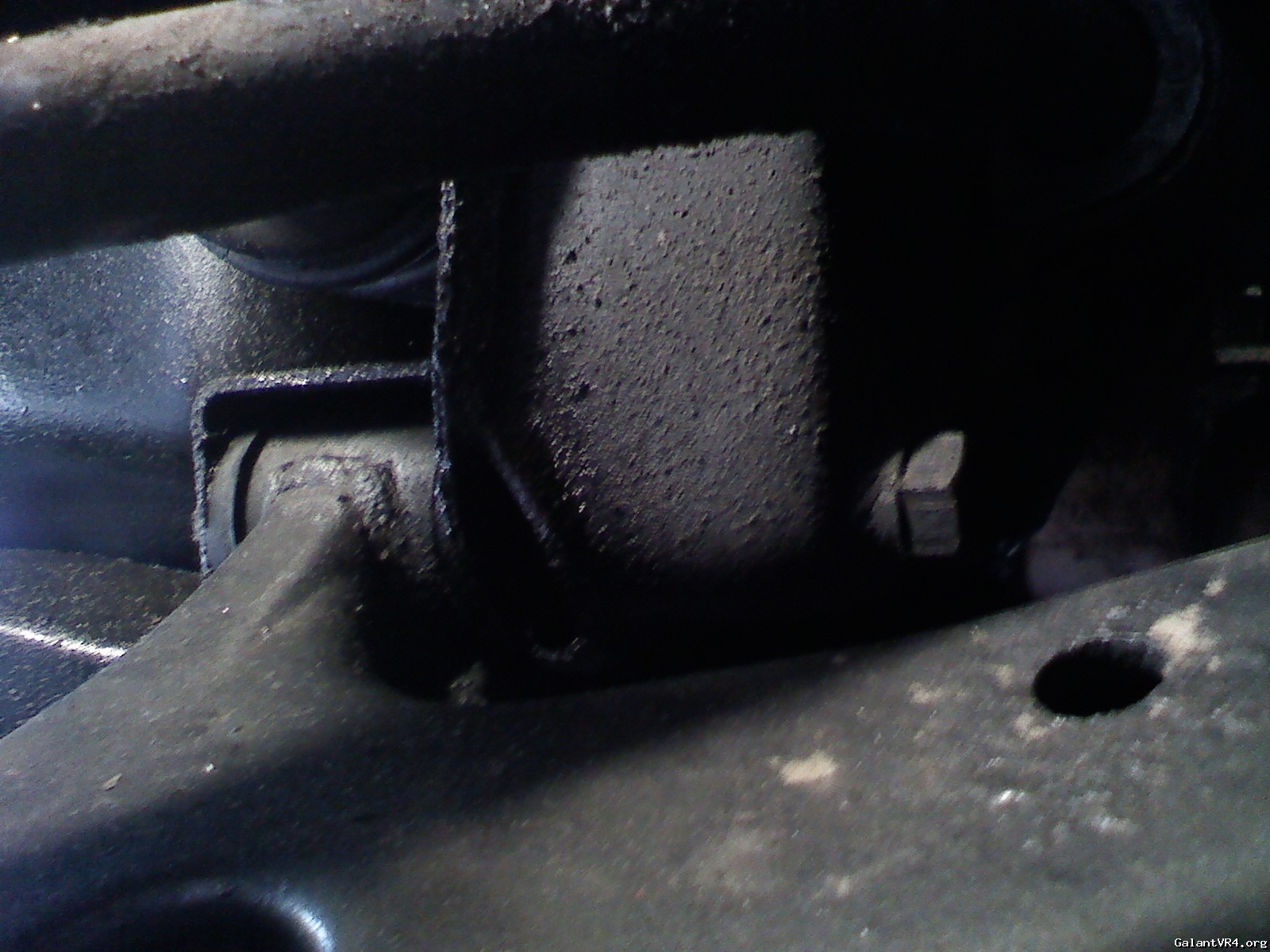

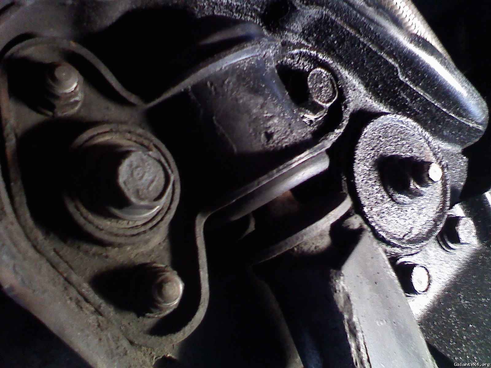

Here is a better pic of everything that holds the control arm on

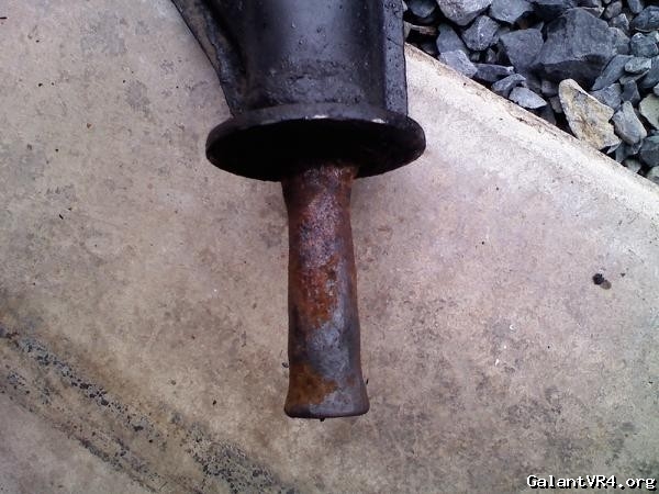

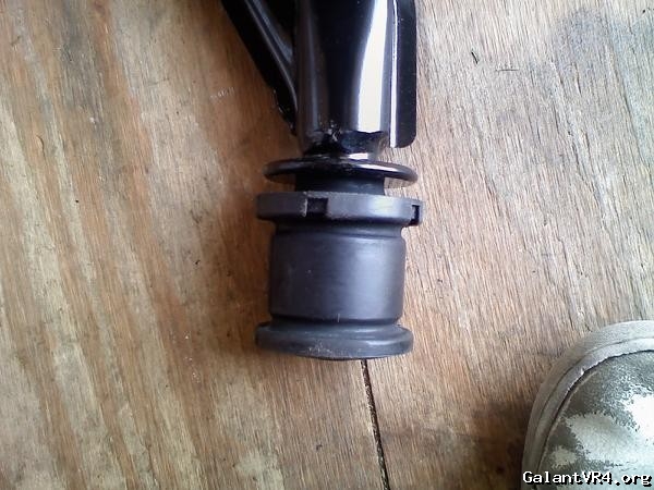

Here is a good example of what u dont want u dont want it to look like. this is one of the old ones that was put on the car for the good ball joint to pass inspection but made all sorts of noise and this is why. The bushing was just sliding around cause the stub is all rusted away
