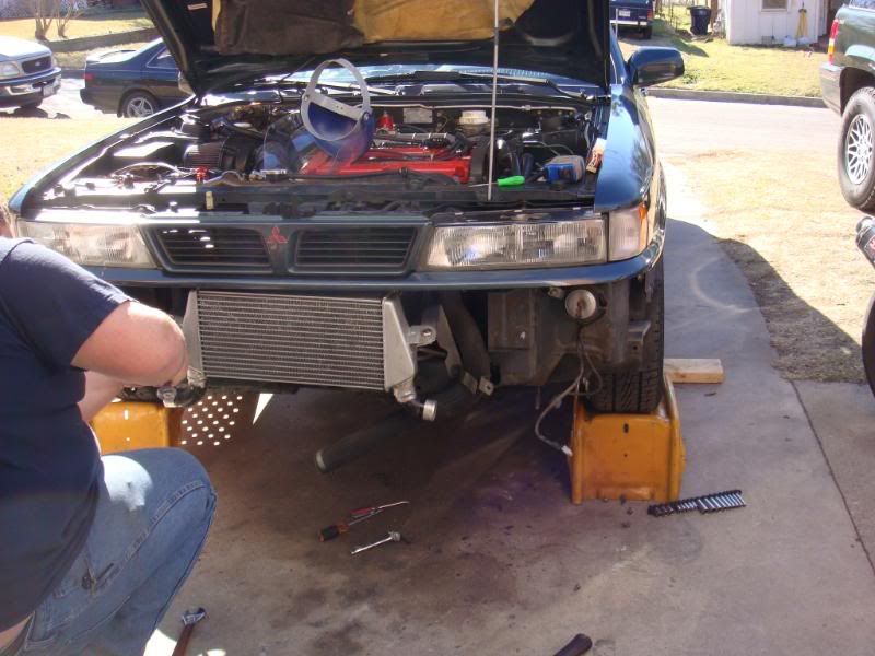

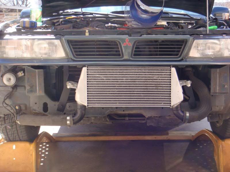

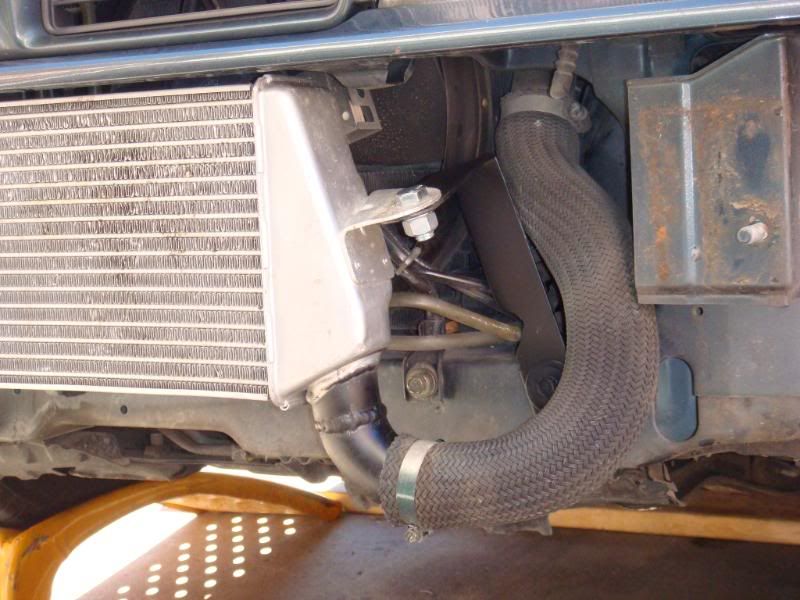

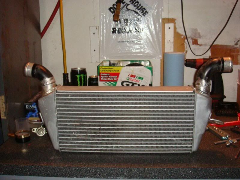

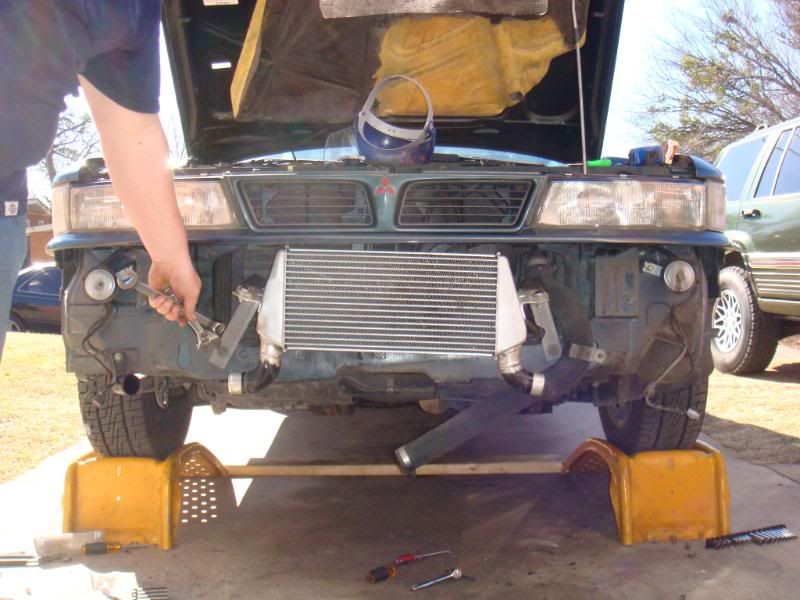

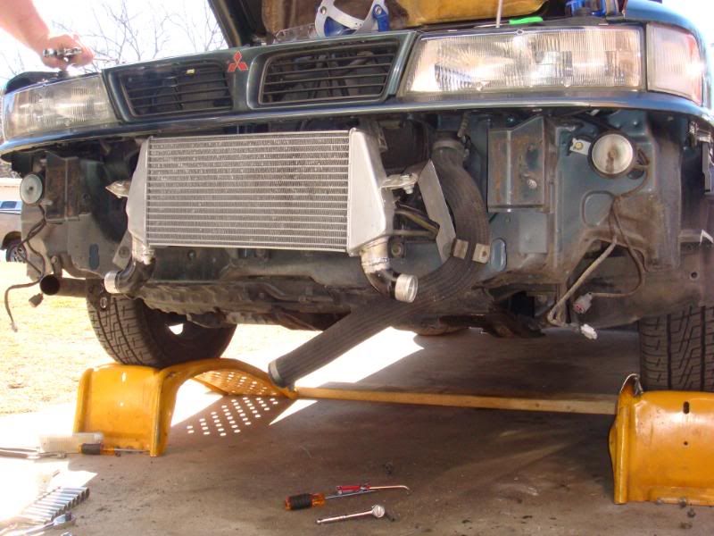

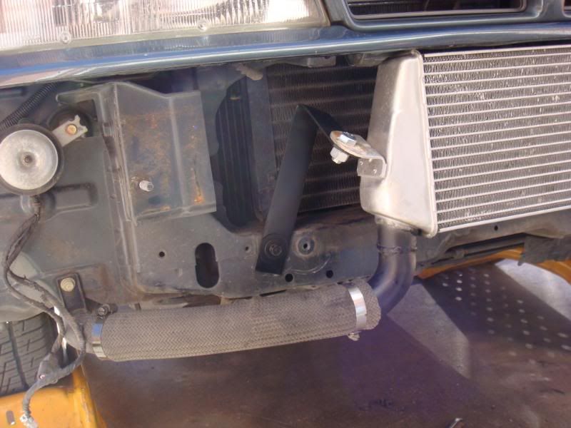

Well I had a buddy give me his stock 89 starquest intercooler so I decided to take the spare stock cooler and make it happen. I had them cut the stock outlets off about 1.5" from the tank on the starquest. then had them cut the inlet and outlet off the stock intercooler to weld in place on the starquest.
I was able to use all the stock piping and just needed to cut the bumper support and make brackets. After all was said and done I had about $100 into the whole thing which was mostly welding ($75). Here are some pics and let me know what you guys think. and yes I did a boost leak test after which came out good. Hope this helps someone looking for a cheap alternative to the JDM unit and the ETS (well worth the $$$) unit.
I still need to tweak it a little to be straight and no thats not me in the pics.

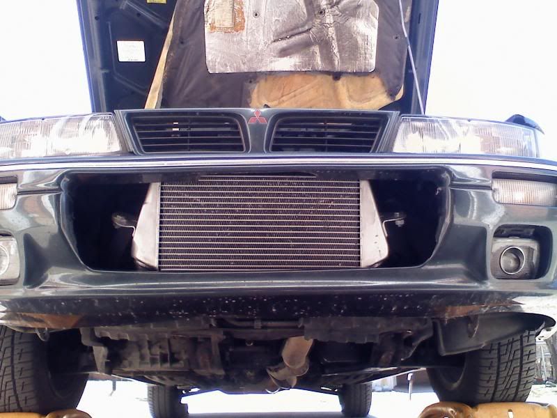

I really didnt have a choice on the bumper cut out. I bought the bumper already cut out. I am sure I can come up with something to make it look better.

On the intercooler you can carry back to your tig guy and have him well a piece of 2 x 2 angle next to the core then You can bend some sheetmetal into a big flat 90 and attach to the angle and then use some little tabs or something on the bumper cover this will also help on cooling.....

If you or anyone else does it make sure its not a long angle from the sides to the IC but squared off directing straight in. Angles hurt for airflow.

I also used this intercooler on my first Galant. When I had the pipes cut and rewelded I also had a bracket added bottom and top to span the old intercooler holds and to bolt into the hood support above. This was very stable and located the cooler pretty well. Also using the long metal low pressure pipe that came with it let me use the stock soft plumbing.
Pic of intercooler
I autocrossed this car on 17lbs boost/14b and could only run about 30 seconds before heat saturation was pulling down timing. But for DD this was plenty.

Yeah that IC unfortunately isn't a big step up from the stock interwarmer. Nice job on the install though. I know, I read, this is just a temp upgrade til you get the ETS. /ubbthreads/images/graemlins/smile.gif
