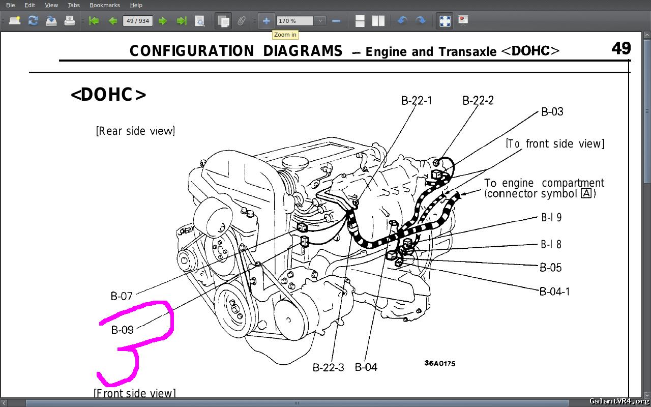

I dunno what you're talking about mate. You are gonna scare the newbies off with that kinda language.
