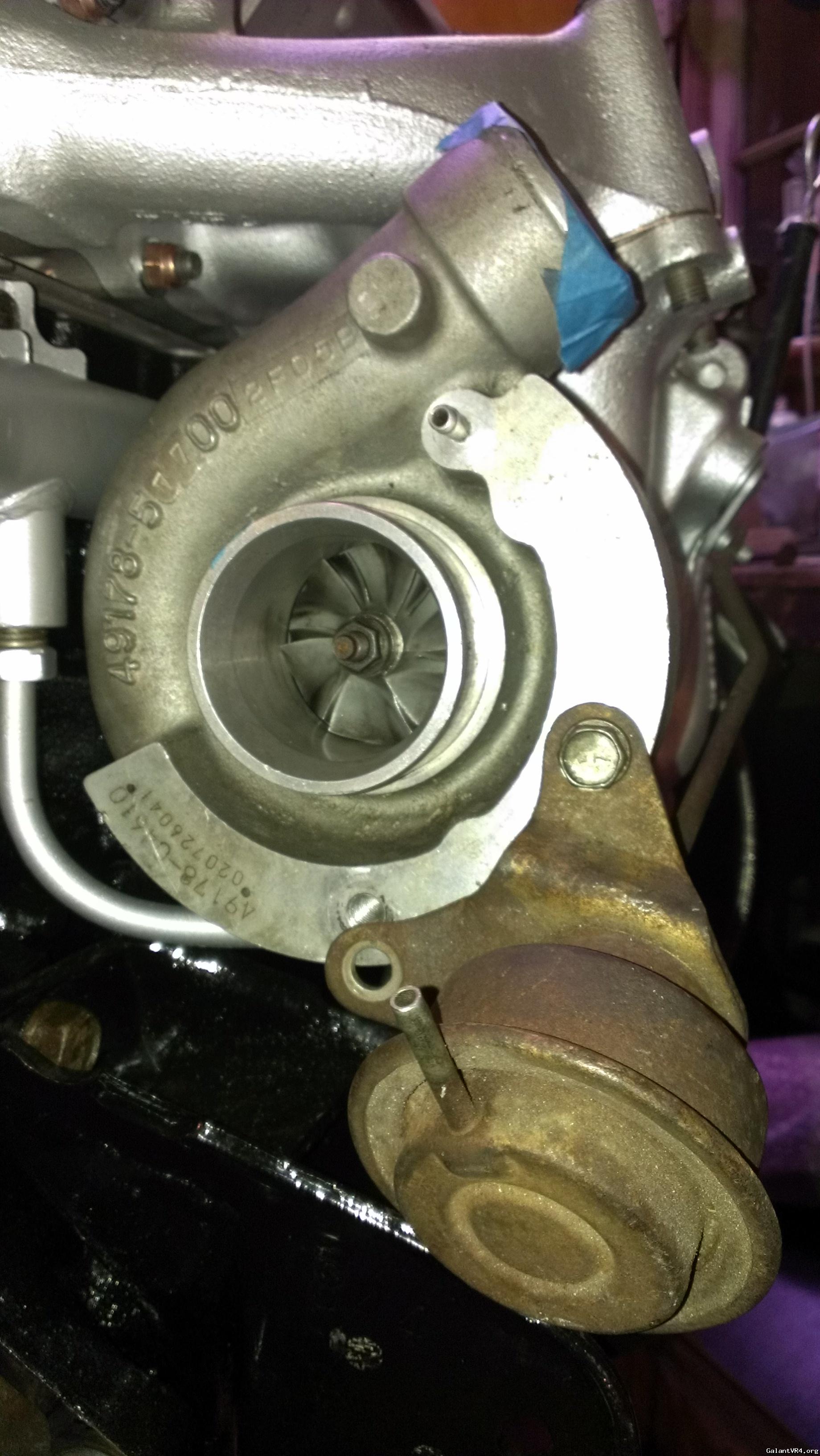

I have a small 16g a Hahn cover and two e316g covers. Not an ideal situation, however I'm having trouble locating the correct MHI style cover.(49178-01520 or 49178-05200)
The turbo is one of the last things I need to install before I drop the engine in the bay.
With this (Hahn) cover my ets ic piping and the wg actuator don't line up.
What would you do?

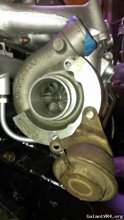

That picture shows the best alignment possible.
I'm getting a 14b machined to fit. Turbo lab on tuners came in at less than half the price of the first guy I asked.
The right piece is the best solution. I just didn't want to spend another $100 on such a small turbo. He said $35.
prove_it
Jul 3, 2008
4,201
Sioux Falls, SD
Yes, as long as the length is corrected. Bending the rod will make it shorter. OEM wastegates are bent......
