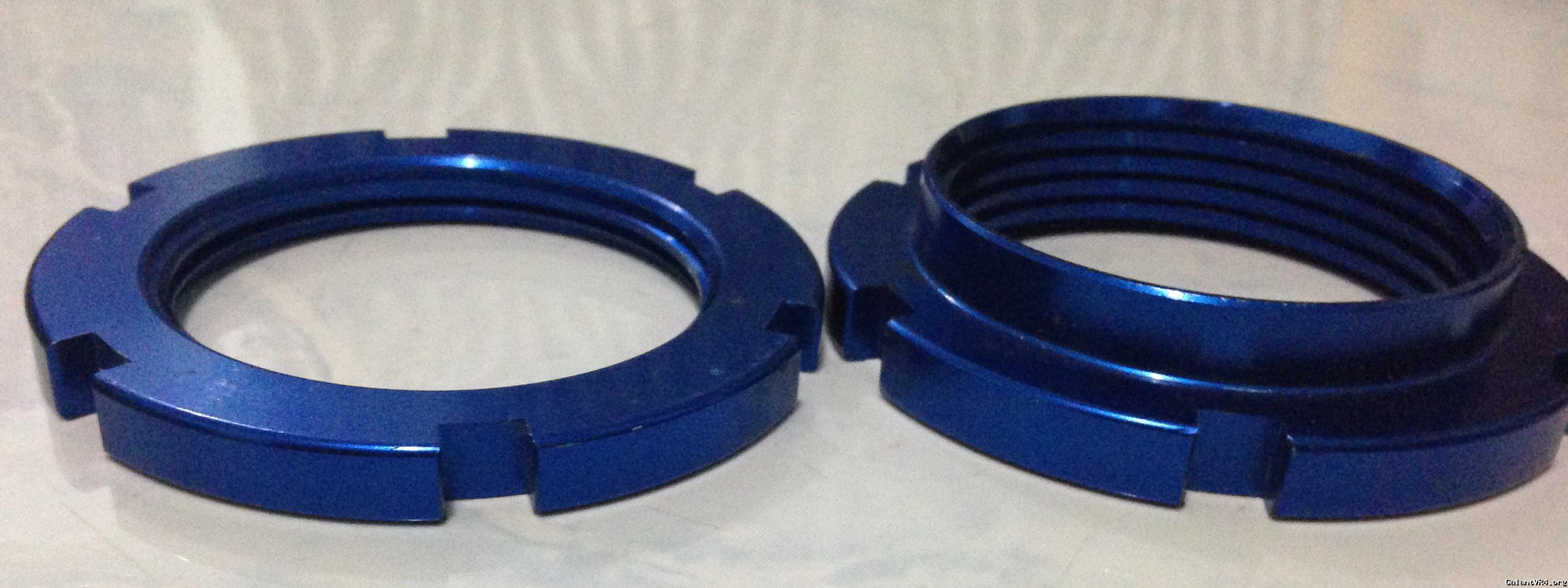

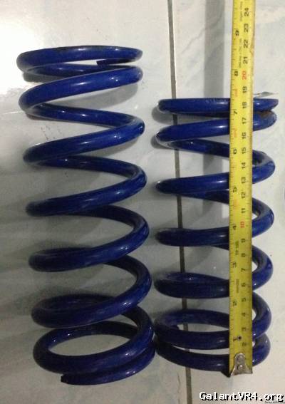

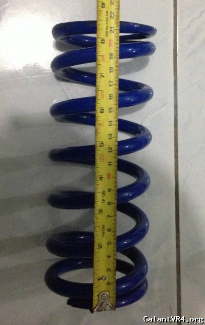

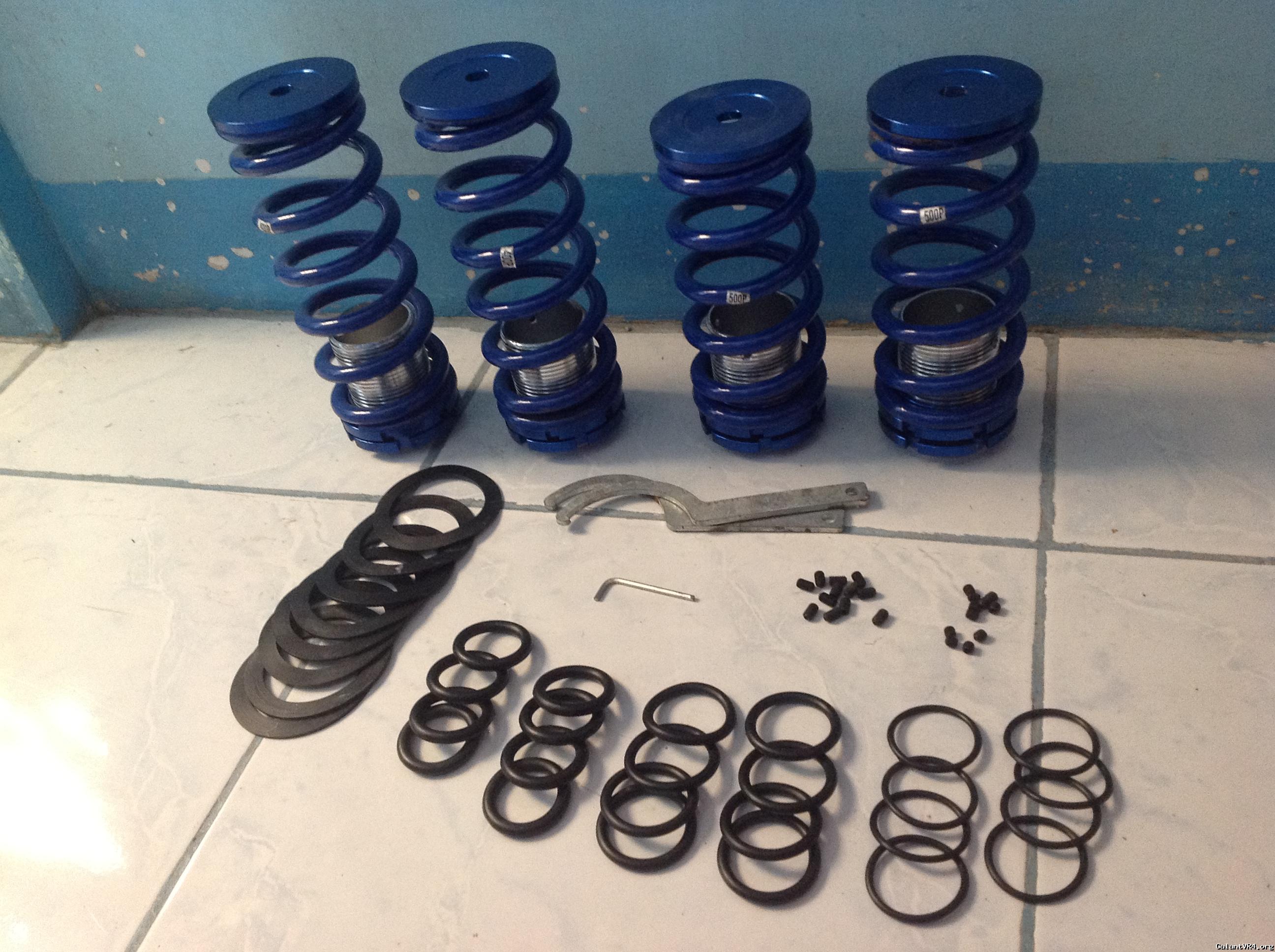

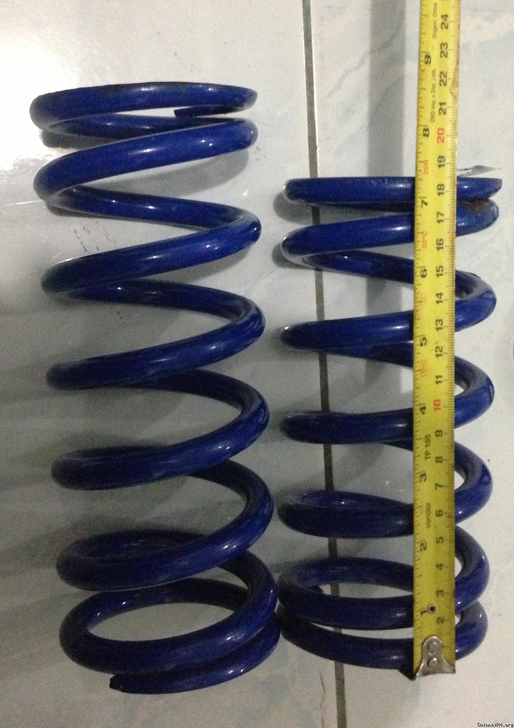

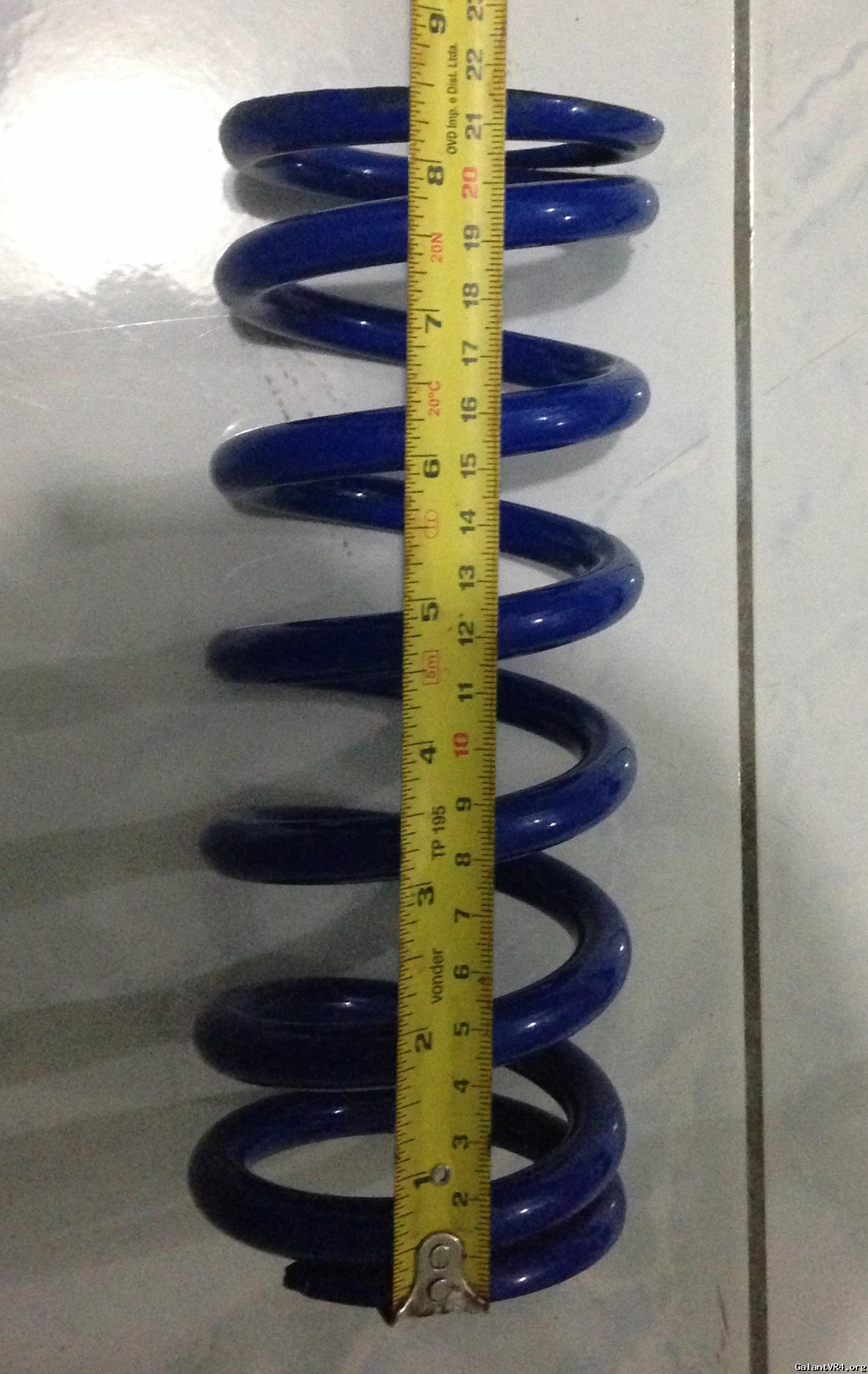

Hello, I am in need of guidance coilover sleeves.
My friend gave me a set. He mentioned that it didn't fit his car and that he doen't know which it is for. /ubbthreads/images/graemlins/dunno.gif
it does not have any brand markings too.
Only thing there says 400p on 2 springs and 500p for the other 2.
I'll post pics later for the set.
Here's what I have
Can anyone point me to a guide for installation to follow please?

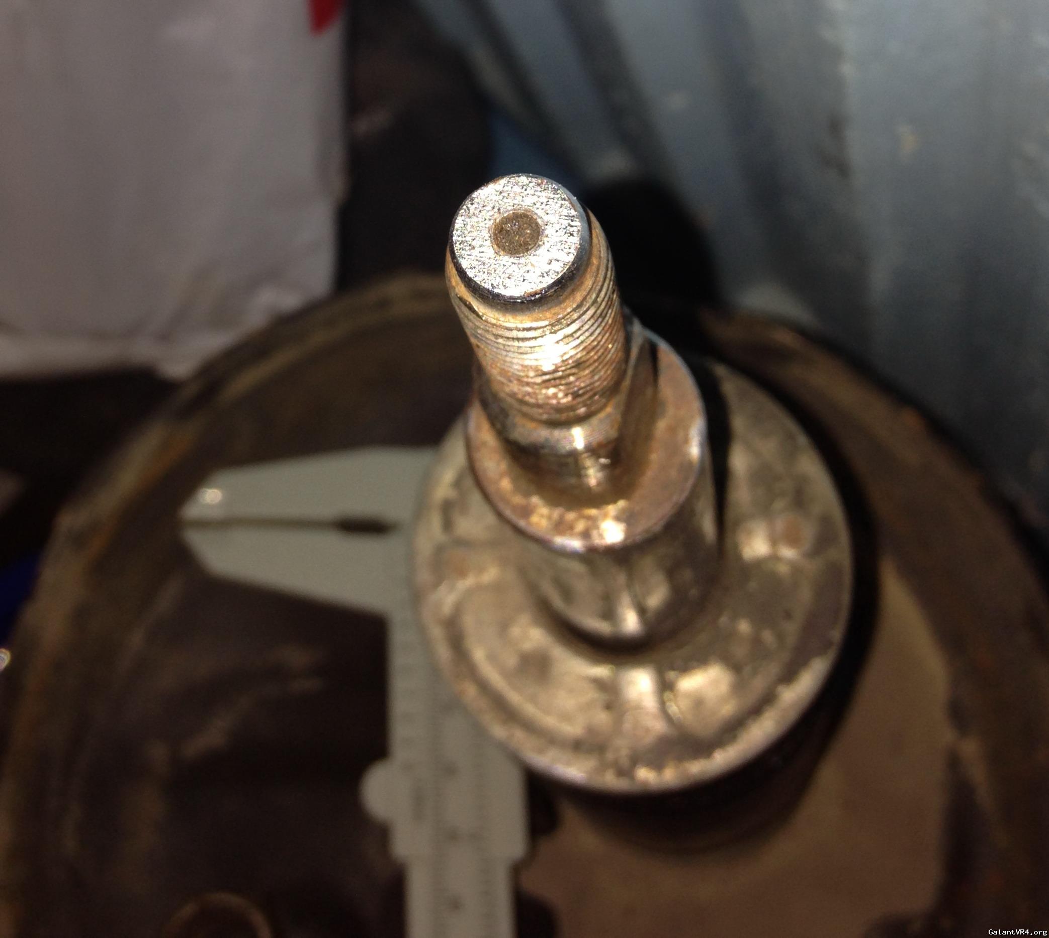

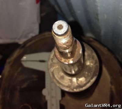

I have test fitted on the busted struts I have and the only issue I have is the top hat. it does not go on top of the strut as it should. the top of the strut has a D shaped strut and the top hat has a circle shape . Can I just have it drilled or machined? or should i just need to buy these for the galant specifically? if so, where can i get just the top hats? and do I need specifics of the diameter of the springs?
Thanks in advance. /ubbthreads/images/graemlins/grin.gif

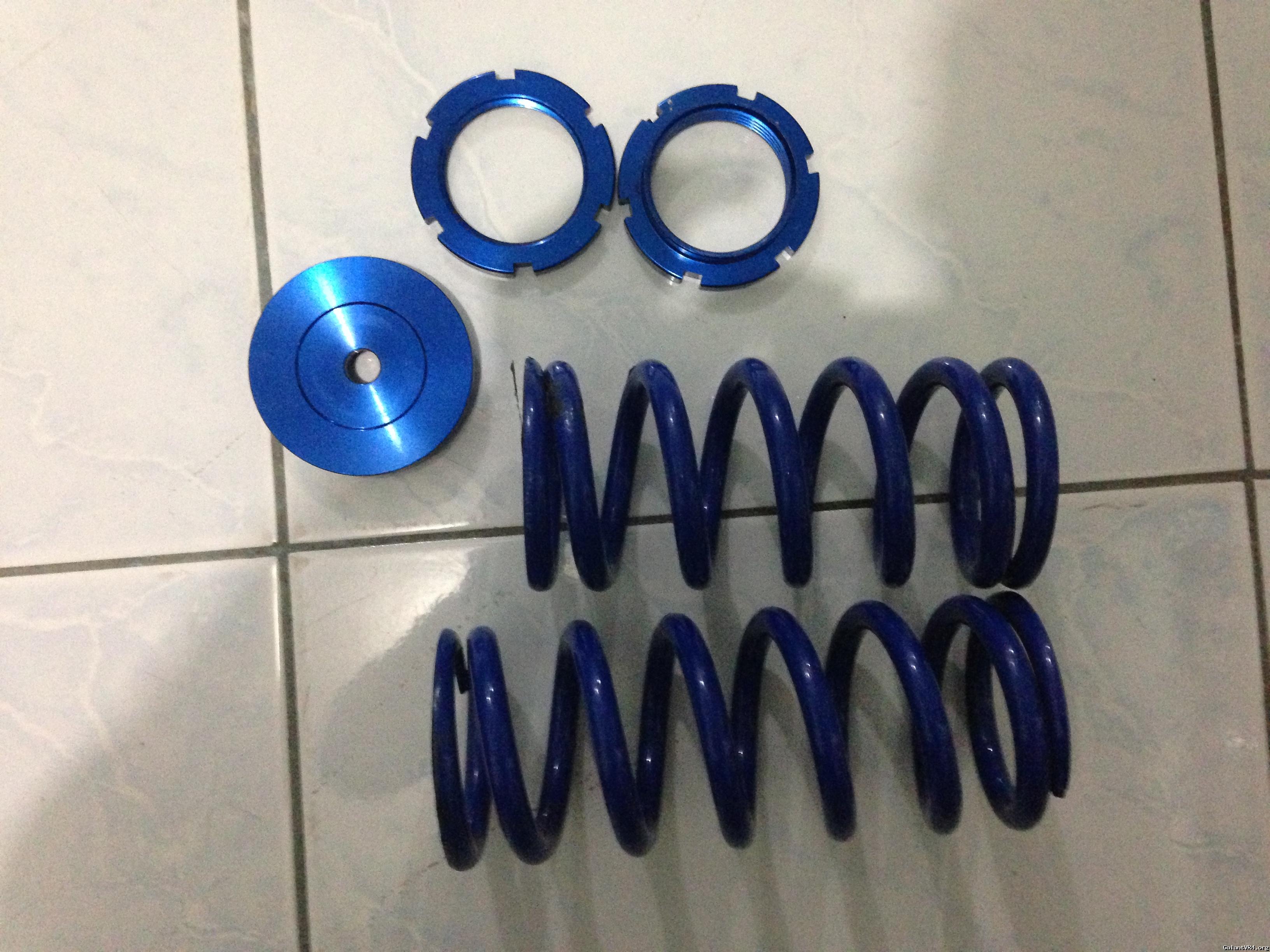

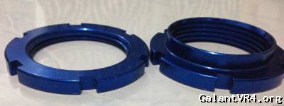

You are missing parts if that is all you have. You need the threaded sleeves for adjustment at a minimum. The top has often has a spacer that fits the top of the strut.

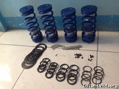

Sorry, here's what I have.
The top hats doesn't go through the top of the strut. the hole is kinda small.
you guys think i can have it drilled for a larger hole or just get new top hats for my stock struts?
any recommendations for sites where I can buy them? thanks!

I would stay away from cheap ebay coils like those. They are usually very soft and will cause you to bottom out and have a terrible ride. But if you don't really care about ride quality just enlarge the top hat holes and it should fit.
