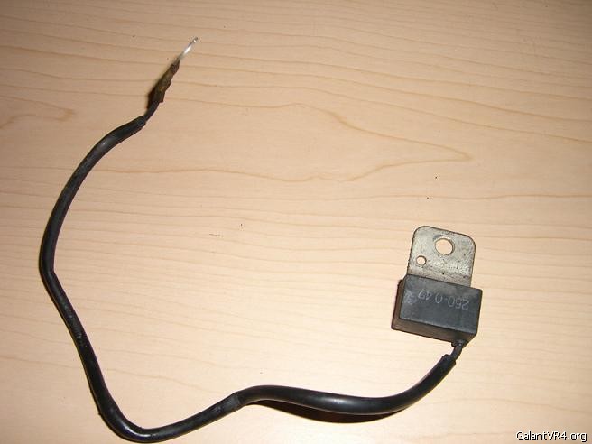

I wanted to add to this for some that might come down the road a bit later as well as ask a question.
Curtis,
I see that in your drawing it shows the wire colors of white and green. My problem if that I didn't get the connectors with wires when I got my coils, so is the green wire the wire on top or on the bottom of the coil harness? I looked at your pictures and it appears that the green wire goes on top and the white goes on bottom.
If that is correct what effects would having the wires opposite of that have on the car?
Also you said to wire in the "little black box" into the junction of the black wire and the 1 & 3 coil. Is this the box you are talking about?
I am having some misfire issues and I am assuming it is becaue I forgot to wire in the black box, however it appears I swapped the wires on my coils as well. Hopefully the answer here will clear up any confusion thatmay arise for others.
