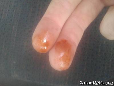

Today I took a look as best I could in the parking lot at work. Clutch fork has no play and seems to be functioning properly. The pedal assembly on the car has already been fixed, thank god, that looked like a pain in the ass to do. Looking for fluid inside under the pedals I found that although there wasn't a massive amount of fluid, there was fluid where the master cylinder hooks to the pedal assembly, not much but it was there which tells me to start with replacing the master cylinder (and the slave while I'm at it as I don't know the age of either) before I pull the transmission. Am I right in thinking this?
