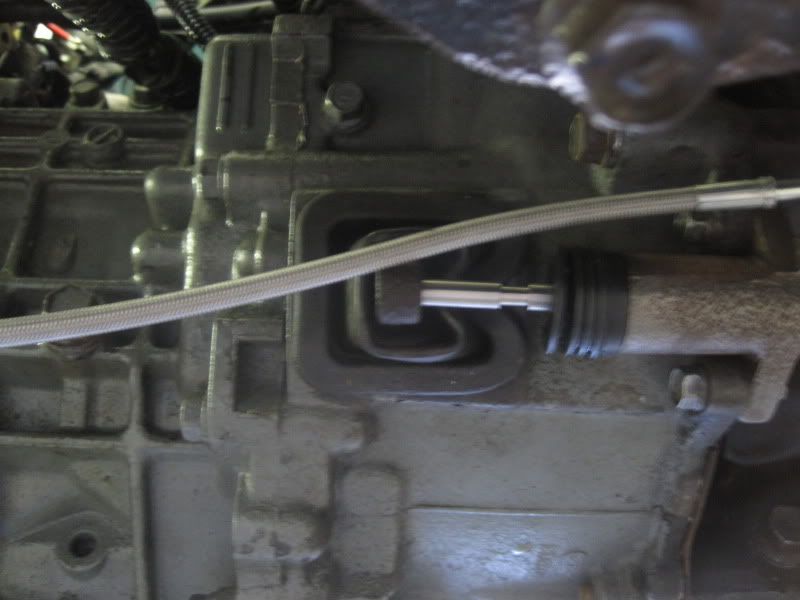

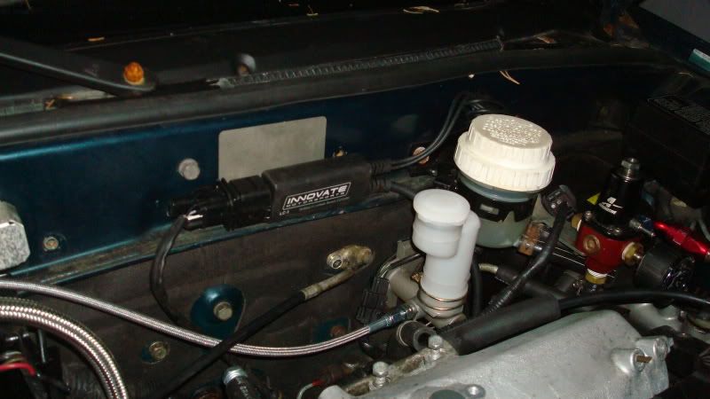

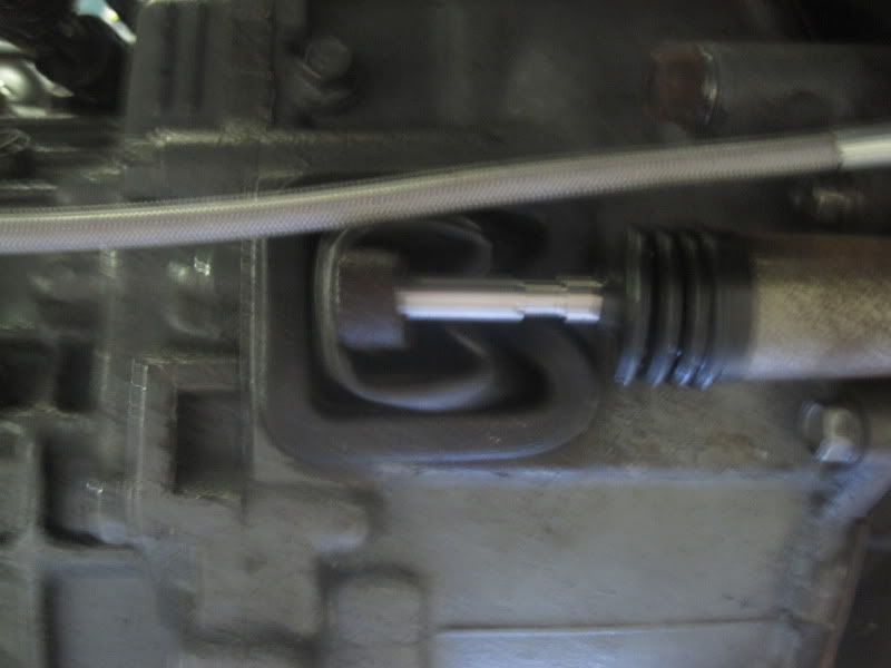

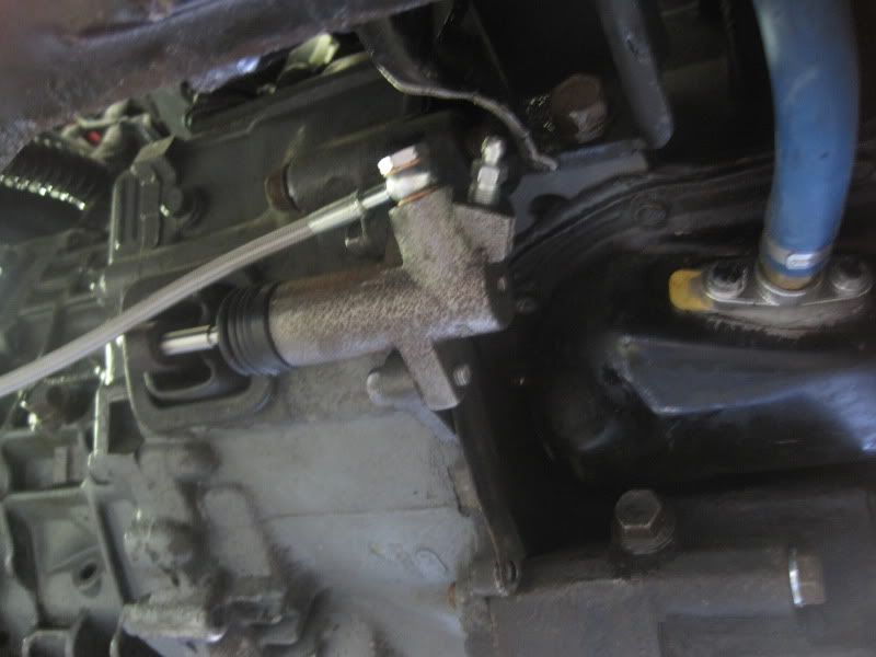

Here are some pics of setup, clutch out, clutch in.

Make sure the replenishing valve isn't blocked. Push in on the slave to check. If it goes in your fine. I would say it sounds like a faulty master or air. What brand master cylinder did you get? It doesn't look OEM. You want a 5/8 size Nabco Made in Japan for best luck. I've gotten them from the stealership and NAPA. NAPA being the cheaper/better place to get.

I have pushed the rod back in, no issues.
I feel the line isnt getting pressure. I feel its a bad master too. I will try to bleed once more for the hell of it.
Oh and BTW: its a Wagner master. 5/8" bore. Standard aftermarket company. Wagner slave too
