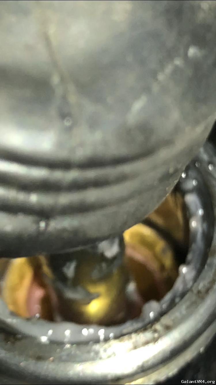

Ok so the slave cylinder has fluid all up in the inside under the rubber boot.
Really hoping that’s my problem.
Gonna order an extended slave rod with new OEm slave from extreme psi just in case.
After installing my new slave do I need to readjust the master cylinder rod?
Also how would I go about flushing the system?
Just open a bleeder and keep closing it while pumping in new fluid?

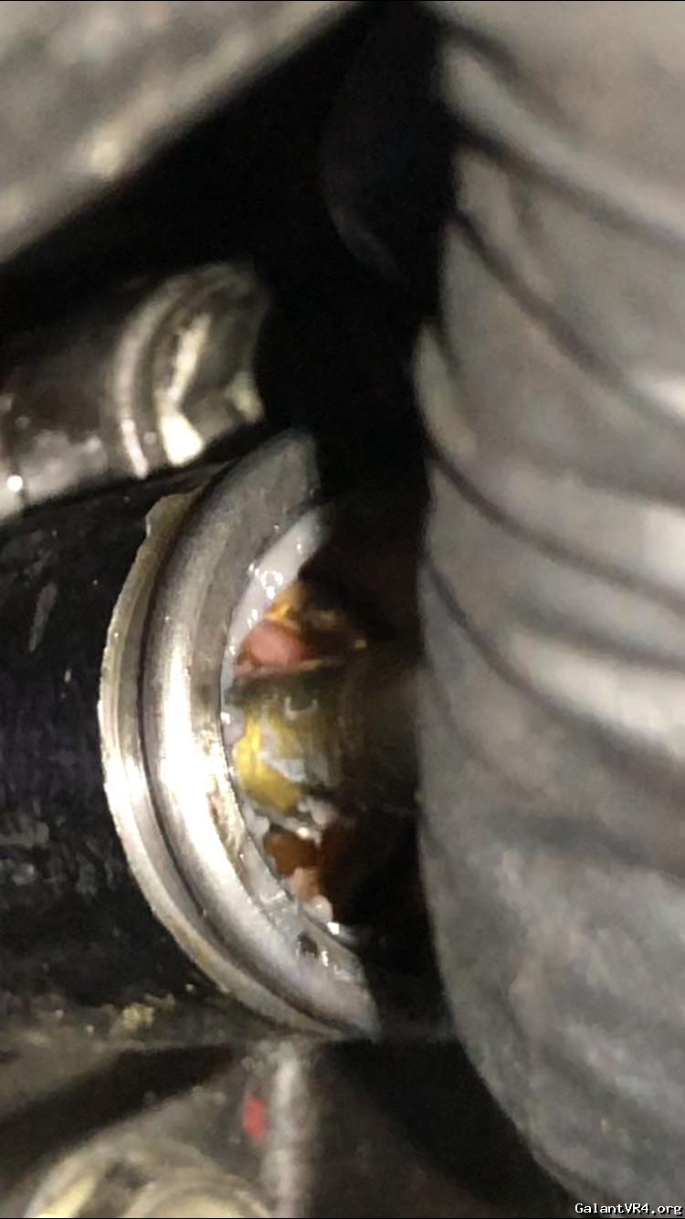

Damn, so installed the new slave cylinder and SS clutch line, bled the shite out of it, depressed slave while foot was down, bleeder open, all that jazz.
Really hoping jacks transmission sent me a green rod slave, I’ll pull back boot tomorrow and check.
As of now clutch still dragging, not as much but enough to move the car at 6k.
But if I do infact have the pink slave ( that’s what I ordered)
So how about that extended slave cylinder rod? Should I try to pop that in?
I would need to adjust the clutch pedal after doing so correct, the master cylinder rod? Or I will overthrow the system?
I read the way to tell if your over throwing it is if your clutch grabs at the top instead of near the middle or near the floor

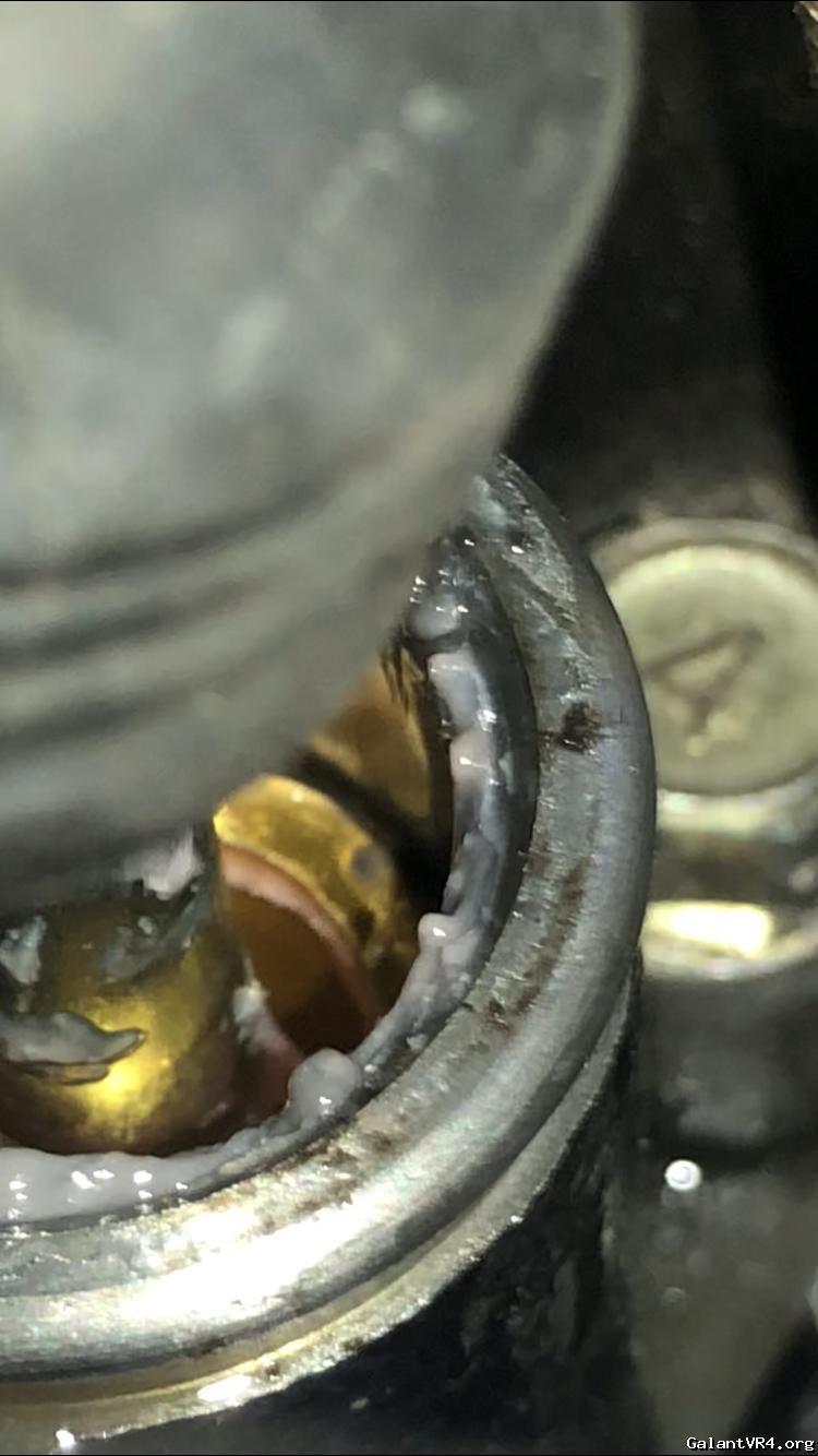

Just checked today and it looks pink, quite hard to see with all that grease in there.
What’s the chances of this brand new OEm slave being faulty, kinda looked wet on the inside of the piston. Could of just been mad grease

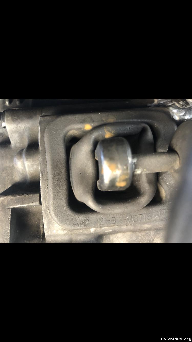

Here’s a pic before I changed the slave cylinder, I’d imagine it’s in the same place now.
Ya really bummed.
Is there a way to test what your asking? Like pump the pedal 5-10 times then hold down and check if drags?
Using a brand new OEm master cylinder btw.
The rod is adjusted fully all the way out and I can still push slave in by hand, would using a longer master cylinder rod adjusted out until I can’t push slave in work?
Or is that the same idea as the extended slave rod.
467
Mar 16, 2001
922
Royal Oaks, Ca 45 min S of San Jose
OK, a few things.
One, it looks like your fork may be starting out slightly too far to the left of center of the opening in the picture, it's close. It is hard to see from the picture, but I am going off the centerline of the flange around the opening and not the boot as the boot may not be centered in the opening. Check to make sure your clutch pedal can be pressed all the way to the floor without it appearing to stick on something before it hits the floor. See click @ 8:50 and click for more explanation.
Two, you can simply depress the clutch pedal to the floor for a long time with the engine running and emergency brake on to see if the clutch starts to drag with increasing time if there is a problem with the clutch master.
Three, I told you the wrong way to adjust the master clevis rod for maximum throw. Sorry, I wasn't aware of the self adjusting feature. See Jack's transmission video click for explanation of master clevis rod adjustment procedure.
Four, I also forgot there is a stop adjustment at the top of the clutch arm that you may be able to adjust to give you some more pedal throw. See Jack's transmission video click @5:40 for explanation.
Five, you shouldn't need an extended master clevis rod for adjustment. I would look for something else that is the problem like excessive wear in the clutch linkages under the dash, worn elongated holes in the pivots all take away from clutch travel. I've seen bunched up carpet under the clutch pedal restrict travel, but that is extreme because clutch disengagement shouldn't occur that close to the floor.
Edit: I would check they gave you the correct master while I was at it. You never know.

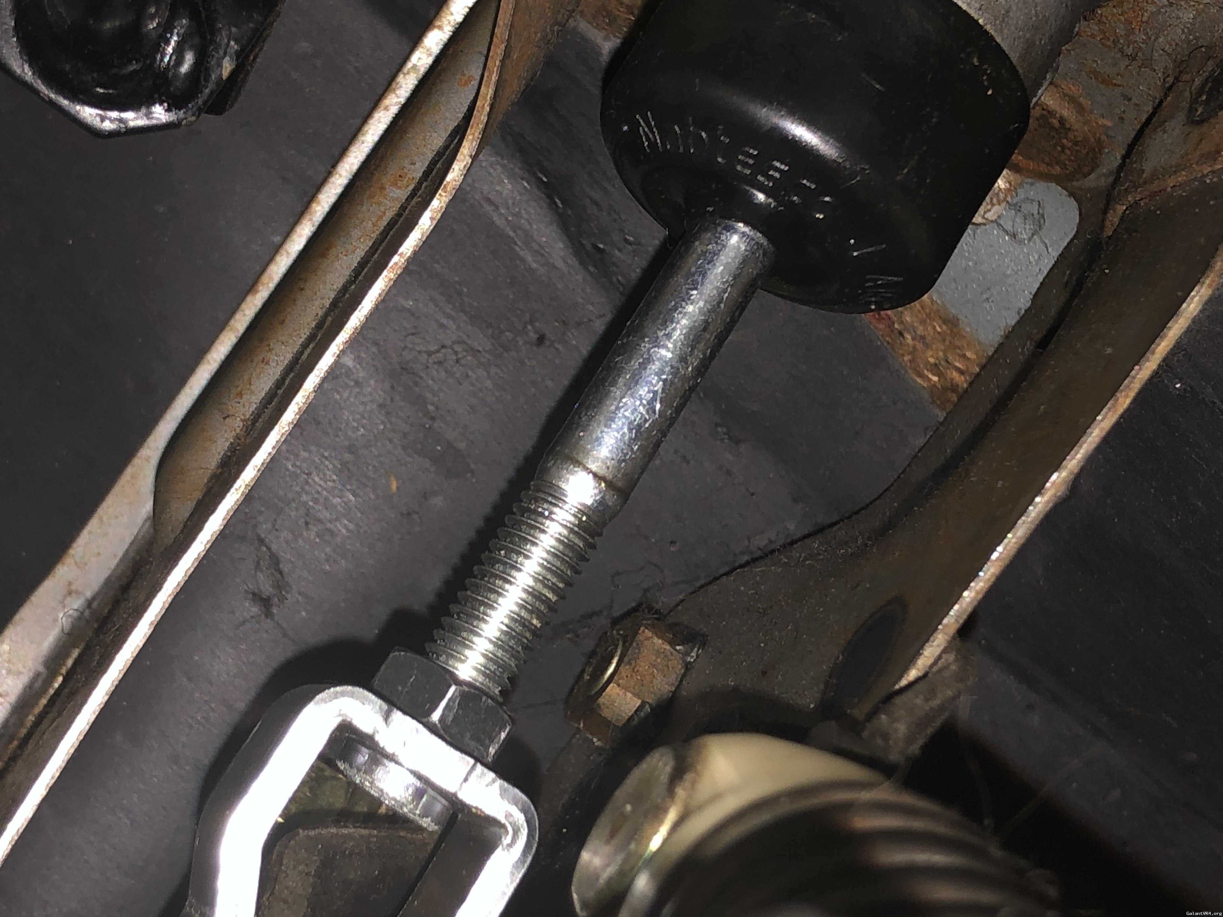

yeti
Oct 13, 2010
803
san diego california
Ok so pedal height is adjusted to the Max that still pushes switch,
I’ve adjusted the rod all the way to the last threads and I can still push the slave in by hand, that’s the weird thing, in jacks video you get to a point where you close off the valve in the slave and can no longer push it in by hand.
I can’t get to that point in my master as I run out of thread.
Nothing that I can see looks worn in the linkage but I don’t really know what I’m looking for to be honest. I’ve followed the links but the test say my pedal is good.
I’ll try the test your mentioning tomorrow, I drove up my driveway ( extremely steep ) and it didn’t want to come out of 1st after getting to the top, I pushed down on the pedal as hard as I could but didn’t change anything. I just applied slight pressure and it popped out ( as I’m typing this I’m sure that’s a bad thing to do and won’t be doing it anymore, I could of alternatively turned off the car.)
Is that essentially the same test, foot down for while and the car is locked in gear now? How would I go about testing the master cylinder? It’s brand new oem.

I checked the slave as I put it in for proper casting marks.

Ok so my slave cylinder piston is yellow not pink or green. I ordered OEm from extreme psi?
Wtf
From using the extended slave rod, I caused my clutch to start slipping under heavy decel the other day.
So I swapped the original back in, not I literally can’t get it into gear unless I fight the sh*t out of it.
Trans is leaking as well, it may have emptied itself gonna check that now
